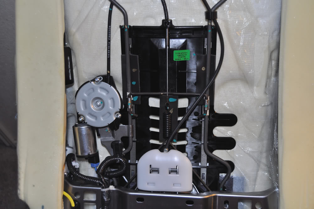

There is not much that can actually go wrong with the powered lumbar support. A little troubleshooting first will save you much $$$ later. Here is what could be wrong:
1. Check switch operation by checking power to motor. If power is getting to motor then
2. Check motor. Is motor trying to move the apparatus on the track? If so then
3. Check track and lumbar operation.
It has to be one of these three items. Replacing them yourself will save you later. So, have fun and let me know. If not then spend the $500 and enjoy!
Here is a pic Harper posted awhile back. This should let you know what you are getting into.

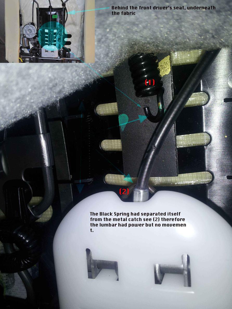

So it turned out that the spring which is attached at the bottom of the cable had somehow come off! A simple fix after all. See image for further clarification: :boink::reddance:
Dealer 0, MeBe4running 1
Thanks for all your help guys!
Have a great Monday!
