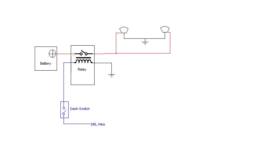

Friday after work, I dashed home to install my new Vision-X driving lights in my bumper... only for it to rain (for about the 3rd time this year, it is CO!). So, I waited until it let up a bit, then got to it at about 9pm with my camping headlamp. I was electrocuted once before (knocked off a ladder from a commercial high-voltage line), so puddles+electricity kept me on my toes - no pun intended. Got them in and after a lot of fussing with the mount, trying to get them centered in the opening and properly aligned was no easy task, but well worth the effort. They really finish off the ODL bumper nicely.

I thought I'd also share how I wired my lights... Basically, I used the DRL line to trigger the relay with a dash-mounted switch in line. That way, there's no way I'd forget to turn them off and kill my battery AND I can turn them on/off whenever the truck is on (no need to have the headlights/brights/parking lights on).
EDIT: I forgot to include the fuse that is between the battery and the relay.
