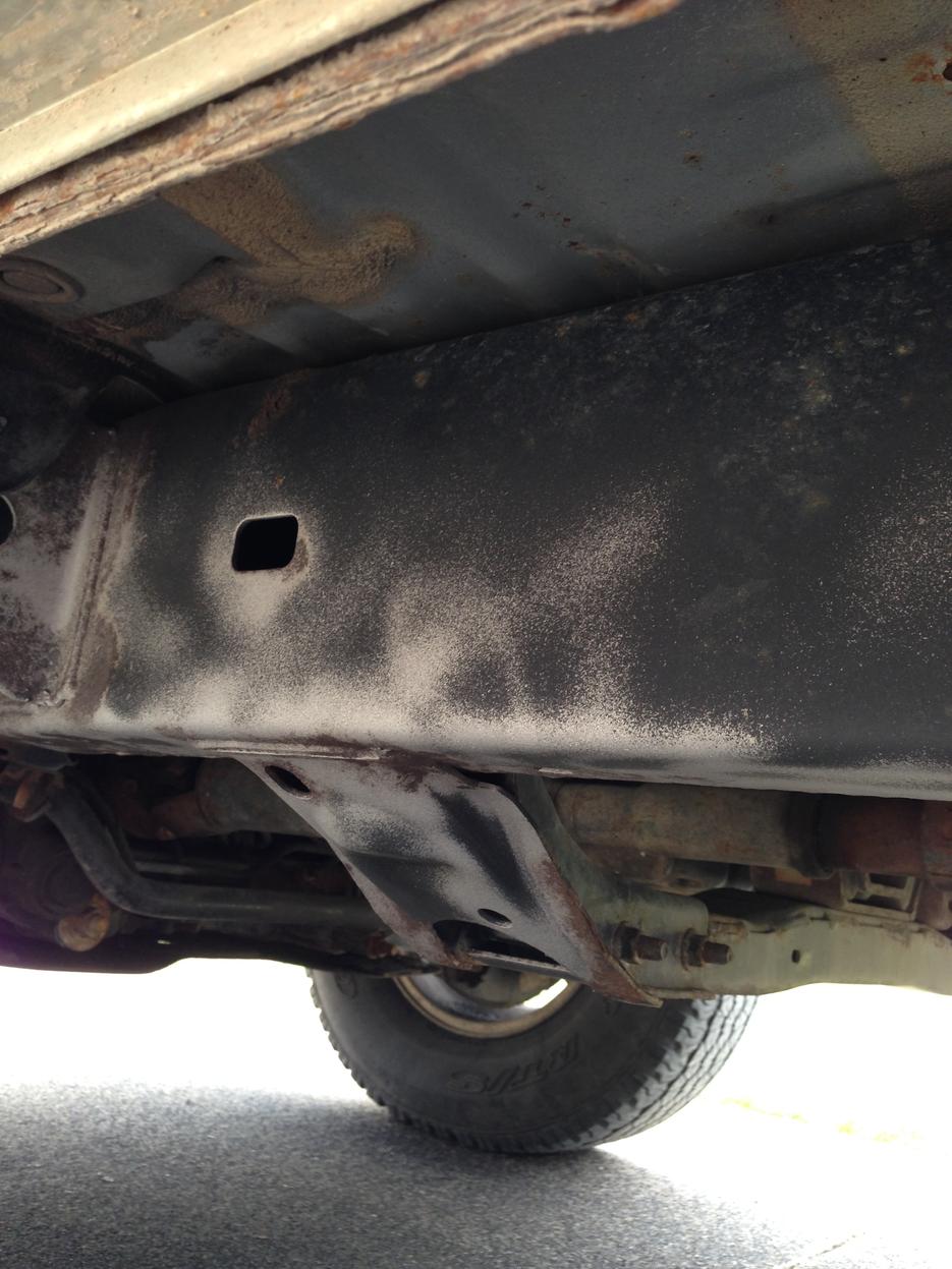

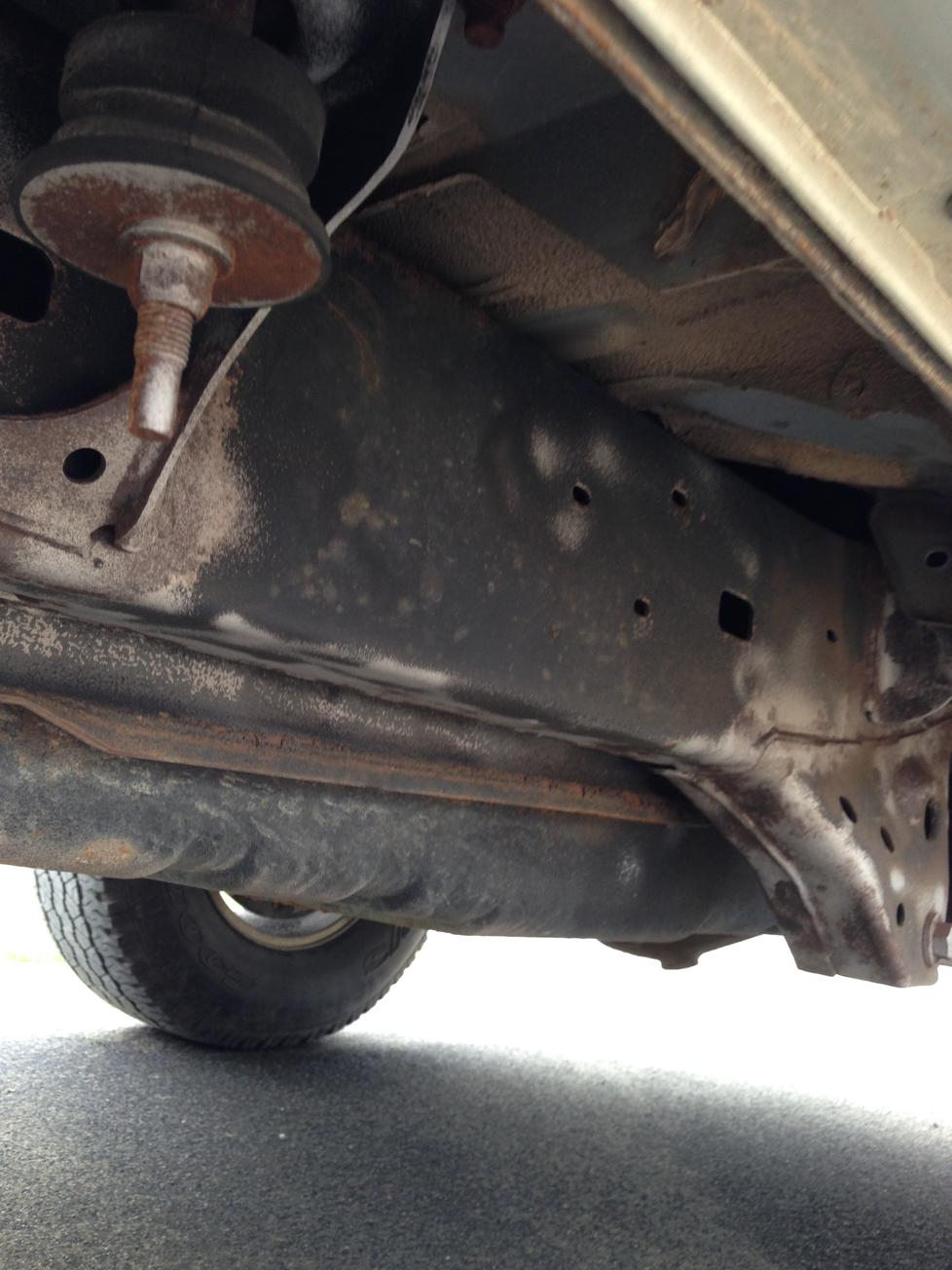

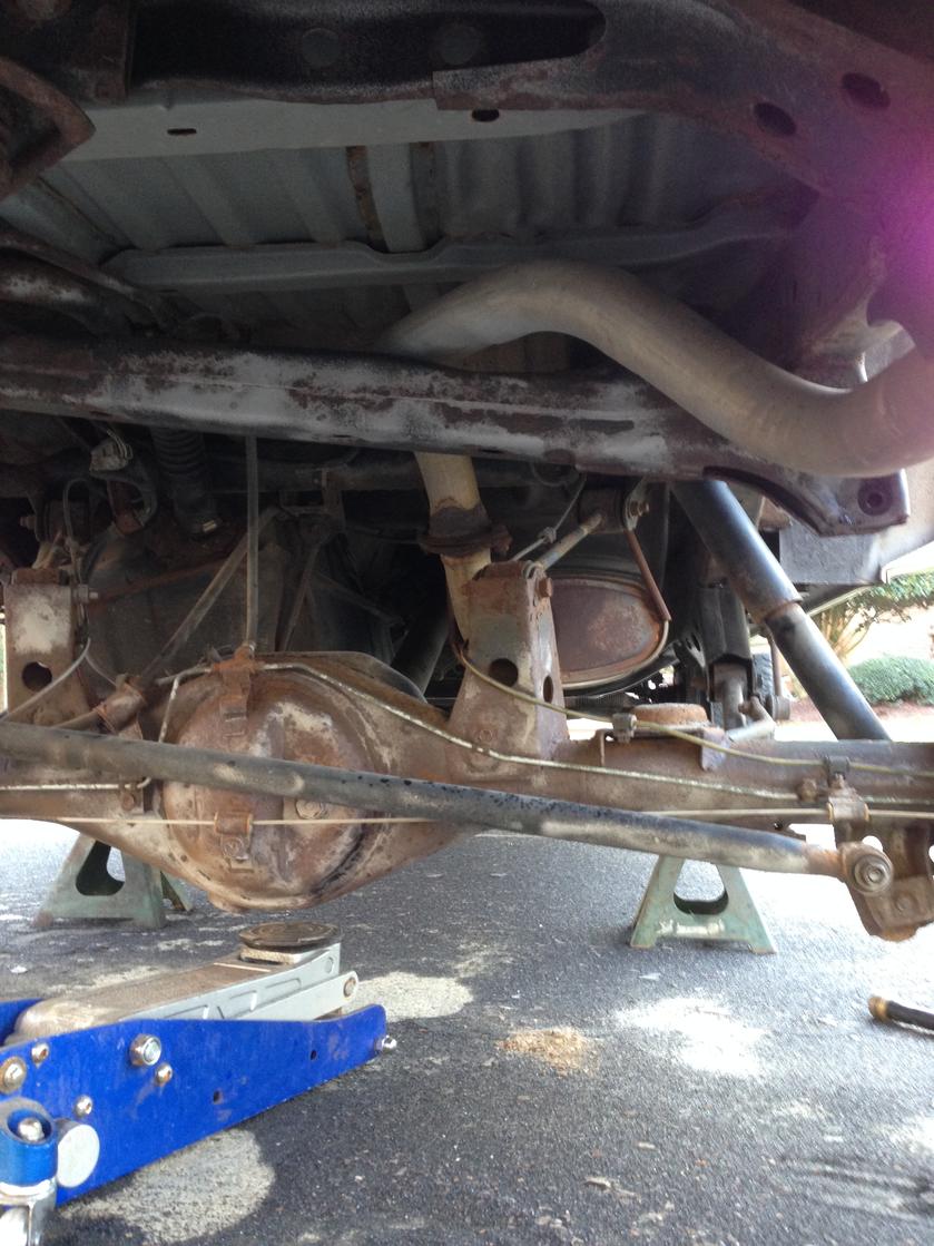

Today I took the running boards off and sand blasted the frame.....Had a few places that started to show some rust.

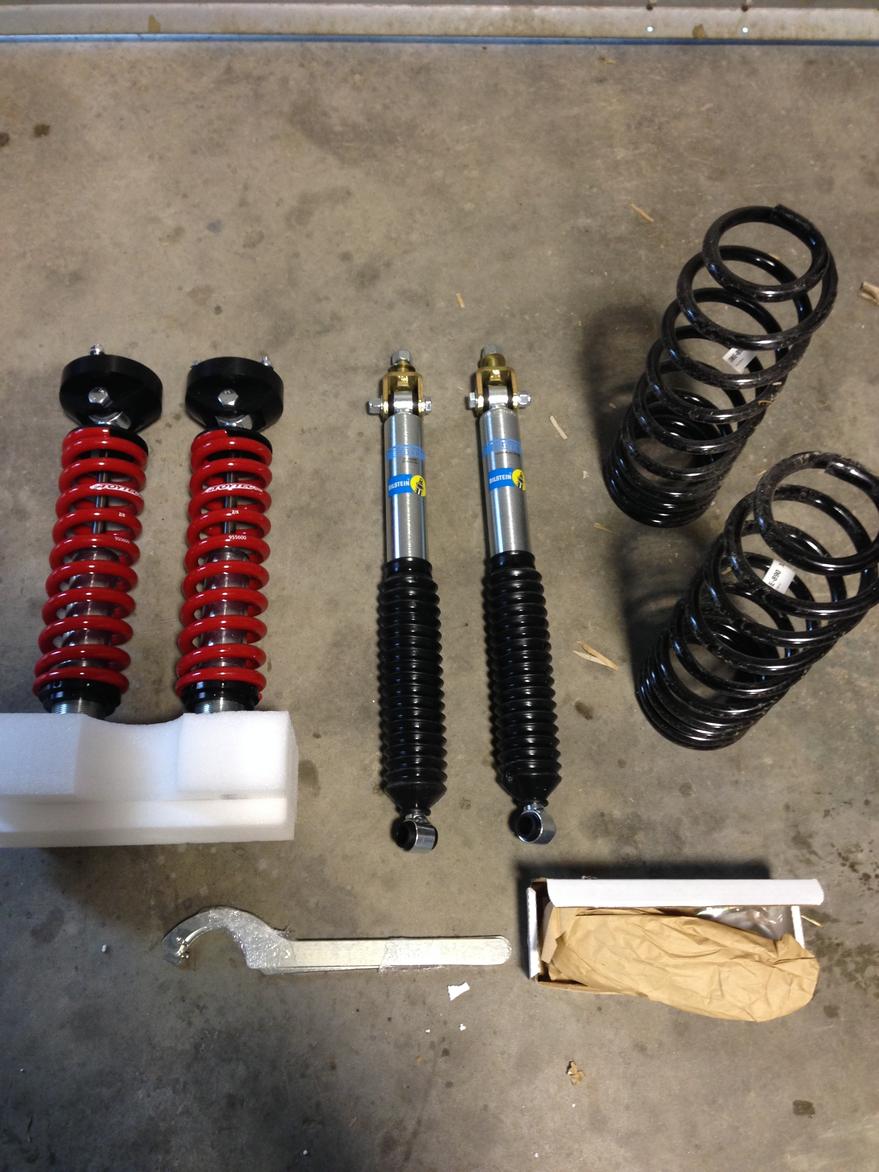

Toytec lift came in today.
It was raining so we could not work this afternoon....came home and started on the passenger side.

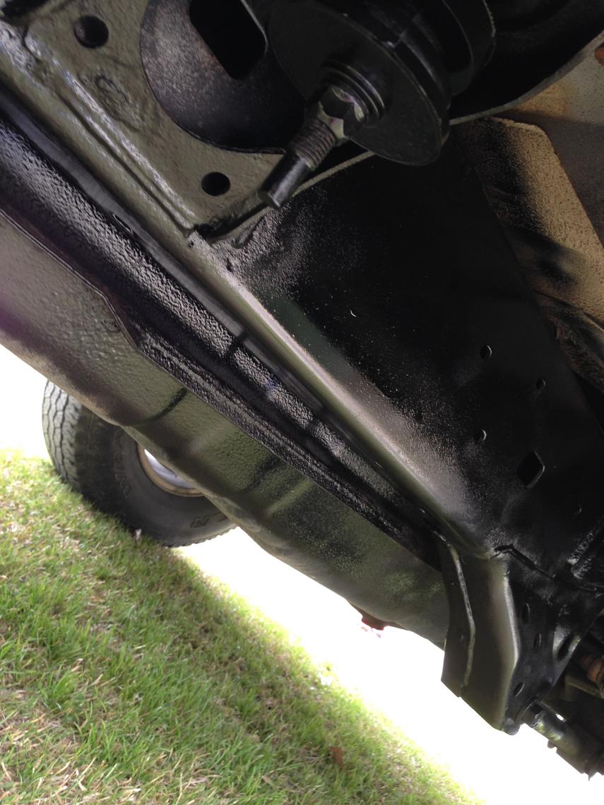

Sandblasted some of the areas and applied the undercoat paint and then started on the lift.

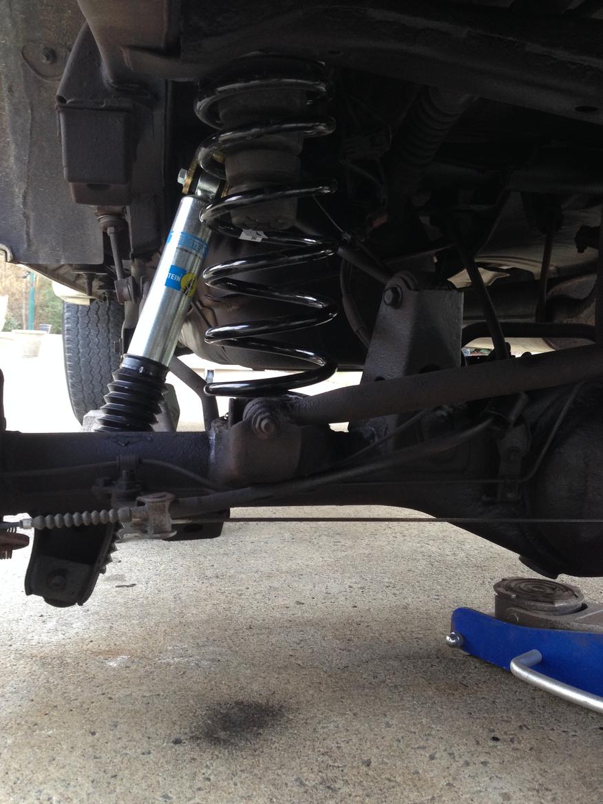

updates

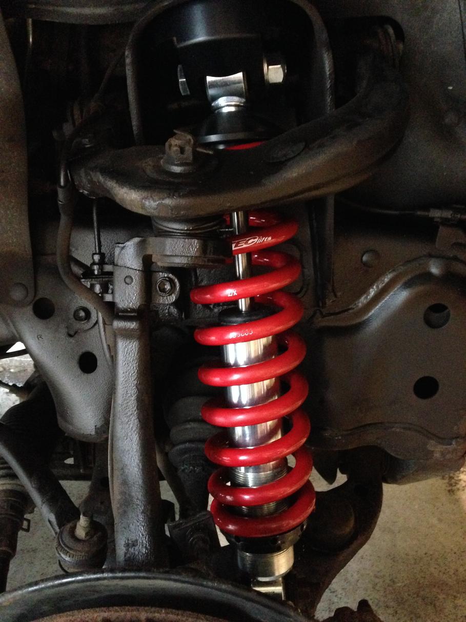

Got the back sandblasted and sprayed.
Installed the 890 Springs and Blistein 5125 shocks on rear.
Hey man, what make/ model of sandblaster did you use to do this? I assume you have a decent compressor to boot.
Wire wheeling/grinding/sanding is too difficult to get into the cracks and corners that you were able to.
Looks great!
Sand blaster
Looks great!
You can buy it at a Tractor Supply or I think Harbor Freight has the same model. I will take a pic tomorrow and post it for you.
It's a 110lb Central Neumatic one.
You will need a two stage compressor to be able to keep it going.

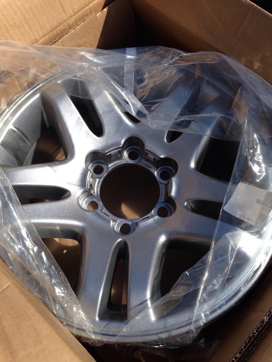

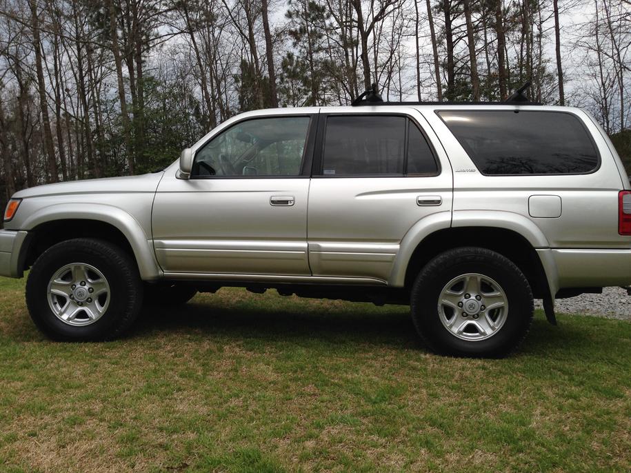

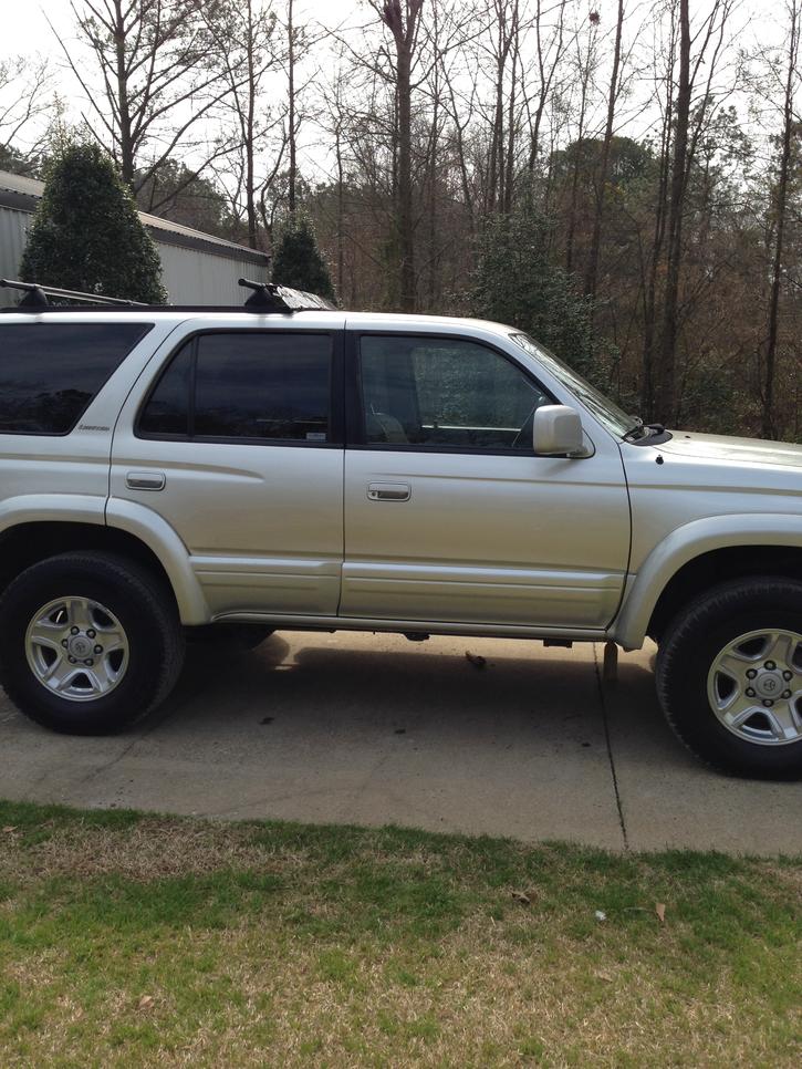

Tires

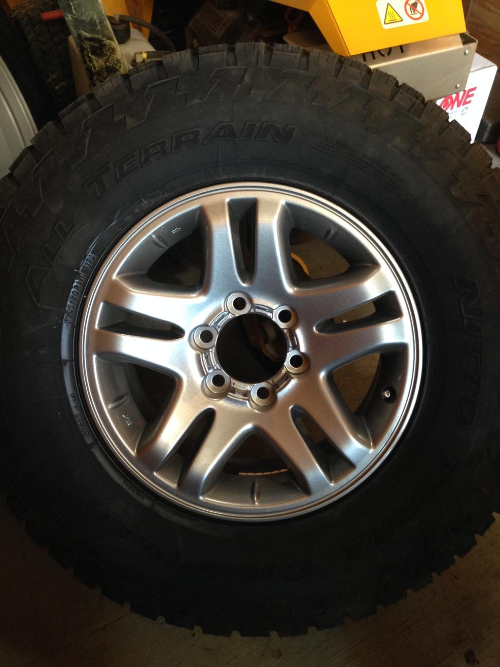

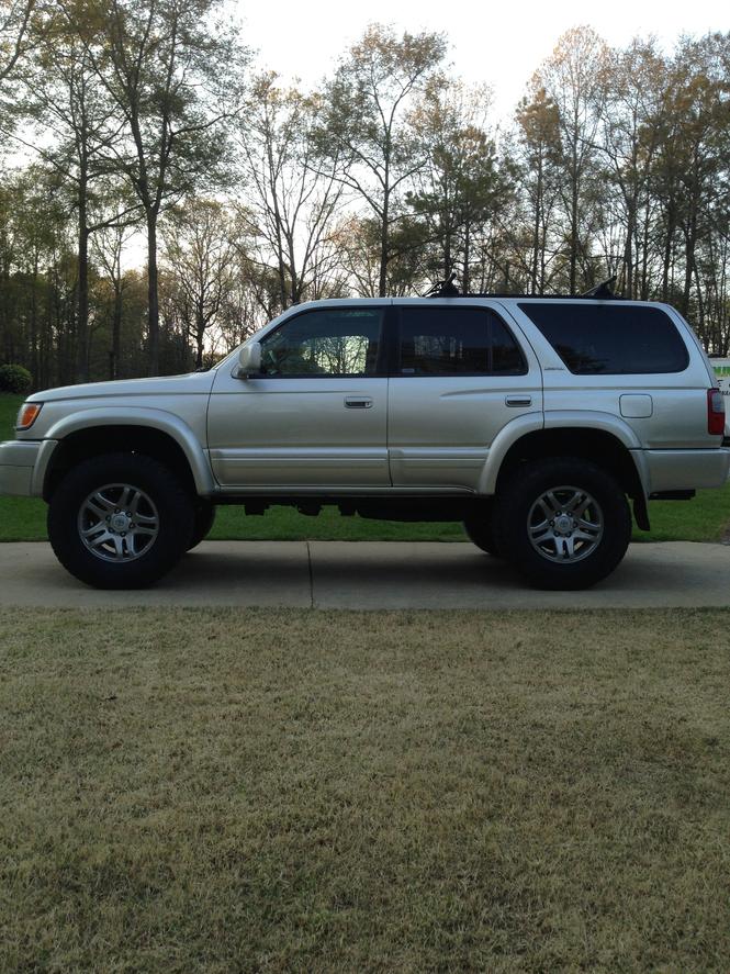

Finally got around to buying tires.....settled with a set of Nitto Terra Grappler 285-70-17 with the 5 star split rims.
I am having a problem getting my center caps to stay on.....they will not snap in place like they did on the other rims.
Any suggestions??
I really like the look of those split-spoke wheels.
No help with the center cap issue, however. Good luck with that.
its coming along very nicely, great idea with the sandblaster, that is on my list of tools to have as well.
with these wheels you really have to whack in the center cap, also i suggest buying extras, as the tabs tend to break, be careful with them and never let anyone else take them off cause they will mess them up.
