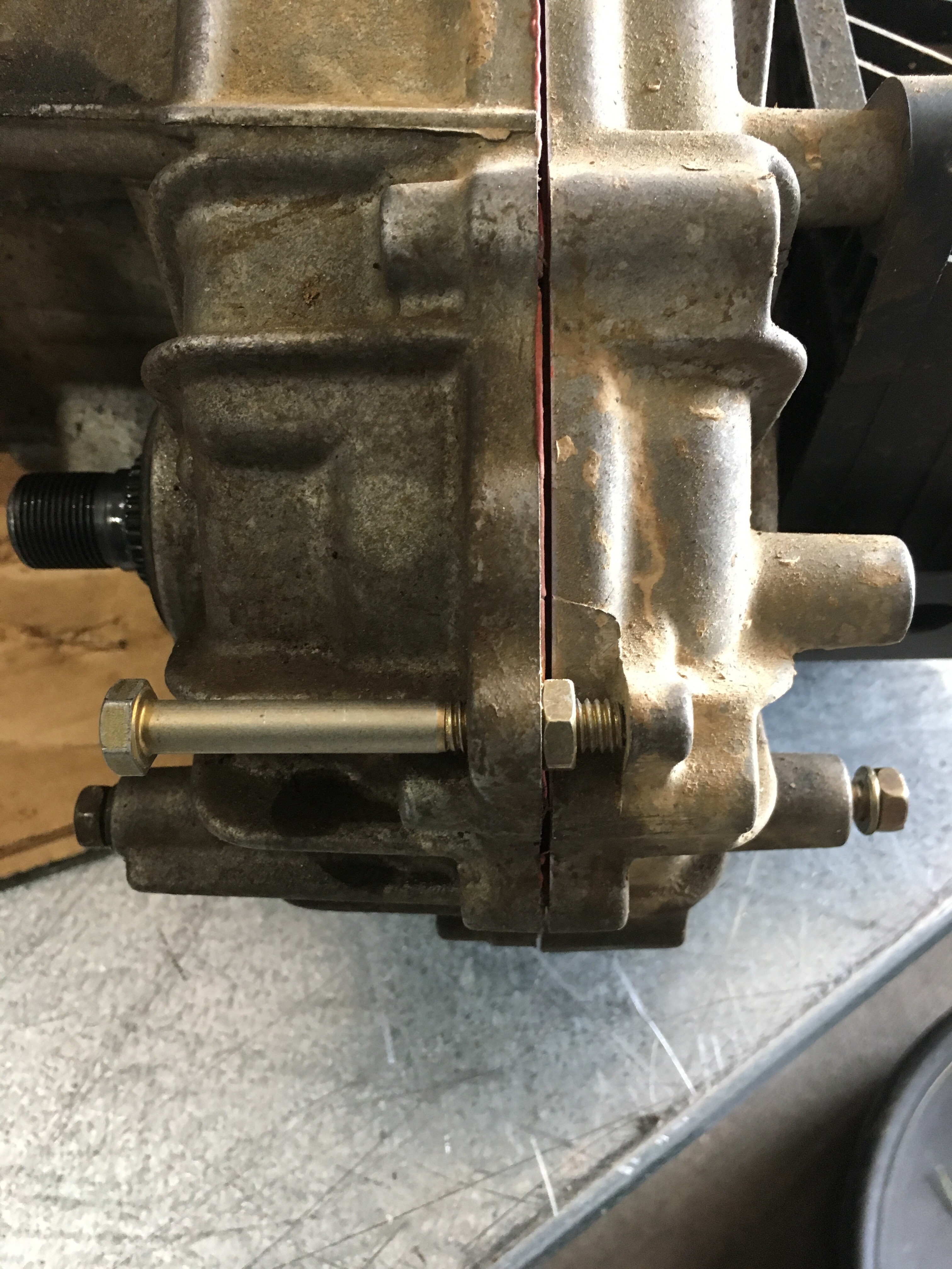

I managed to borrow a scissor transmission jack, which was worth it's weight in gold. Like some other posters here, I fabricated a jig to hold the t-case level on top of the jack. This made reinstalling much easier. If anyone is planning on doing this job and wants my jig, it's yours for free (but it's just scrap lumber that anyone could make). One thing I can add is when you get to the point of splitting the case, look at the top side, just above the front driveshaft output--there is a feature on the case designed for some kind of special tool to 'screw' the case apart. I just used a long bolt with a nut, tightened the bolt, and presto--the case splits right in half.

This is a great tip! Thanks for adding the “how to” on splitting the tcase. I’ll be doing mine this Friday so hopefully it goes as smooth as what everyone says here. I’m sure how you were feeling, will be how I’ll be feeling as well.

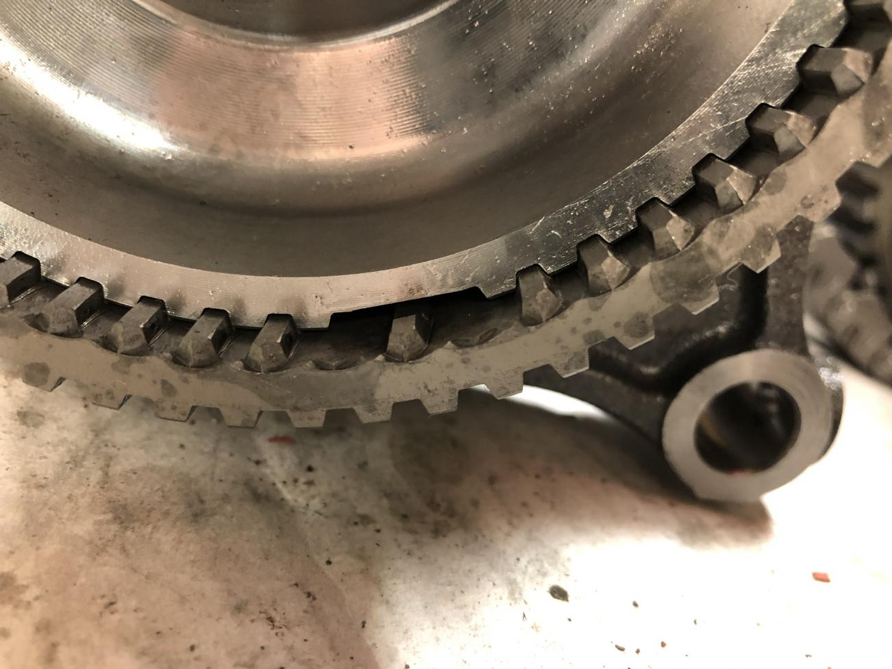

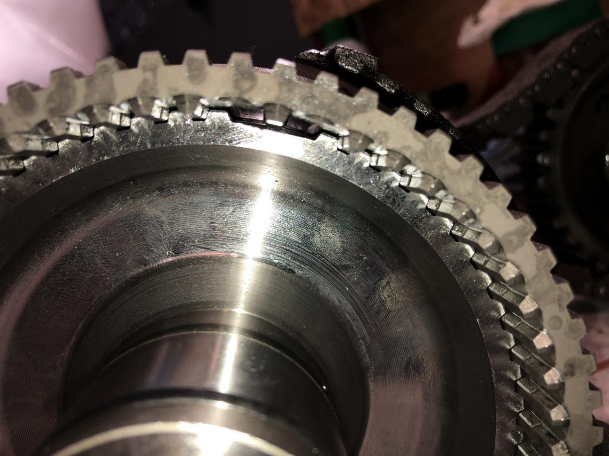

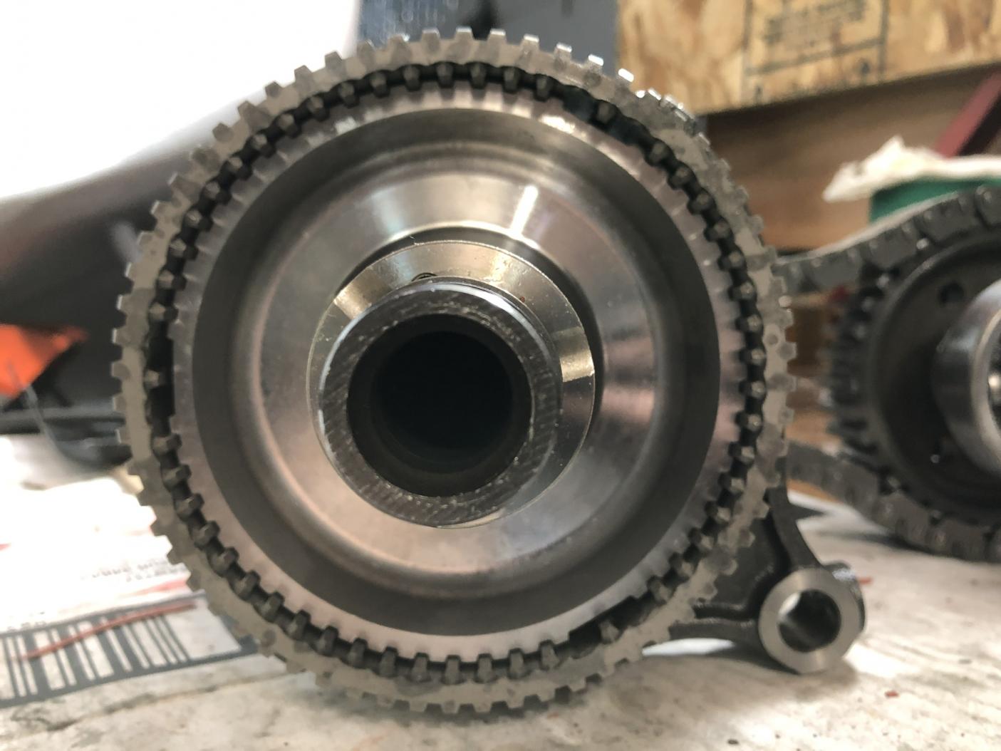

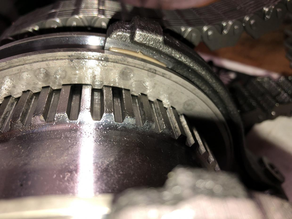

I have torn the TC apart to replace the orings in the TC and actuator. I will be doing a write up with pictures once I re assemble. I ran into one issue upon re assembly and need some assistance. When I unbolted the first shift fork, the first large gear slide off amd I don’t know the exact position it needs to be in. There are three slots inside where some of the gear teeth are missing. I assume they are aligned on the shaft in a position that allows proper shifting and or lubrication. I know the second gear and fork (last image) are in the right position as I photographed before disassembling. Thanks in advance.

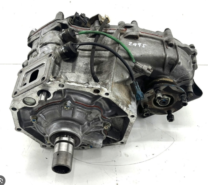

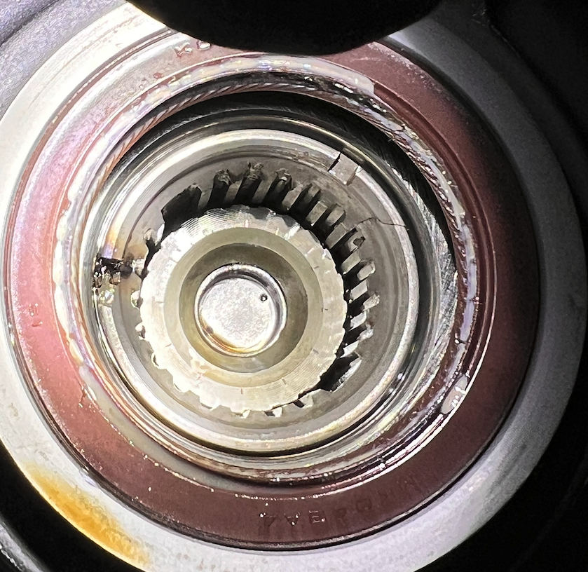

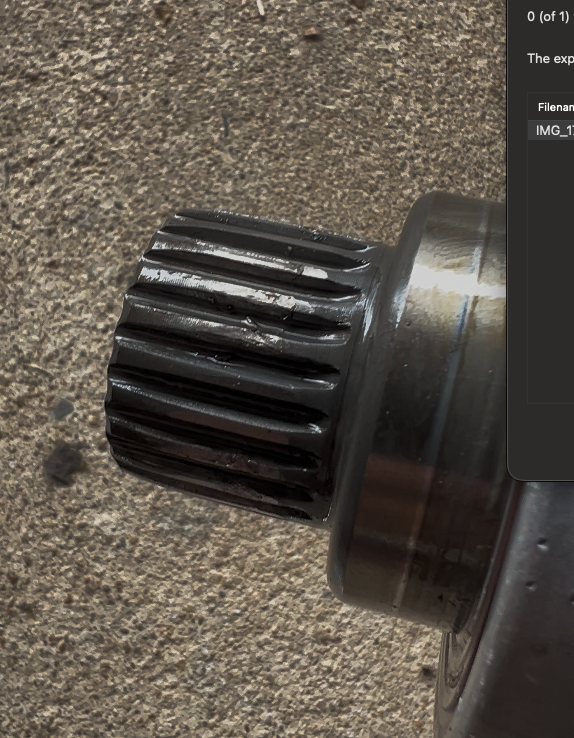

Anyone know what the part# is for this coupler on the front of the transfer case? Mine has broken and I can't seem to find the part# to get a new one. When I removed the trasfer case the coupler stayed attached to the rear of the transmission. At that point I thought it was the rear of the transmission. And was cracked and needed to be fixed or replaced by taking the transmission out. After remove the back bell off the rear of the transmission I was able to get off now just need to find how to replace it. Toyota told me it was not a serviceable part and will not give me any part #s
What my rear Transmission look like after removing the t-case
And what my t-case front shaft looks like after removing it. So you can see the first pics has the collar on the end of the shaft so it can mate to the transmission shaft.
