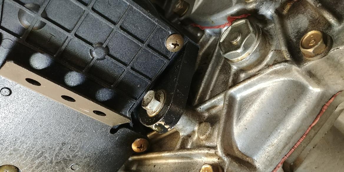

I have the same leak described in this thread. Leak between the actuator and transfer case. Dealership is telling me that I could potentially have a cracked transfer case. Has anyone come across this? Its a 2004 v8. Thanks in advance
Could? I guess, but it’s unlikely so. The dealer can say whatever they want because they aren’t going to replace the o-rings anyway. I’m at about 10 months with no leaks since I split the transfer case and replaced seals.
