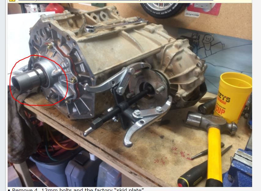

Jack stands instead of ramps for both safety & convenience. Putting it in neutral to remove driveshafts is very convenient
If you've never removed your driveshafts, they're going to need encouragement. A firm knock or three with a brass drift and a 5lb hammer against the Ujoint makes short work of this. Don't try to use less aggressive methods and don't hit the wings of the joint
Having bigger hands than average, I can see why FSM states to remove Transmission. Getting up in there to back out those last two bolts or remove the breather isn't easy, but it's doable.
If you're using a floor jack, make a cradle for it as some previous users have done. the TC has an odd center of gravity and non cradled support will give you a false sense of confidence.
Since i didn't have a T jack and I didn't want to make a cradle... the T case itself isn't that heavy and if you're of decent built, you can lift it out but it's sure nice to have a trolley to put it on as it feels a lot heavier when it's on your chest.
Follow the instructions to the letter to replace the seals. They are expertly written. I used the red FIP gasket from Toyota so that it would look stock.
Somehow, when lifting a TCase to reinstall, it felt a LOT heavier... you can do this instead of chest day at the gym.

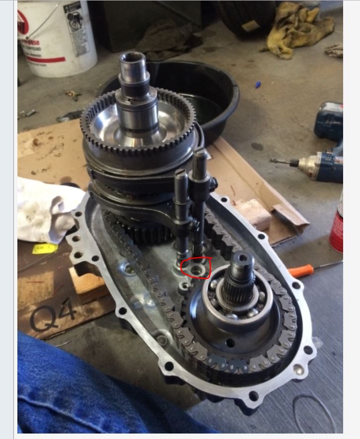

The oring design is also a failure in its own right. The gap is wide enough to put 2 orings in comfortably. So that's what I did on round 3. These orings by the way ended up being common ASA sized o-ring and can be had for pennies, it was size 035?, but I misplaced the package, but the Toyota ones are cheap enough to get 2.
The shaft seals are really not the culprit in this case, I had maybe 3 drops of gear oil visible inside the actuator on a 13 yo truck.
The key i think is to plug that unused hole in the case. It is slightly smaller than the stated seal ID of 15MM. Harwall sells blind 15mm seals similar to the old freeze plugs, and I drove 1 down into the unused hole. Not a drip in the 3 weeks since.
I'd like some confirmation please. The 2 O rings - are we talking about the large O ring? I'm assuming so since we are calling the shaft "seals" so there's only one other large O ring to play with.
Secondly, is this the hole in the picture that is being discussed as possibly being the culprit and can be plugged with 15mm ID blind plugs from Harwall.

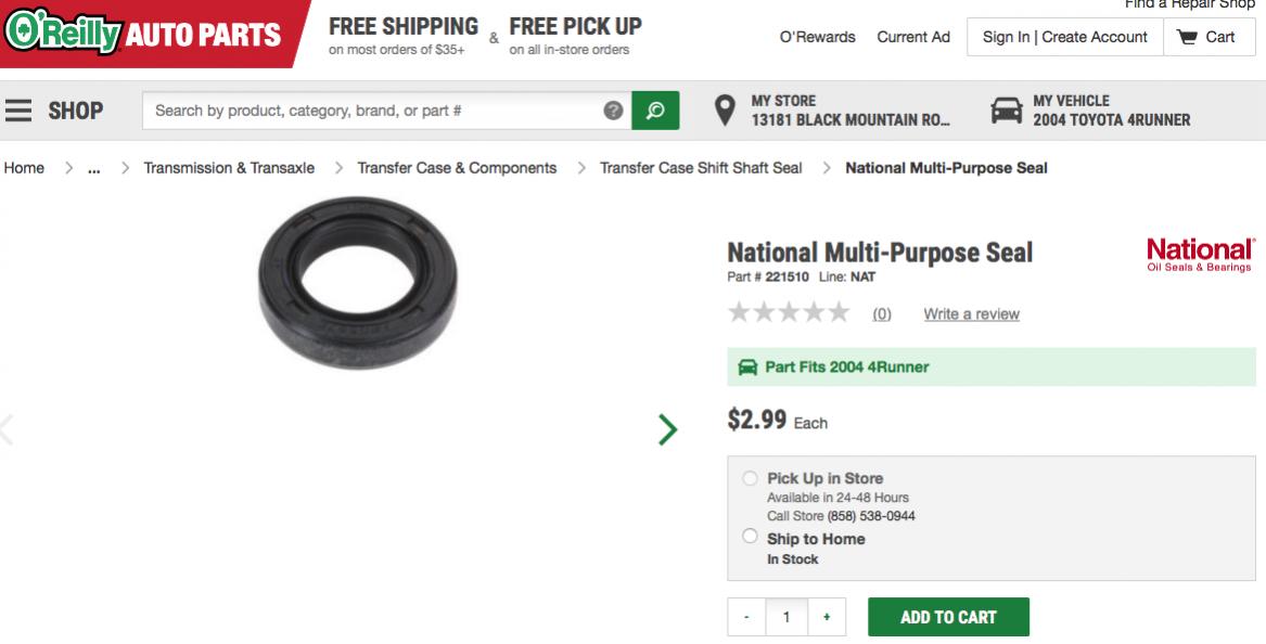

I just called Colonial, they're asking for $75 to ship overnight. Plus they're not in stock.
Any other source out there? Or maybe someone here has an extra one they don't need?
Thanks!
Thanks!
I got mine at O'Reilly.
