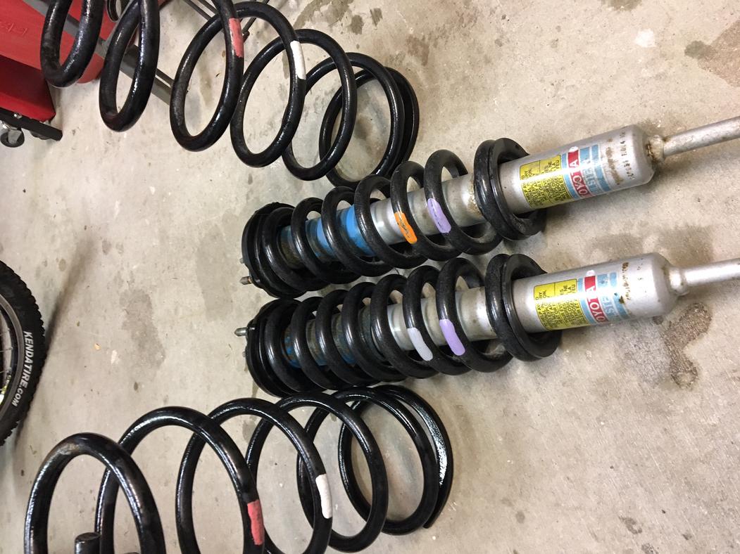

Ok, now I am confused again. I have read a few threads that say FJ springs will provide about 2" of lift. Then, I saw one where someone installed them and got zero lift- and these were springs from a 2012 I believe. I have springs from a 2014. Looking for a 2-3" lift and going to use Bilstein Tundra 5100s. If anyone has any info, I would like to know if these springs will lift it (2000 Ltd) and if so, how much. I was thinking I would use the lowest perch on the front shocks and would have about 2" of lift. Now I wonder if I need to use a higher perch and do I need taller springs for the rear. Anyone know about this??
Thanks, Dan.
These are the springs I have.
