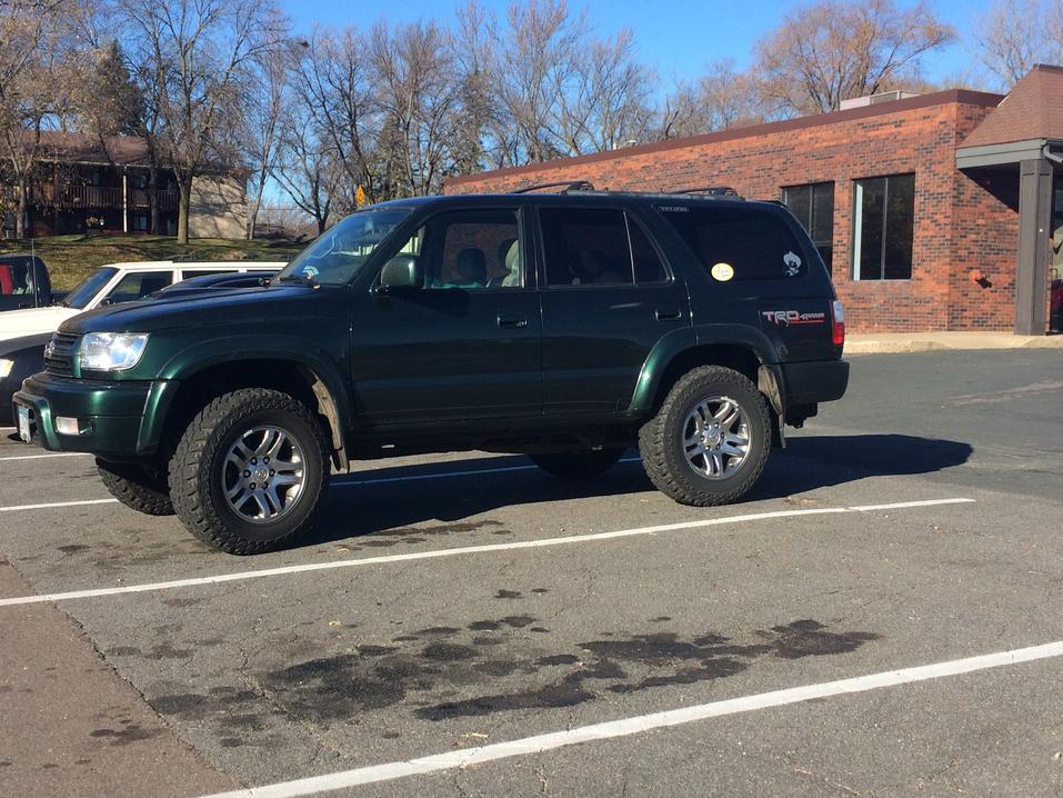

Any recent pics of yours that shows the lift?
OK, I re-read your post. For some reason I was thinking that you had earlier model springs and I read in a different thread that they may not all be the same height wise so just wanted to confirm. Thank you.
I'll get you some in the morning
[MENTION=108384]Soulman[/MENTION]
Here's a very crappy phone pic. I got called in early today.

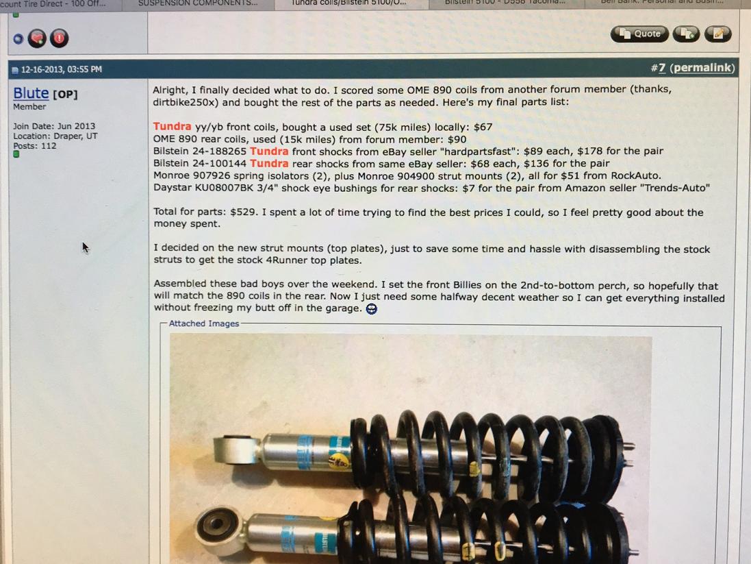

These are the springs I have.
So what's the verdict it's been about 5 months? Any pictures?

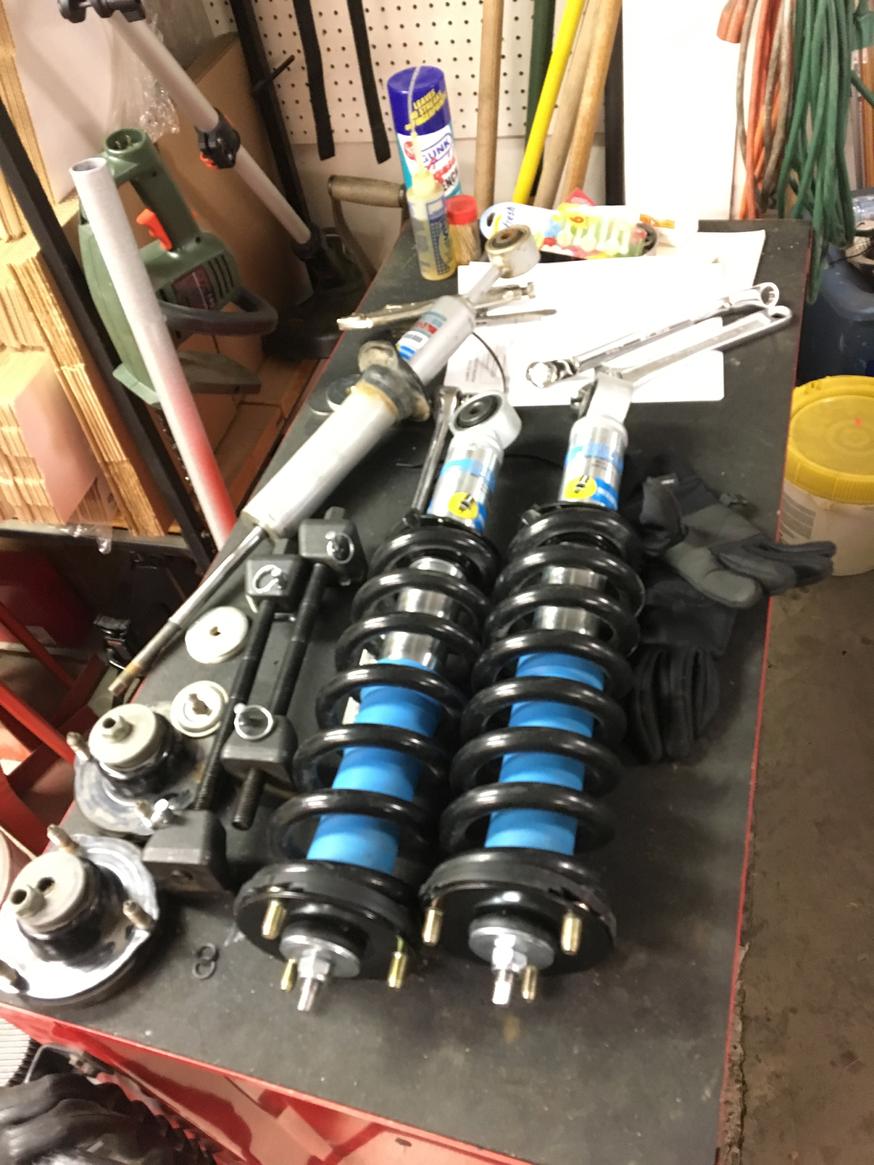

The springs worked great and provided about 2" of lift all the way around. I ordered the exact parts from the list in the pic and they worked great. As a reminder, my springs were from a 2014 FJ with about 25K miles on them. Here is the parts list.
I ended up not needing the new spring isolators, the ones on there were in perfect shape.
Here are the springs after I got the new shocks mounted. I re-used the blue boots (they were in great shape). The shocks came with the black "accordion style" boots and it didn't seem to me like they would work that well inside the spring. Maybe they would have been fine but I had the blue ones so I went with them.

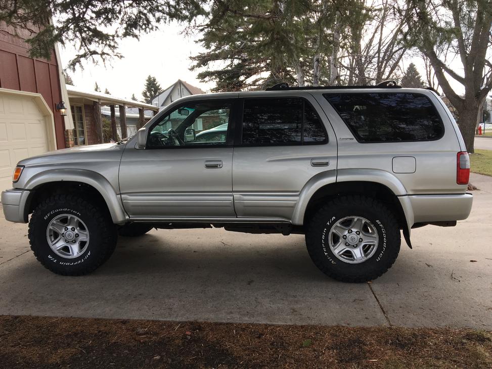

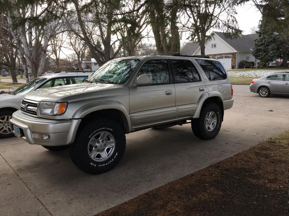

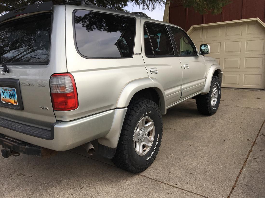

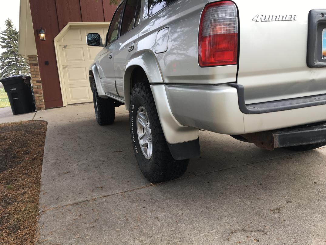

And a few shots of the end result. The tires are 285 BFGs. They look great, work great too, but do rub a little bit when the front wheels are cranked. Probably needs a little trim job but haven't gotten to it yet. This is my brothers Runner and he has been driving it with no issues so we'll see if that even needs to be done.

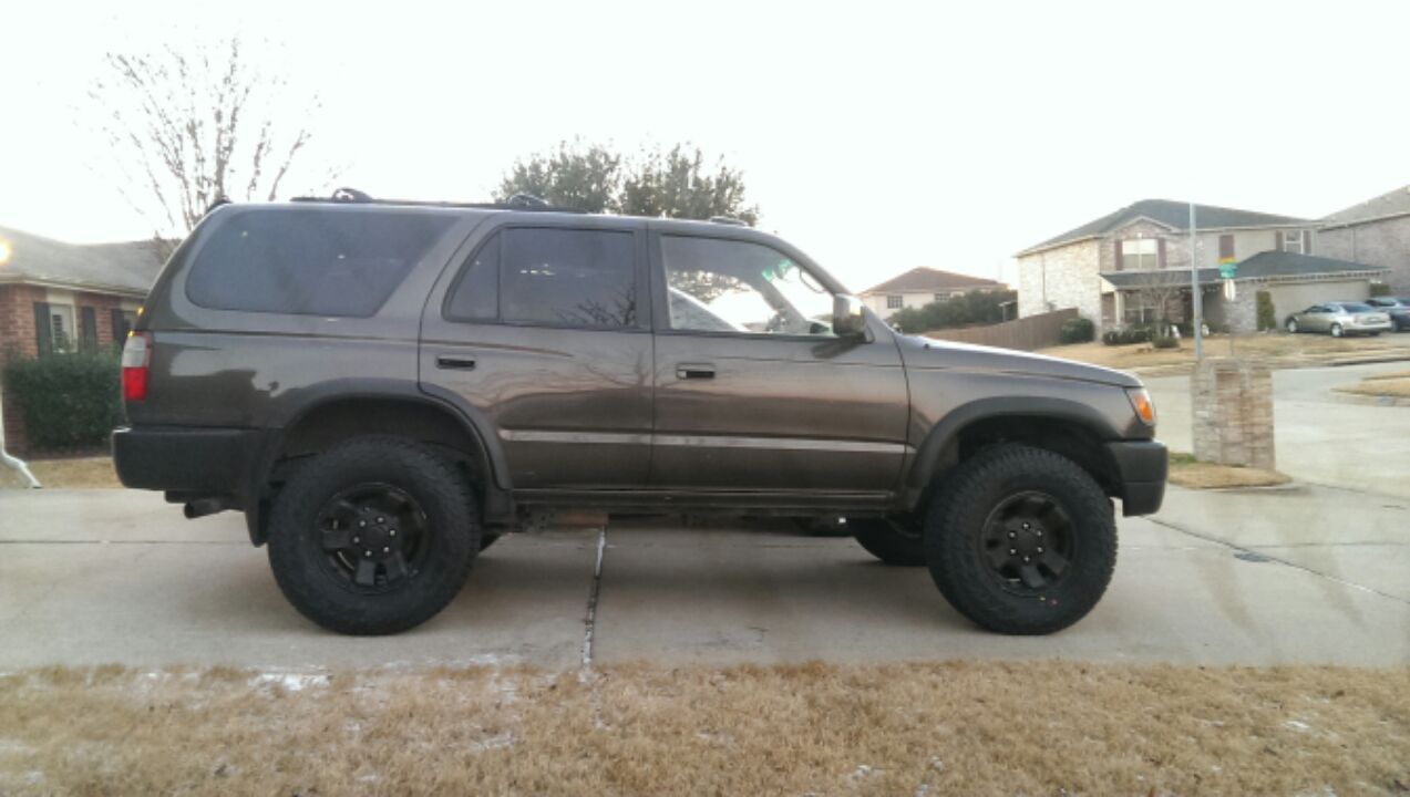

96 SR5 with 2009 FJC 4x4 springs all the way around, with KYB Gas-A-Just shocks replaced at same time (all around). Tires are 265/75r16 falken wildpeaks (highly recommend).
For me, this set up is perfect. I'd say I gained on all corners. It is definitely higher, probably not much more than 99 talls would have done. Total cost was right at $300 (including $50 to have the new fronts assembled).
Current measurement from center of hubcap is right at 22" all around. I'm not good at documenting, but here is after pic. (obviously, also not good at pictures)
Might be chiming in late but hope this helps someone. I was going crazy looking for an affordable mild lift. I am extremely happy with how it rides.
