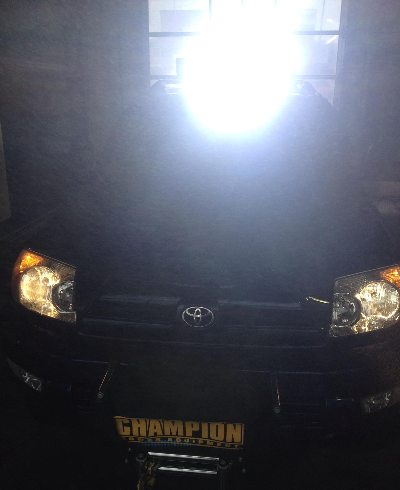

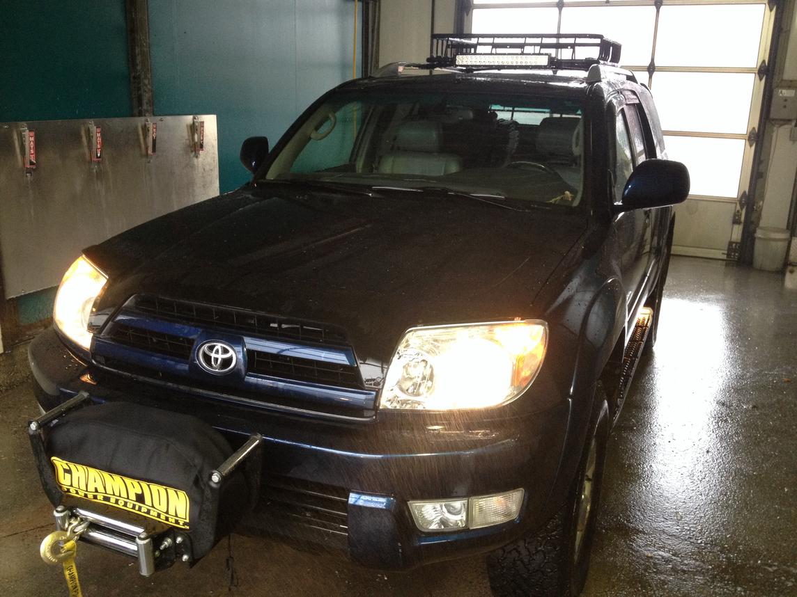

Got the bar up and lit last weekend finally. Been busy so have had to accomplish this an hour here and hour there style.
They certainly light things up. :biggrin1:
The rack setup is temporary. I plan on doing a custom build down the road. won't be for a few months so this will do for now.
I would post a pic but I can't seem to make that happen, don't know why. ugh

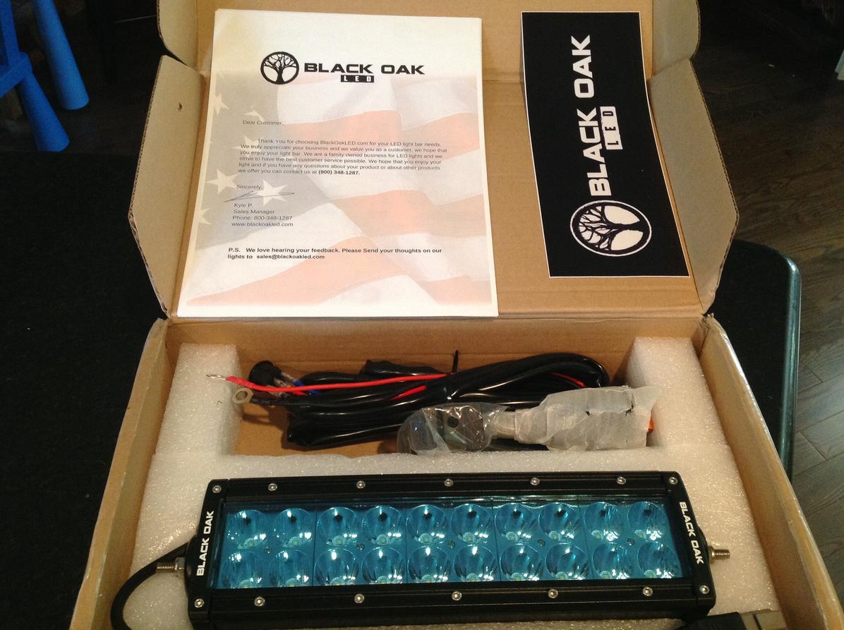

Just finished this and these came in the mail... x2
Hence the second FJ switch you noticed.
They are two 10" Black Oaks which I will wire together to the other switch.

Worked like a charm!!
All set up and lit up.
