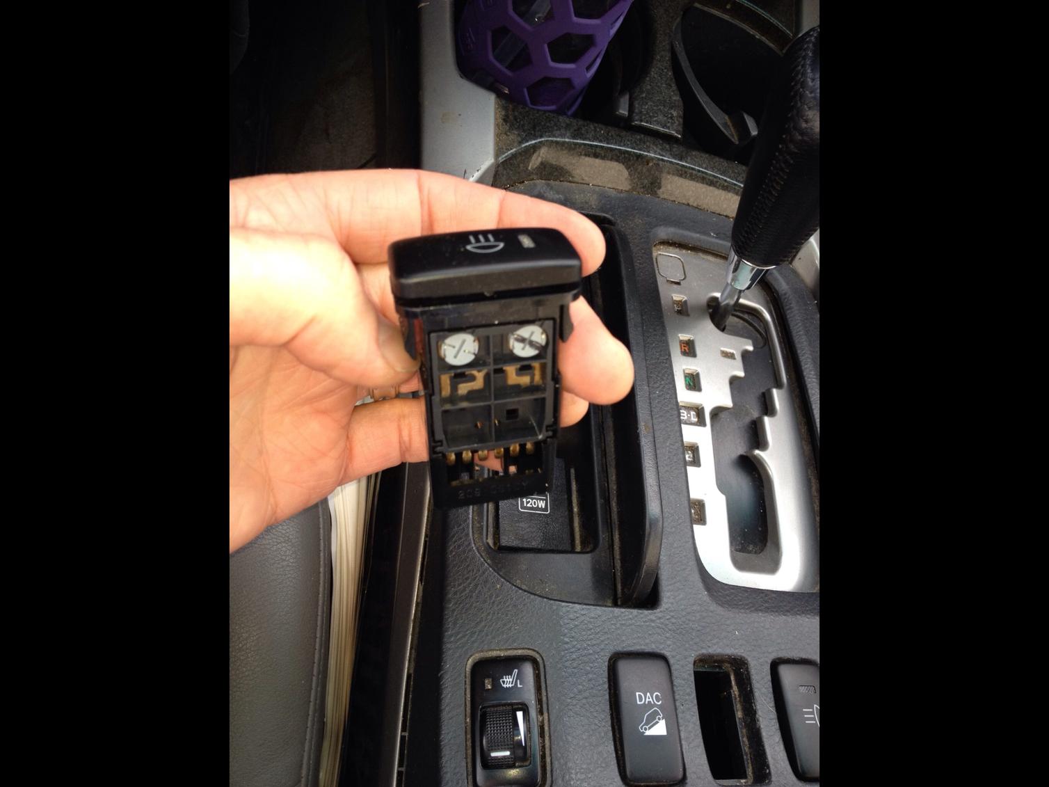

Ok so Darkie3495 you were the catalist in this purchace and I am stoked to get it up and running with my light bar (thanks gaterose GB). But being an eletronics noob/simpleton I need to know how to make these play nice together.
I have very limited know how with wiring up stuff but I am very good at step-by-step directions...:hippie:

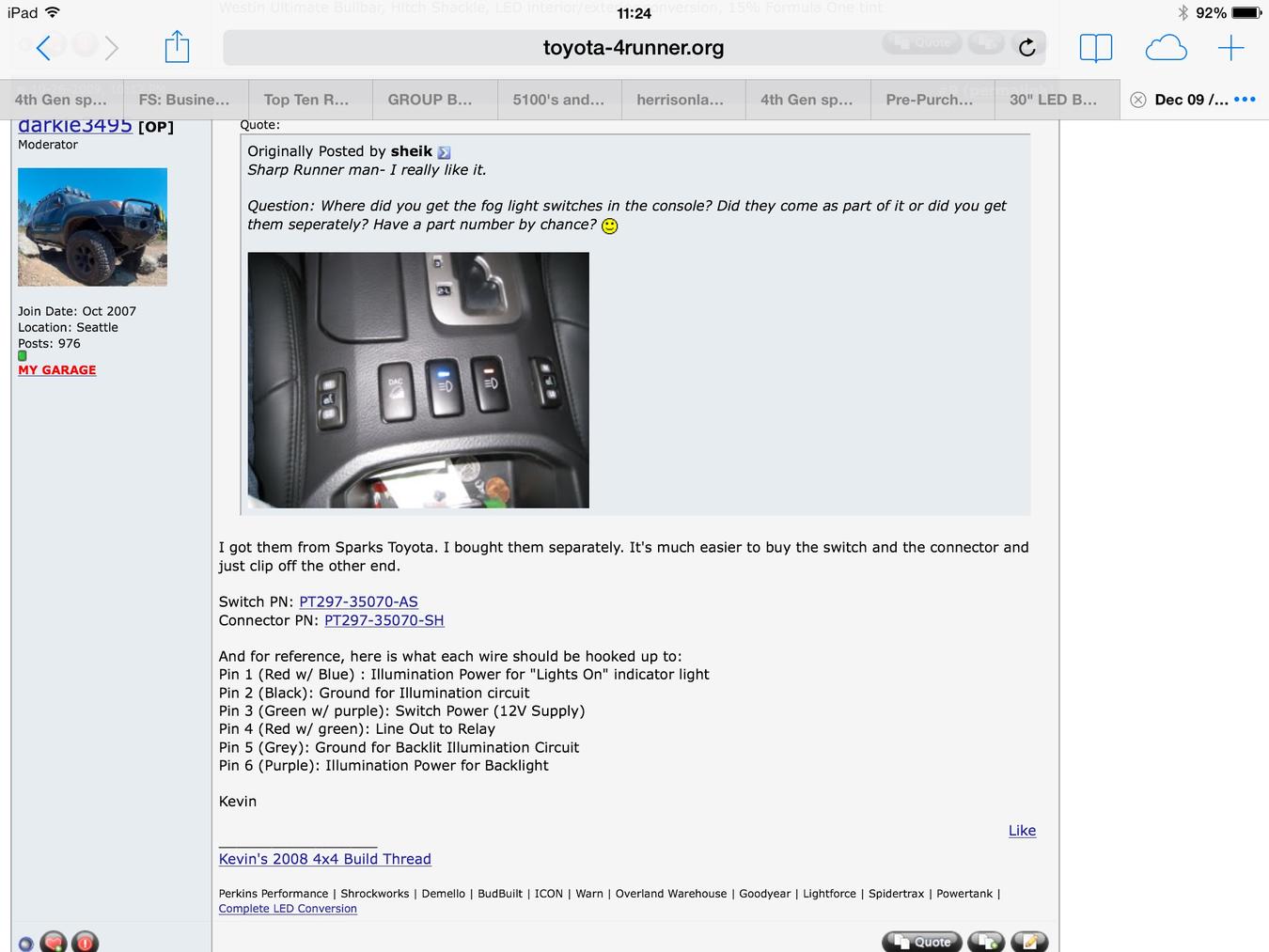

Here's another nice reference from [MENTION=20116]darkie3495[/MENTION] that I used to help in my wiring:
this diagram might help:

Here's what I did, it works, others may or may not agree with all of my moves, but I'm confident I won't have any electrical fires, my lights work, the dimmer works right, and I'll be able to troubleshoot the wiring if something fails, which is all that matters to me:

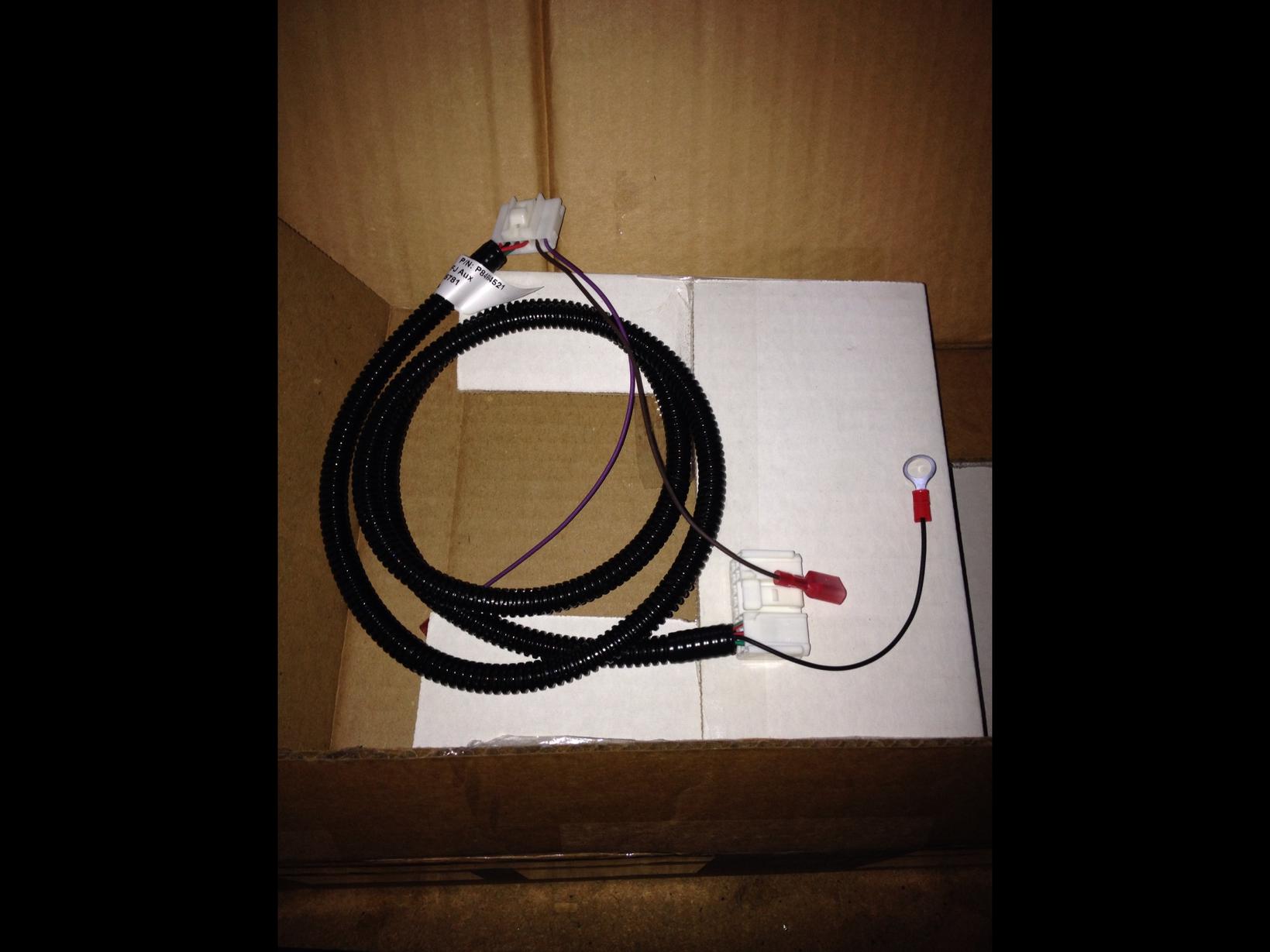

Cut the connector and ring terminal off of the wires on the end that does NOT plug into the FJ switch. These wires need to be wired to other things. You can cut them at the connector, or up closer to the FJ connector, whichever you prefer to your liking for cleanliness. (I like lots of extra wire in case I screw up, or need it in the future, so I cut in about the middle of the harness)
Take that red wire w/ blueish purple tracer (line) on the new harness (pin 1) and run it to one of the coil prongs for the relay you should be installing (typically labeled 86). Now take the red wire w/ green tracer (pin 4), and tap it into that same wire using one of these:
5601.gif~original
Now take the black wire (pins 2) and tap it into the ground on the DAC switch, which is a white and black wire.
Now take the brown or grey wire (the one next to the purple wire, pin 5) on the new harness, and tap that into the white wire the green tracer on the DAC switch. Notice, there are TWO OF THESE. I tapped into the one that was next to the green wire on the DAC switch, NOT the one right next to the white/black one you just tapped into above.
Now take the green wire with a redish purple tracer (pin 3) from the new harness, and send that to one of these:
190257d1261094229-rocker-switch-wont-turn-1c4adfe6-eff3-4dd3-9dc6~original
or these
~original

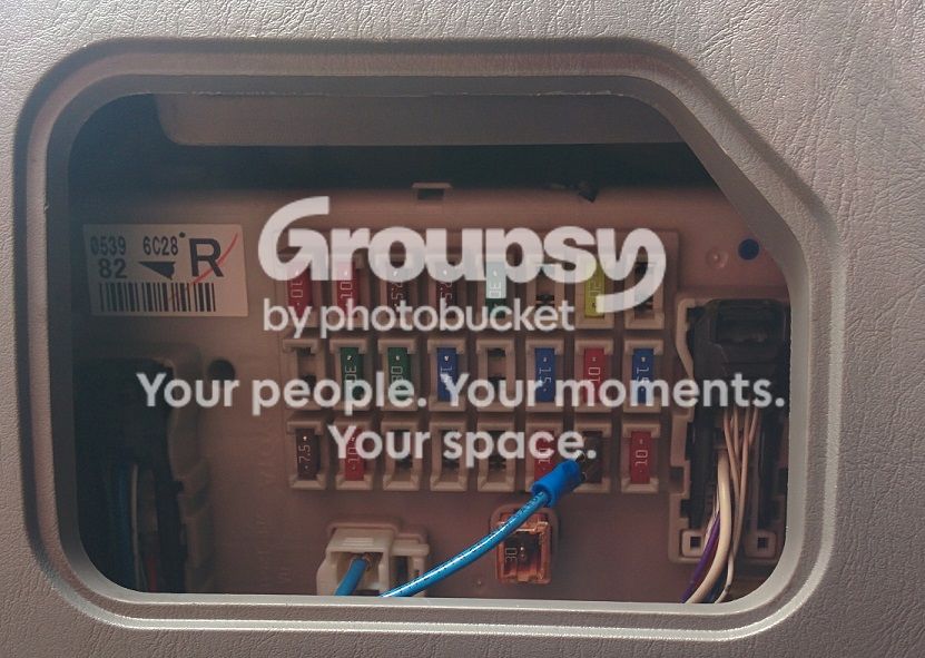

that you should be using on the 'lower right section 7.5A fuse' as mentioned in the above wiring diagram from [MENTION=20116]darkie3495[/MENTION].
lightswitch%20fuse.jpg~original
Now take the last wire, should be the purple one (pin 6) and tap it into the green wire on the DAC switch. (this green wire should be right next to the white/green wire you tapped into previously).
This takes care of the FJ aux switch. You should be able to turn the key to ACC now and test that the switch lights up and dims the same as everything else in the car, and the little light should come on when you press it.

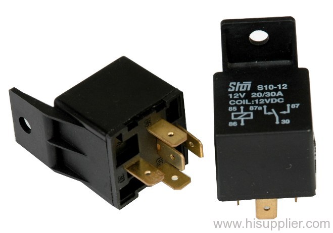

here's a diagram that may help, mind you the colors, amp ratings, etc. mean nothing, it's just for your reference of wires and where they are going:
relay-diagram.gif~original
You should have one wire on it already, it should be on one side of the coil, typically labeled 86. Now wire a ground to the other side of that coil, usually prong 85 (note that these prongs are not always exactly opposite each other. go by the numbers).
Now you're relay should click when you push the new FJ button (assuming the car is on). All that's left is the light.
Wire 12 volt source (Such as your + side of new fuse block, or + terminal on battery) to terminal 30 or 87 on the relay. Then wire the other terminal (87 or 30) to the + connector on your light. MAKE SURE YOU HAVE A PROPERLY SIZED FUSE BETWEEN THE + SOURCE AND THE LIGHT (whether it's between the source and the relay, or the relay and the light, just make sure its SOMEWHERE on that line). You can use one of these to get a fuse in there if you don't have a fuse block:

As to the relay, I went with whatever generic relay was available at my local oreilly's, looked like this:

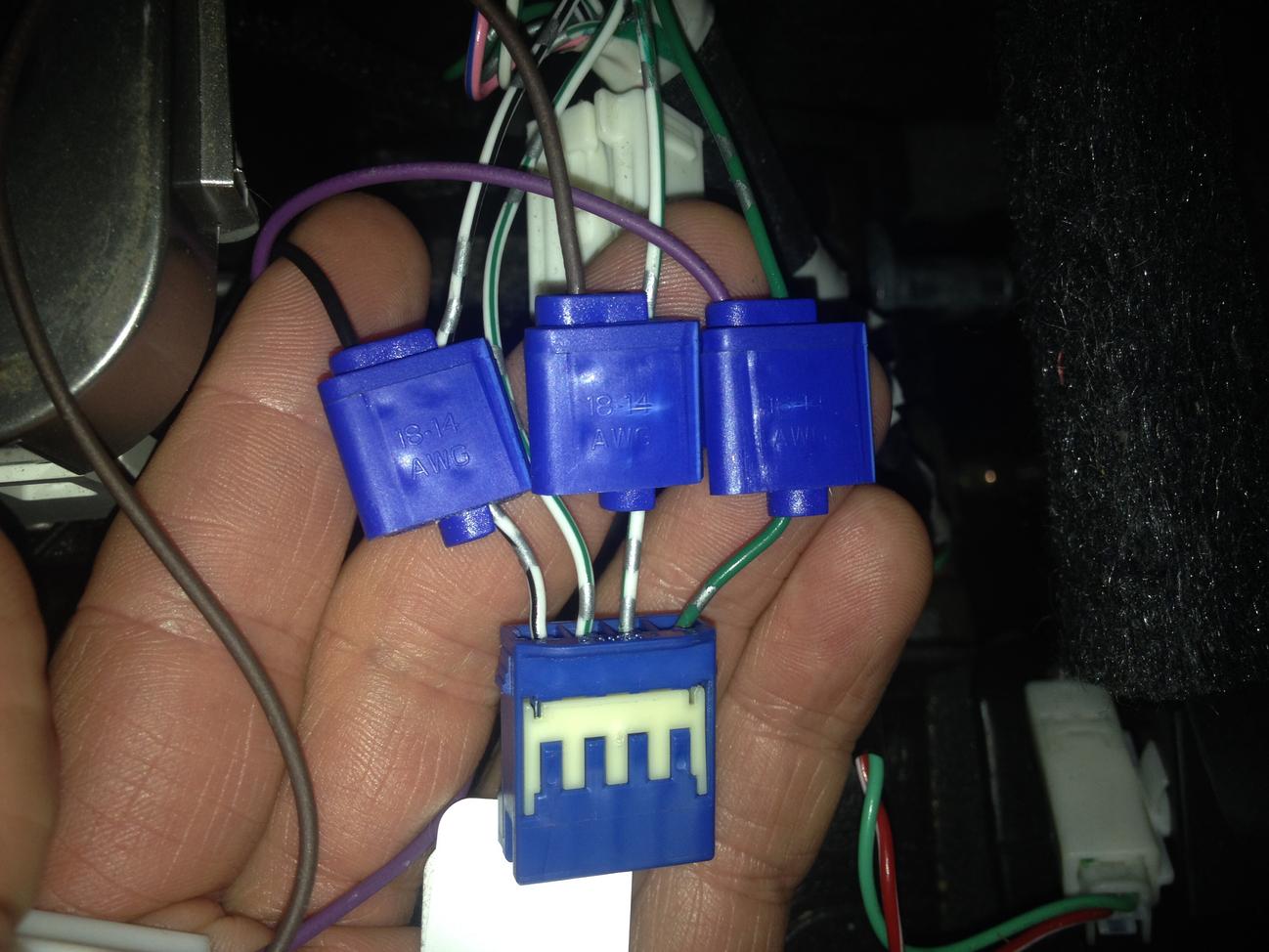

x2 on the wire tap for the DAC connections. One of those first pictures I stole from the interwebs up in my "step-by-step" (if you wanna call it that) is a blue wire tap, that's what I used.

Well I got the FJ switch wired up and the coil of the relay to the point of testing it with the ACC on the see if the back illumination and "on" light worked. Turned the key and lights on and nada. Bummer.
It was then that I realized that the DAC back illumination is not working and hasn't for so long it didn't occur to me. The DAC function works because when I push the DAC switch on the dash light that indicates it's been activated goes on. Just no back illumination.
Perhaps I could tap into one of the seatheater switches the same way as with the DAC switch. Thoughts about that?

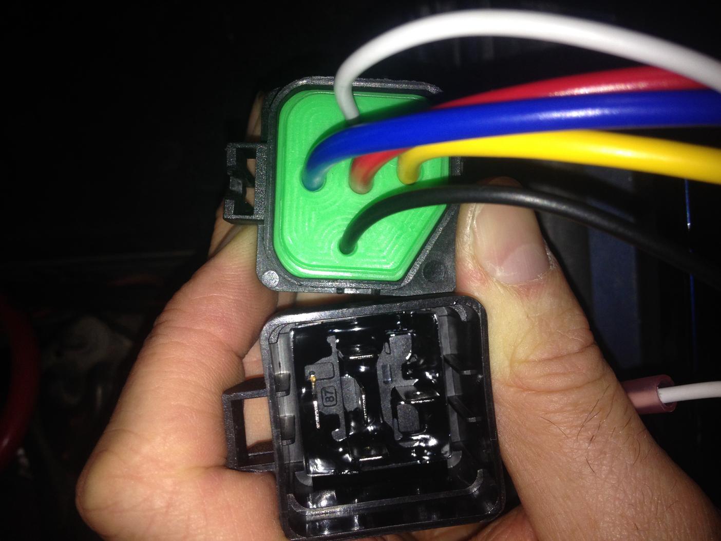

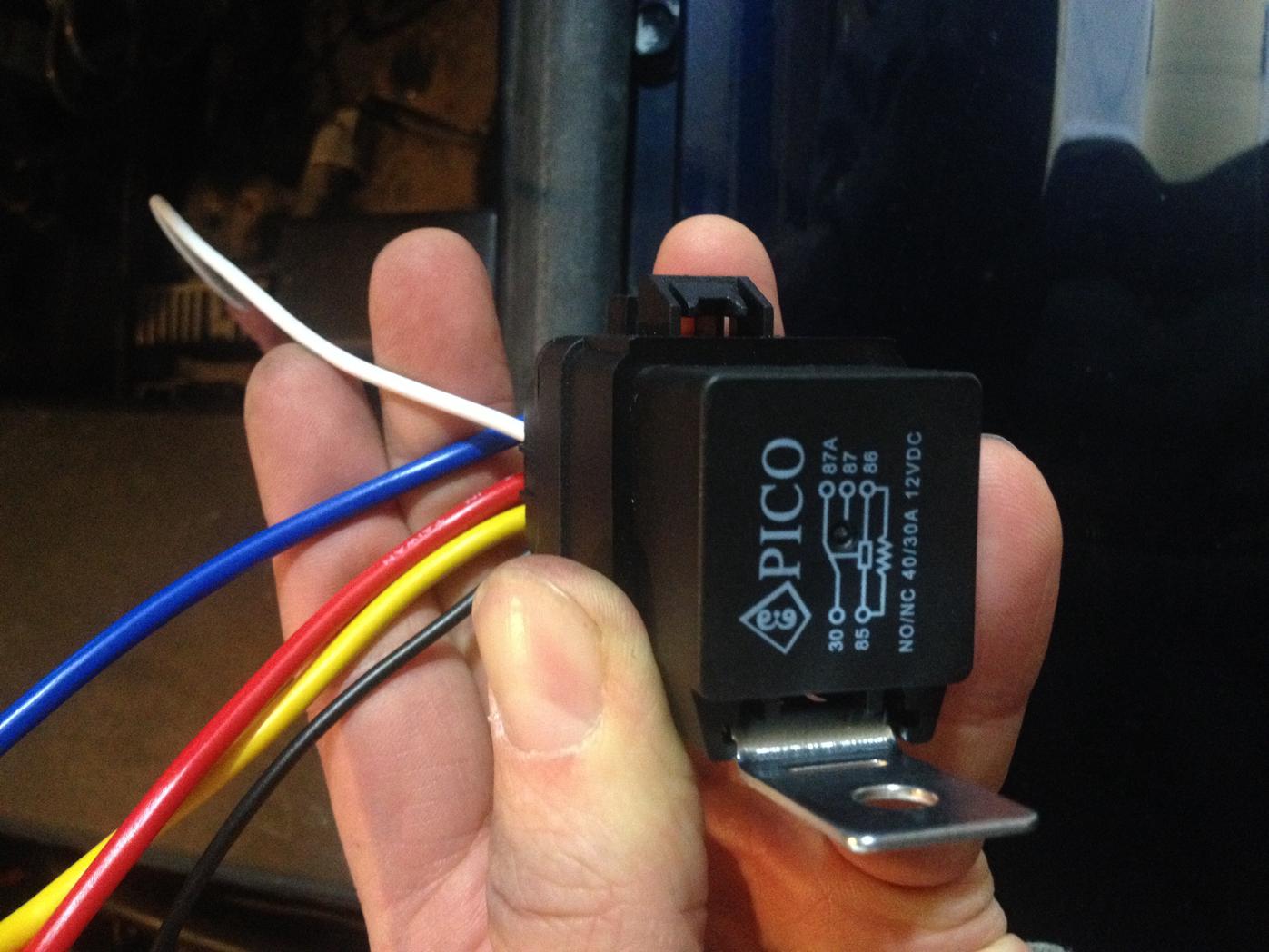

I may have not wired it up correctly. I got a water tight/ pigtail type relay and the only prong that is numbered is the 87.
Will attach a pic.

I'm not sure I am interpreting the diagram right with the wire color coding. The white wire are a smaller gauge of wire so I assumed the were the coil wires. I wired the white to my fj switch harness and black to coil ground. For the larger gauge wires the 87 is labeled and is the blue wire and was going to use the red as the other one. Correct?
Any thoughts?

To the DAC lighting: My DAC backlight bulb has been burnt out since I bought the truck, though if you're not getting anything on the FJ switch then something else could certainly be wrong if you are confident in your wiring. I believe others have used the seat heater switches, I don't have any so I can't say. If you have pictures of the wiring between the FJ harness and DAC harness we may be able to help, electrical can be tricky without pictures.
I see 5 wires on your relay. Which colors did you wire to what? I would guess that in relation to my above pin numbering that the following is your best bet:
30 (power from battery/fuseblock/fuse): Yellow
85 (coil neutral/ground): White
86 (coil power from FJ switch pin#4, red w/ green tracer): Black
87 (power to lights, or to fuse then lights): Blue
87a (not used): Red
Another.
Any thoughts?
This wiring should have worked as far as the relay coil is concerned (typically the coil +/- wiring doesn't matter as long as one is + and one is -). But using that red wire I would guess your lights would be on all the time (using the normally closed contact). I would look at my above post and I would also guess you are missing something on the FJ switch and DAC harness connections.
You just reminded me, if you wire that appropriately and it works, you should cap the unused wire as it will have 12VDC hot on it anytime the light bar isn't on. Not a huge deal, just could lead to a blown fuse now and again if it touches metal. (This reminded me I should probably go cap an extra prong I have on one of my relays :) )

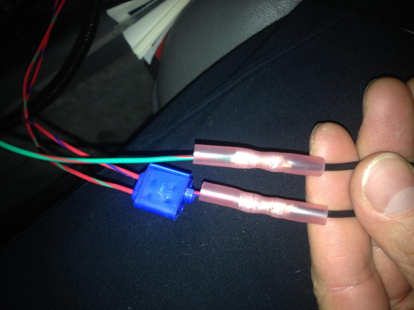

Here are 2 pics of the wiring. Hope it is clear enough.
And duly noted I will cap the 5th tab
The set on left with 2 red wires goes to relay and right to pigtail in dash fuse box 7.5 bottom slot second in from left
Well done, that looks like a pretty clean job. Clean enough to have me befuddled for now. Assuming that green wire red tracer goes to an ACC 12v power source, and those two red wires with green and purple tracers go to the relay you, then I'd have to question my directions and wonder if I confused the relay coil wiring. I'll take a look in the morning and let you know. If you have access to a multimeter I would suggest checking continuity between the pins of the DAC and FJ switches to ensure your wiring connections are good.
