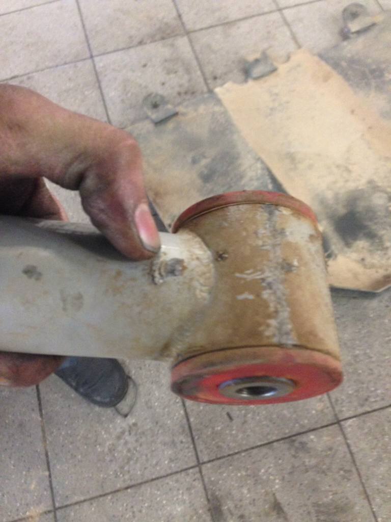

Remember to install the link with both zerks facing upwards. Use some polyurethane bushing grease when installing the bushings in the link as well.

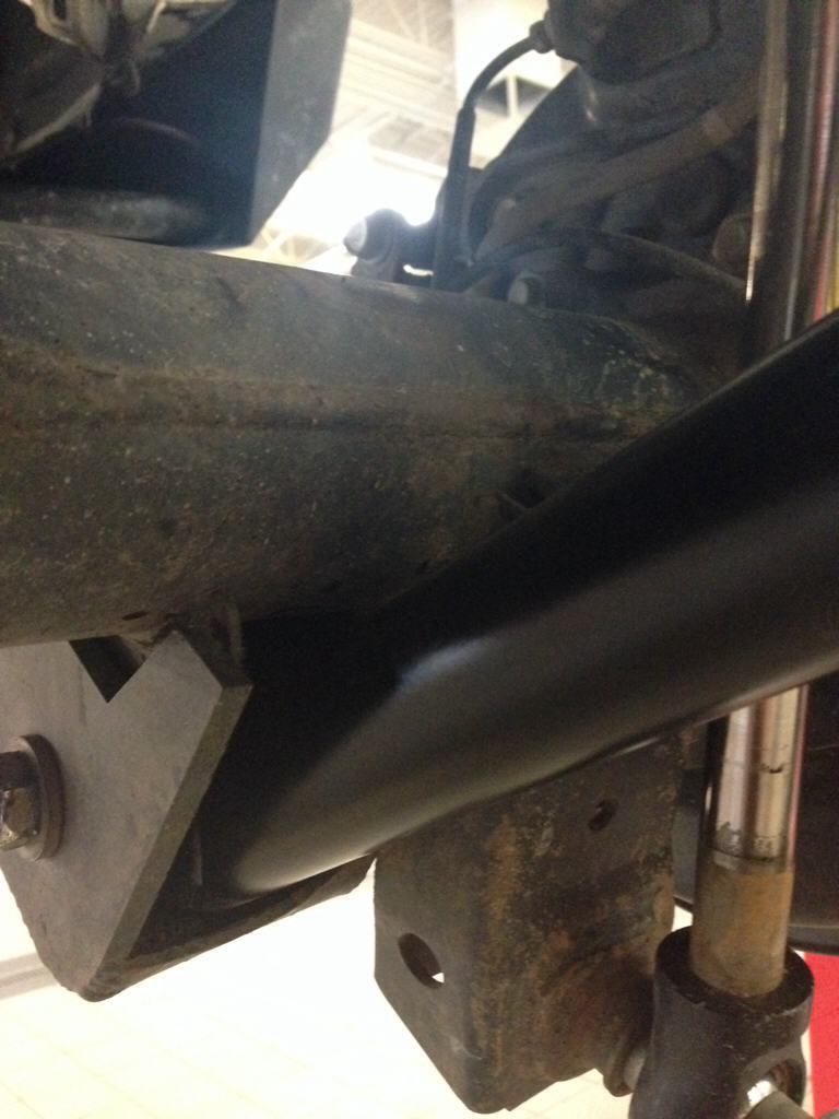

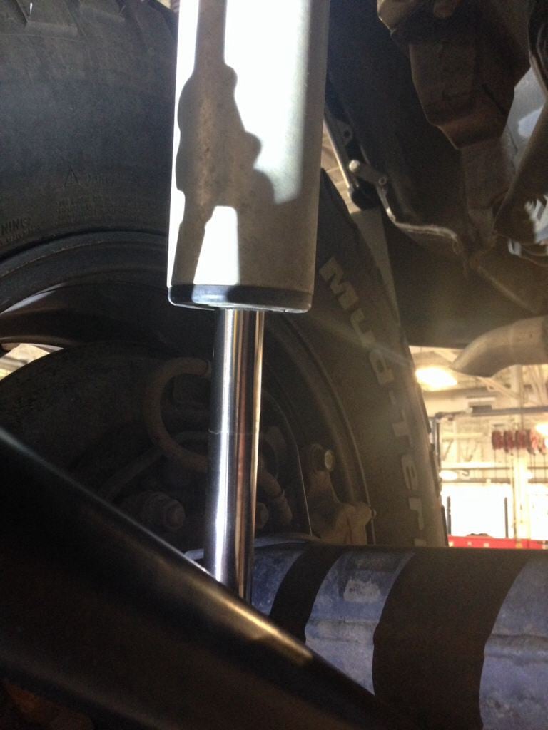

Just installed mine. Note the new dust line on the shock. Definite gain over All Pro control arms.
Note where the All Pro arms would hit the control arm mounts.

Yes, I found this out after I had one side installed. Also, grease the fittings before you install them, cause I still haven't found a 90 degree zerk fitting for my grease gun.
They did go on quickly though they are 3/16" longer than stock, which is the shortest they would go.
