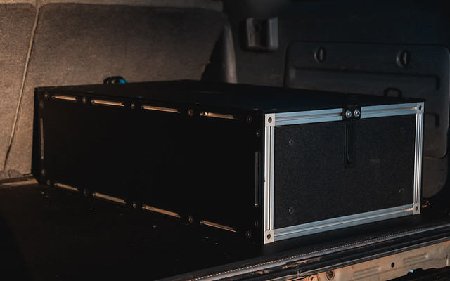

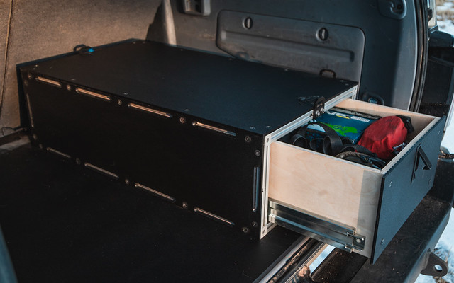

As far as recent things go, I have since replaced my drawers. Soon to have two of these bad boys.
These are the Sherpa Equipment Co. PAK System and they are super rad. We are really happy with how they turned out.
These mount to a baseplate, so no turn buckle BS. Everything simply just bolts together and bolts into the floor for a clean and strong install. They also retain access to the extrusion so bolting accessories and tie-downs to your drawer is seamless and easy.
Overall, stoked to have a nice drawer setup. I also have replaced the upper and lower rear control bushings with some poly ones. Mine were wrecked so great upgrade/needed maintenance.

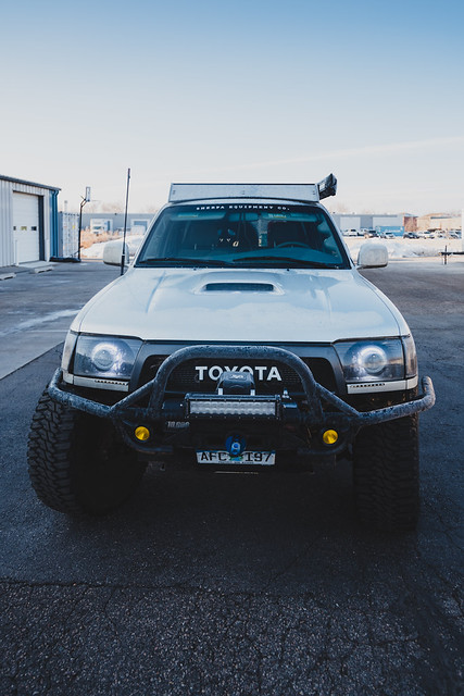

Trimmed the grill, plugged everything in, and yea. Back to 99%. Need an emblem for the new grill, put on new corner lights and my fogs dont have power for some reason. So, another day another problem but feels good to have the hard work out of the way.
