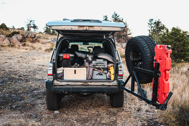

Next was rebuilding the swingout higher up.
<a data-flickr-embed="true" href="https://www.flickr.com/photos/140899154@N02/48529296622/in/dateposted/" title="Untitled"><img src="https://live.staticflickr.com/65535/48529296622_d8956a9a79_z.jpg" width="640" height="480" alt="Untitled"></a><script async src="//embedr.flickr.com/assets/client-code.js" charset="utf-8"></script>
Should have taken a before picture but just went to town. I added a cross brace from the tire carrier to my rotopax/antenna mount tube. Then cut off the tire mount and added a tube at a slight angle about 6" higher and welded it back on.
Took about 4 hours but Im slow when it comes to welding things and I like to take my time with grinding and sanding.

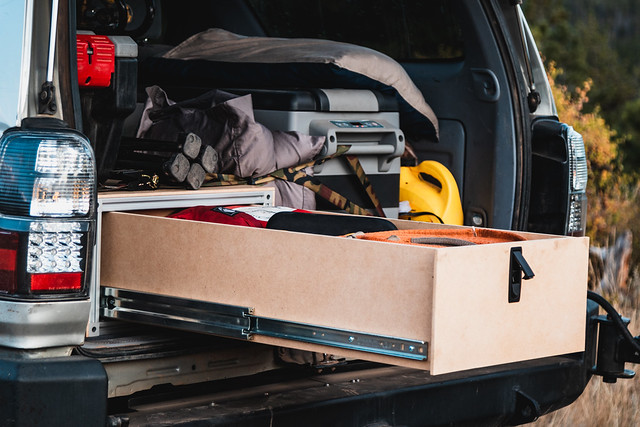

Lastly, Project new drawers is a go. We at Sherpa Equipment Co. are working on a cost-effective and high-quality answer to the overpriced drawers on the market.
Also, notice that fancy amazon fridge in the background. Works amazing and only $350. (Costway fridge)

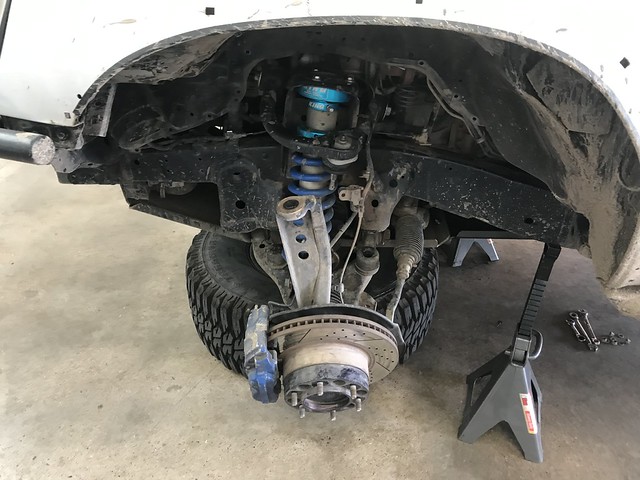

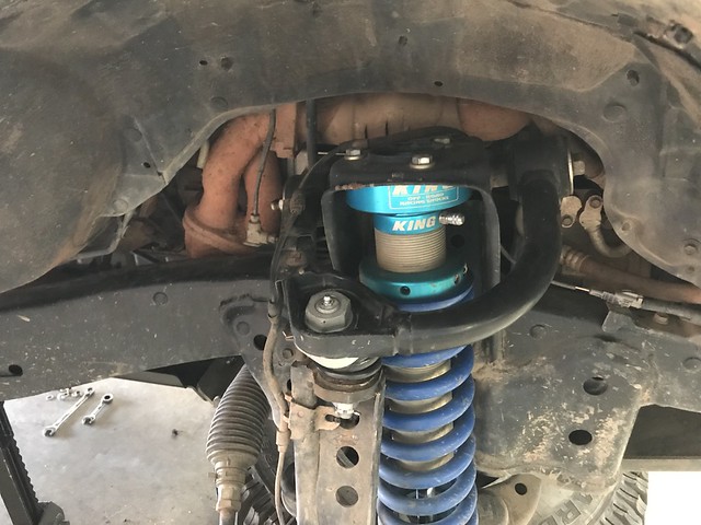

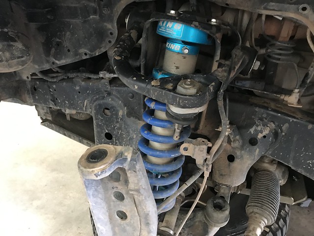

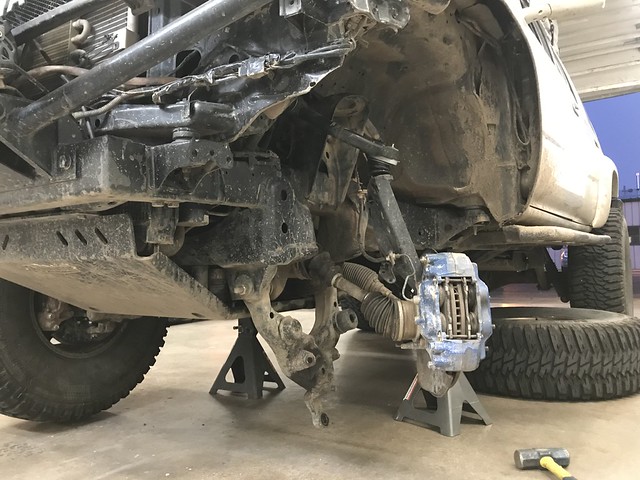

Nothing but maintenance lately.

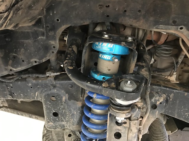

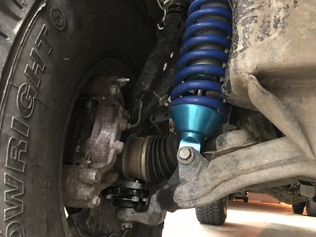

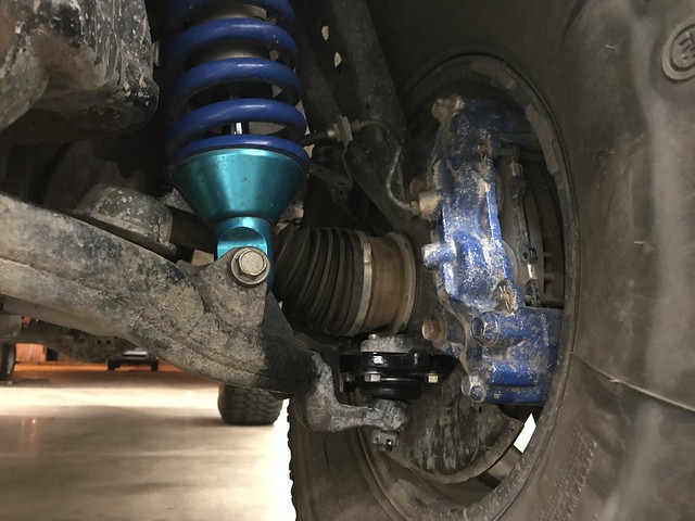

I replaced the upper and lower ball joints on both sides as mine had started to get some play. I also replaced the spherical bearings on both of my Kings as they also had some play and were squeaking terribly. Also the Ujoint that i threw in while in moab gave out. Sounds about right for Moog.
Here is photos of that mess.
Ran out of black paint so I colormatched it to my wheels... whoops. RICERAF

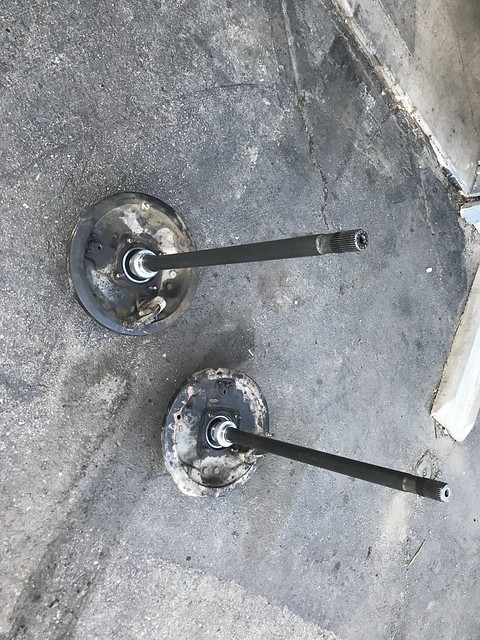

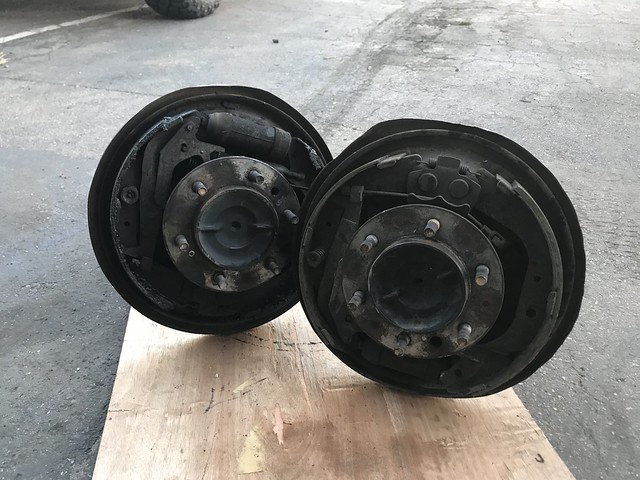

Well on upon my return I immediately ripped my rear axle apart because I had nasty vibrations when turning to the right. Left rear wheel bearing was FU&%^D
<a data-flickr-embed="true" href="https://www.flickr.com/photos/140899154@N02/48867078476/in/datetaken/" title="Untitled"><img src="https://live.staticflickr.com/31337/48867078476_b28609a991_b.jpg" width="1024" height="576" alt="Untitled"></a><script async src="//embedr.flickr.com/assets/client-code.js" charset="utf-8"></script>
So both my rear hubs are at a machine shop getting new bearings and outer wheel seal. I'll be replacing all the rear brake components and the inner seals. It should be good to go for a while. Off to Moab this weekend and the following weekend as well for Rock Therapy.

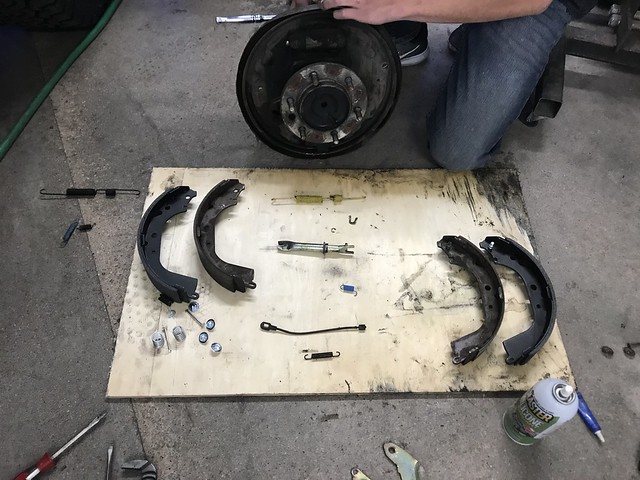

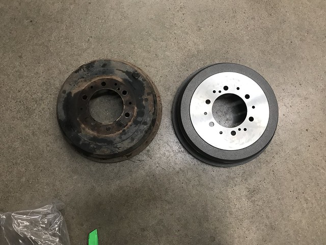

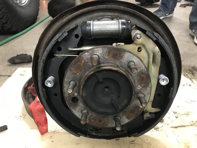

Got my wheel bearings all did up. New bearings and outer wheel seals on both sides.
I then decided while its all out I would do a total drum brake overhaul being it has never been done so I replaced everything that I could.
Before:
After:
Pretty Easy, I referenced some Timmy the Toolman of course.
Heres some mid fix photos.
I also did new drums.

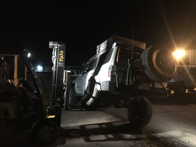

It is fresh, to say the least. I also now have access to a forklift so naturally...

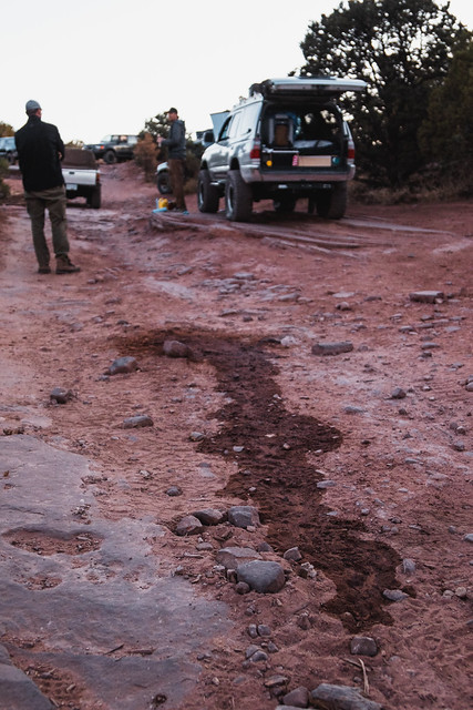

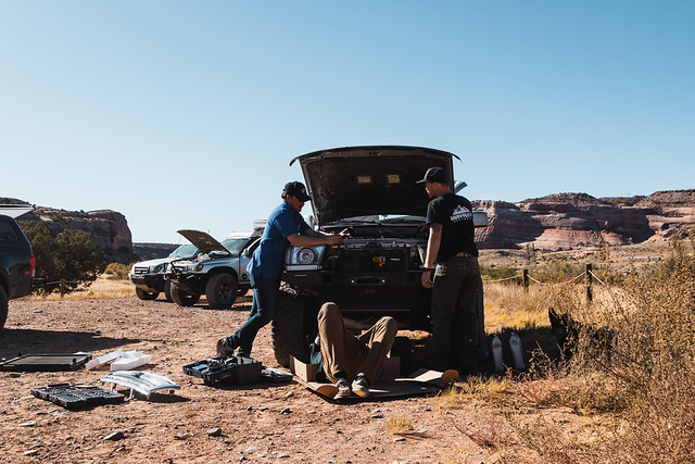

Unfortunatly, Addison cracked a rock pretty good and it managed to crack the radiator. I know the feeling all to well.
No bigee. Nate also did some winching on the Taco.
