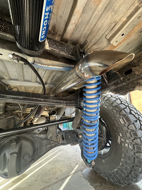

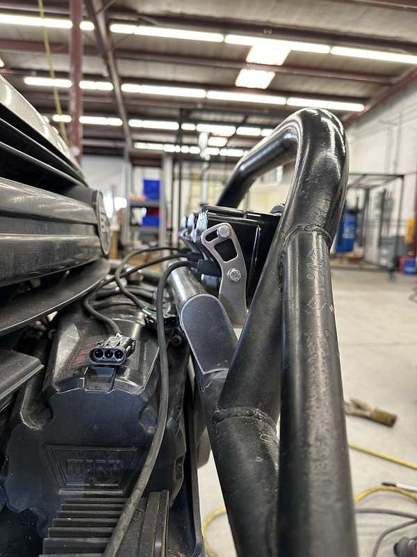

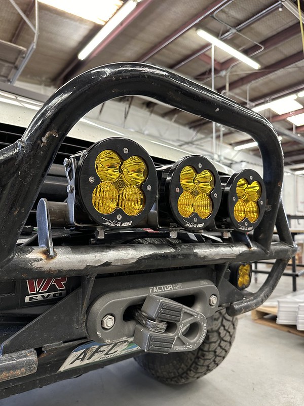

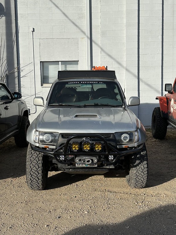

Threw together a quick mount for some XL80Rs on the bumper and also swapped out the Squadron Sports with SAE's. The main reason was to get some light above the super crisp cutoff on the projectors. Without any light bleed on super dark roads, anything above the cutoff was just pitch black. The SAE's have helped a TON.
The 4Runner is out ripping around these days.

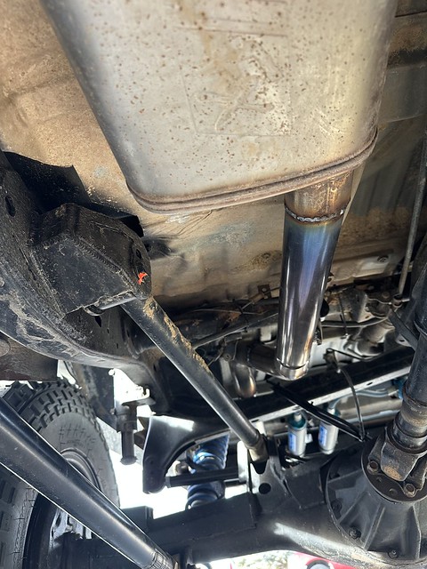

Caught up on some much-needed maintenance, and finalized the exhaust reroute after the 3 link also.
