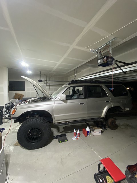

The front is all buttoned up and the rear diff shows up today. The new wheel and tire combo is also looking amazing! Stoked to get it out and wheel this weekend!
Also, the bumper is going to be a fun project. I think I have to push it off till after Moab sadly.

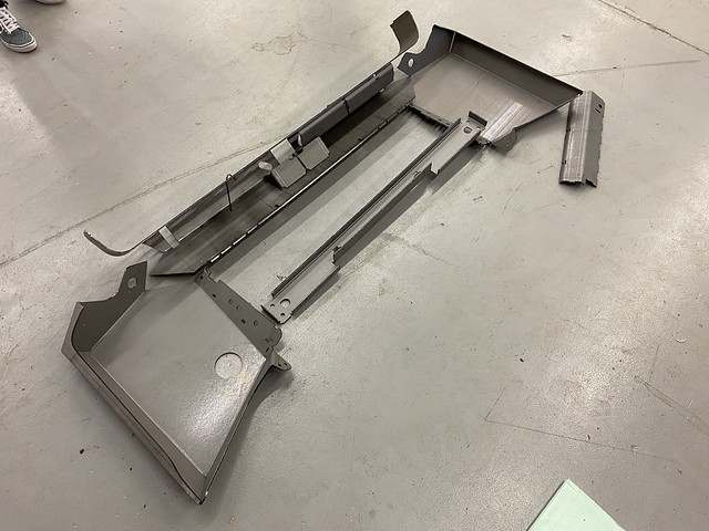

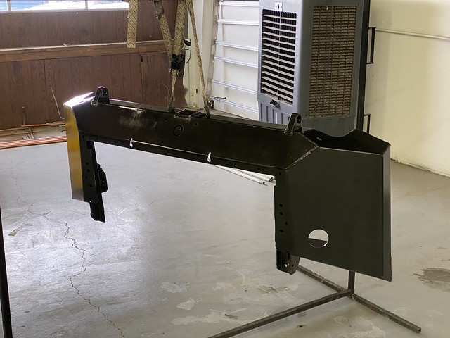

Eimkeith Bumper
I finally glued the Eimkeith Bumper together and got it installed on the truck. I just need to time to paint it. I have 5 cans of SteelIt for it. I powder coated my last bumper and it touches up terribly so opting for a high-quality finish/coating that's easy to clean up during the off-season.
As always, another amazing product from Eimkeith. Stellar fitment even on my bent frame. The bumper gap is caused by my after-market rear body mounts being a 1/2 taller than factory.
I also installed a new axle shaft,bearing, seals etc to hopefully put this whole axle seal leak issue behind me.

Ready for Paint, just need time and motivation to do that.

Bumper looks wicked too - did you install the wing braces? I see some heat marks on yours so I'm thinking you did. They weren't a thing when my bumper got built, but I wonder if I should go through the hassle of putting them in.

I did put them in. I did not however put the swingout braces in. They were designed for the BL version and I don't plan to run a swing out. So I skipped them. I did trim the wing braces a bit to make install easier as they like to get hung up on the rear body mounts as the bumper pivots into place.

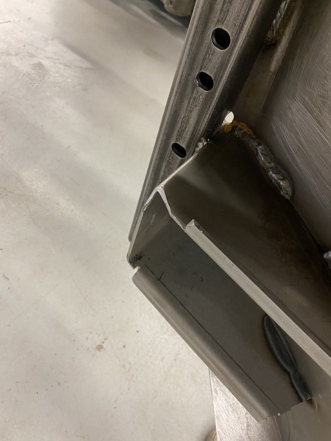

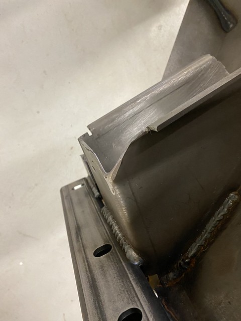

They've got a curved notch in them as a trim line - just cut up to that notch and then they fit the NBL setup. :)
I definitely want pictures of that - so I can modify the future production parts accordingly, and advise the guys that are doing installs at the moment!
I'll grab photos! I was also installing it solo with help from a forklift so I am sure with two people it would be easier but nonetheless, it made it easier trimmed.

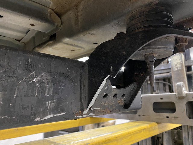

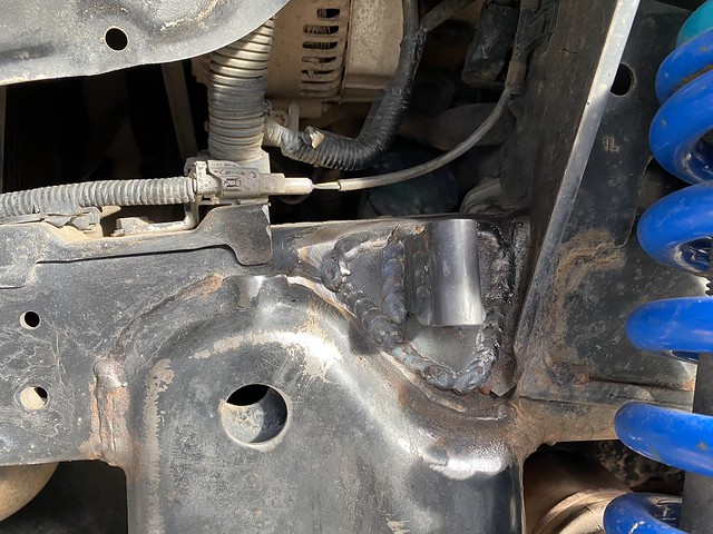

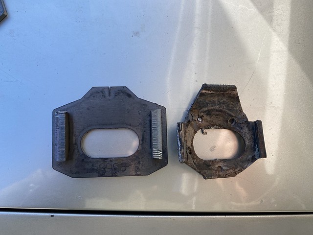

Cam Tabs and Limit Straps
Put a little work in on the truck over the weekend.
On today's episode of installing parts I have had laying around for months.

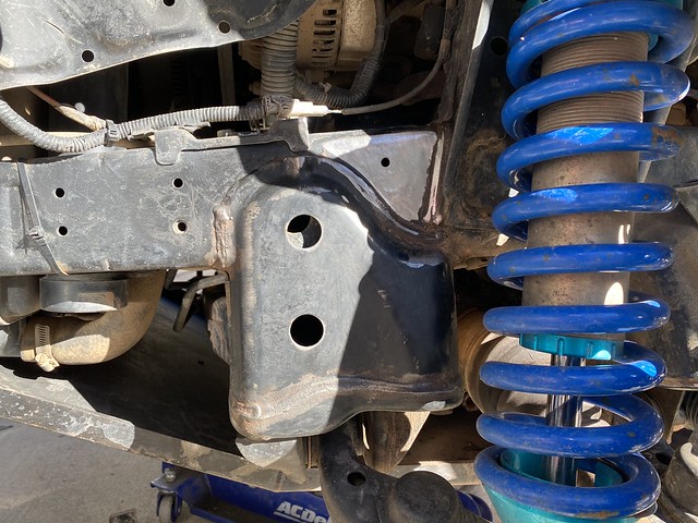

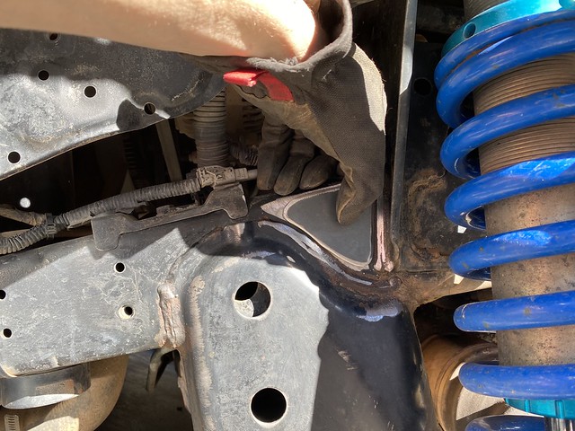

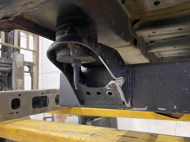

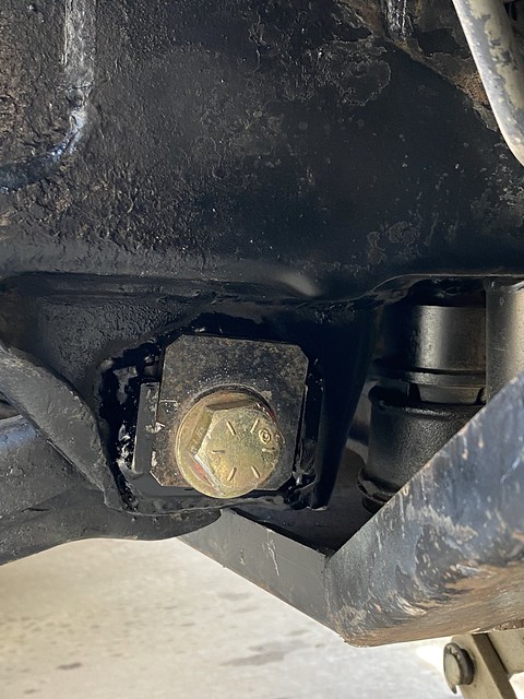

Total Chaos Cam Tabs which I had on the back burner until I needed them. Folded over two tabs in Moab after smashing a beauty of a hole at 40mph. My racing instinct kicked in and I took the APEX in the dark a little hot.
Untitled by alex fleming, on Flickr
Regardless, here is the fix!
Cam tabs suck to install so be prepared on that one. Not hard, just annoying the entire time.

Limit straps are cake, Cam Tabs are not. I highly recommend an air hammer for knocking these suckers off.
Here is what I cut.
