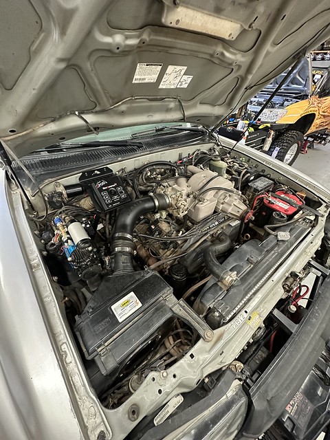

I finally got the supercharger installed. I had the broken ear welded and I resurfaced it filling any imperfections with jb weld and it seems to be working just fine!
<a data-flickr-embed="true" href="https://www.flickr.com/photos/140899154@N02/52417290537/in/photostream/" title="68685543022__9C1B3ED9-73B1-4C22-A53D-3D073E21736E"><img src="https://live.staticflickr.com/65535/52417290537_9a7294a7c4_z.jpg" width="480" height="640" alt="68685543022__9C1B3ED9-73B1-4C22-A53D-3D073E21736E"></a><script async src="//embedr.flickr.com/assets/client-code.js" charset="utf-8"></script>
I Jb Welded the seam of the weld and then sanded it all down smooth before installation.
<a data-flickr-embed="true" href="https://www.flickr.com/photos/140899154@N02/52418319843/in/dateposted/" title="IMG_9459"><img src="https://live.staticflickr.com/65535/52418319843_8f89c4566e_z.jpg" width="480" height="640" alt="IMG_9459"></a><script async src="//embedr.flickr.com/assets/client-code.js" charset="utf-8"></script>
<a data-flickr-embed="true" href="https://www.flickr.com/photos/140899154@N02/52417809186/in/dateposted/" title="IMG_9464"><img src="https://live.staticflickr.com/65535/52417809186_620217dff8_z.jpg" width="640" height="480" alt="IMG_9464"></a><script async src="//embedr.flickr.com/assets/client-code.js" charset="utf-8"></script>
Here is the vaccum line layout for the 1st Gen 3.4 Supercharger, mine ended up slightly different but it all seems to be working correctly.
<a data-flickr-embed="true" href="https://www.flickr.com/photos/140899154@N02/52418242390/in/dateposted/" title="IMG_9462"><img src="https://live.staticflickr.com/65535/52418242390_310f7211aa_z.jpg" width="639" height="462" alt="IMG_9462"></a><script async src="//embedr.flickr.com/assets/client-code.js" charset="utf-8"></script>
<a data-flickr-embed="true" href="https://www.flickr.com/photos/140899154@N02/52417291022/in/dateposted/" title="IMG_9476"><img src="https://live.staticflickr.com/65535/52417291022_7beb03ac0d_z.jpg" width="480" height="640" alt="IMG_9476"></a><script async src="//embedr.flickr.com/assets/client-code.js" charset="utf-8"></script>

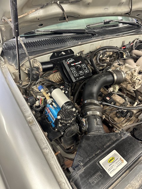

Also, 7th Injector with IAC Calibrator installed, I made a bracket for this and just mounted it below the AC Blower and it bolts to the 2 bolts next to the glovebox screw.
<a data-flickr-embed="true" href="https://www.flickr.com/photos/140899154@N02/52417802606/in/dateposted/" title="IMG_9465"><img src="https://live.staticflickr.com/65535/52417802606_b322cd9024_z.jpg" width="480" height="640" alt="IMG_9465"></a><script async src="//embedr.flickr.com/assets/client-code.js" charset="utf-8"></script>
Well here it is.
<a data-flickr-embed="true" href="https://www.flickr.com/photos/140899154@N02/52417290882/in/photostream/" title="IMG_9466"><img src="https://live.staticflickr.com/31337/52417290882_cd06784704_z.jpg" width="360" height="640" alt="IMG_9466"></a><script async src="//embedr.flickr.com/assets/client-code.js" charset="utf-8"></script>
<a data-flickr-embed="true" href="https://www.flickr.com/photos/140899154@N02/52417803481/in/dateposted/" title="IMG_9480"><img src="https://live.staticflickr.com/31337/52417803481_7493384da0_z.jpg" width="640" height="360" alt="IMG_9480"></a><script async src="//embedr.flickr.com/assets/client-code.js" charset="utf-8"></script>
Thoughts on how it feels with the supercharger?
It definitely feels much better, especially city driving. It gets up and goes much easier from a stop, and also its been way better at holding speeds on hills without downshifting.
It is still learning and each day and its driving better and better but I have only put about 100 miles on it so far. We will see what a little more time brings.
I certainly wouldn't spend retail on a supercharger but if you find a good deal like I did its totally worth it.
All in I think I have spent around $1,400 which is an insane deal so I am very happy.

So far, even putting my foot into it a bit becuase its really hard not too, I am seeing around 15-16 city which is comparable to before. I havent ran highway much with it yet but the couple times I have I was seeing 17-19mpg averaging 70.
All very likely to be skewed as I have only about 200 miles on the truck since the install.

The Supercharger is 100% worth doing if you get a good deal on it. Especially if you plan to run stock pulleys and enjoy the sounds and increased driveability of the truck.
I kind of dove off the deeper end of things adding the 7th Injector and a smaller pulley. It has been WAY more fun to drive the truck but I'm just now finally going down the rabbit hole of tuning the truck to solve some pinging issues. I finally got an AFR gauge installed and realized I've been running lean and there is a lot of room for improvement.
As far as reliability goes it's hard to say, it's so dependent on how you drive the truck, I beat the crap out of the truck when I use it. It's a toy for me so I don't take it easy, so I am constantly having to do maintenance, fixes/ upgrades. That said I don't think the supercharger has or will change that by any means. It will likely decrease the life of my already old engine but I don't mind doing a full rebuild or swapping in a low miles 3.4 when that time comes.
Premium is fine, I'm used to filling up a Diesel with 30 gallons on a regular basis so a full tank of premium on the 4Runner is still a pleasant hit to the wallet in comparison. Fuel economy is nearly identical too without a supercharger for normal driving and on highways it is marginally better. It's much easier to maintain speed at lower RPMs and generally requires less foot to keep it moving. On my last road trip with the truck which was about 1200 miles, with lots of wheeling, mountain passes, and dirt roads I averaged 16.5mpg.(Full camping gear, passenger, dog, and rooftop tent) Averaging 65-70 on the highway sections. I really do think so much of it comes down to driving style and the Supercharger makes it way easier to have some fun and burn some fuel so if you drive like normal I believe it helps.
I would absolutely do it again for what I have invested, that said I would not spend over $3k on it. If I was to drop $3k+ it would be on a turbo setup because... whoosh whoosh, pshhh, pshhh is pretty damn cool.

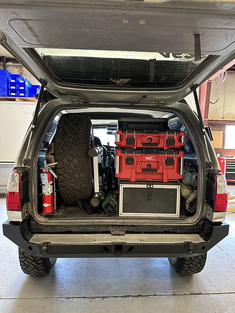

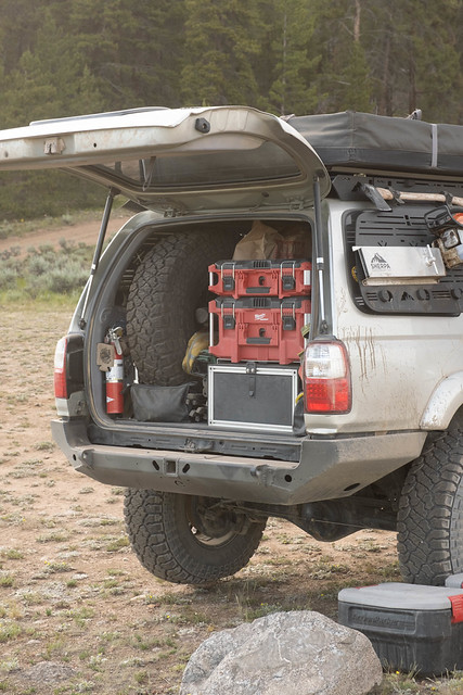

I run a spare in the back of the truck! It's absolutely terrible for space efficiency but I much prefer not having a swing out, I ran one for years but it was getting hung up on everything.
The mount is from Bell Fabrication and it works awesome.

Thanks for sharing the photo of your cargo and spare tire setup. Pretty cool.
I'm in the trunk so often, I'm a little concerned how much of a hassle the swing out might be. I find your perspective interesting as you have obviously ran both setups.

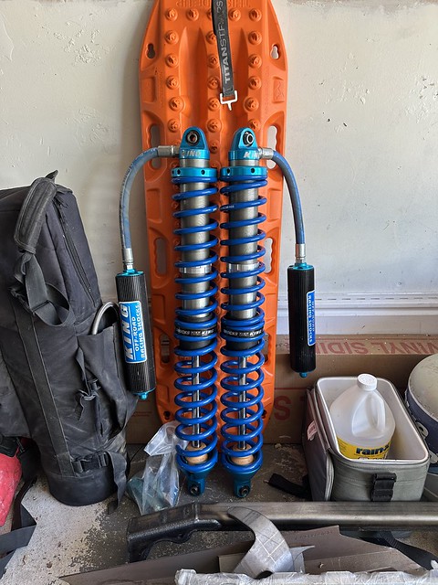

Well, I left that hint above and have started the project now that I have a little bit of time to work on the 4Runner.
I am installing a Freelgood Performance LT3 3 Link Kit, 4Wheel Underground Underbed Coilover Mounts, King 2.5x12" Coilovers, and Icon 2x2.5" Hydro Bumps.
<a data-flickr-embed="true" href="https://www.flickr.com/photos/140899154@N02/53376130236/in/datetaken/" title="Untitled"><img src="https://live.staticflickr.com/65535/53376130236_4d446524f4_c.jpg" width="800" height="600" alt="Untitled"/></a><script async src="//embedr.flickr.com/assets/client-code.js" charset="utf-8"></script>
With that, I am also trussing the rear axle so it doesn't turn into a smiley face with the increased capability of the rear suspension. I'm using a top truss from Ruffstuff for a Ford 9" and modifying it.
Here is the progress so far! A lot of cutting, grinding, measuring, and more measuring.

I thought for sure those Kings were for a 3 linked front, but this is cool too.
I'm real interested to see how this thing does with that new setup. Post more pics.
