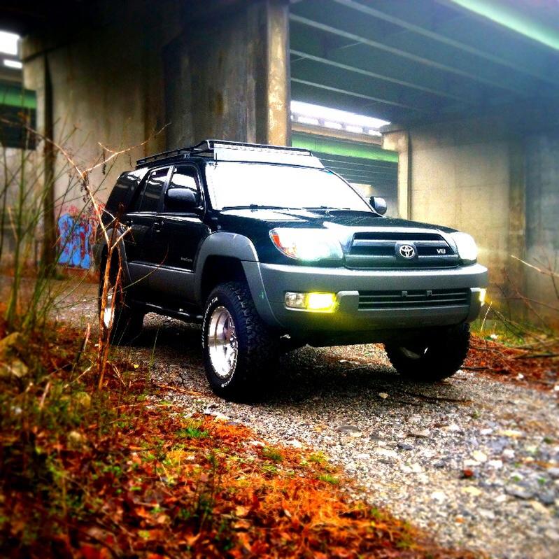

I have been meaning to post what i ended up going with but was wanting to get some decent pics. I ended up going with TRS bulbs in the headlights and fogs. The fogs got the 3000 ambers. I have really been enjoying them especially with all the bad weather we have had. Wish my real camera would have been in the truck this morning.
