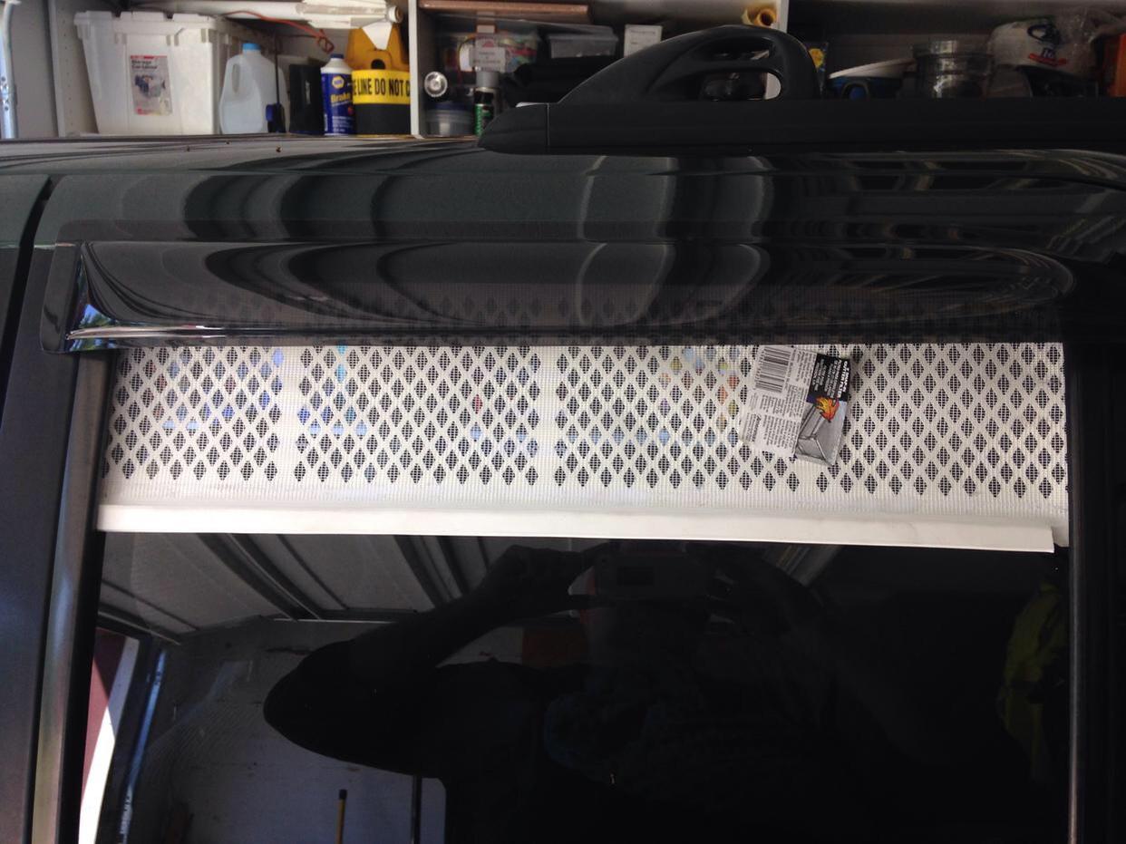

Here's a little something I did, it's a screen for the gutters on a house.
Check out "My 4 dollar window screen" for more info
