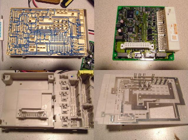

After restoring power have you noticed that a few things don't work initially, like the rear wiper and the rear hatch lock mechanism? Using the transmitter to cycle the door locks restored rear hatch operation and rolling the rear window down and back up made the rear wiper work again. Is this in the service manual somewhere? I just spent the last several hours tearing my fuse block apart trying to fix the "problem" with my rear wiper, only to realize I was the only problem. Oh well, at least I have some super exciting pictures of my fuse block now...

Thanks for the pics. Now I can say 'Thats what that looks like!'

Why would you disassemble your fuse block? Wouldn't the dealership be the place to go for a fix in the event of an electrical malfunction in a vehicle still under warranty?
What if you broke part of it? How expensive is a fuse block? Or the PCB in the pic?
You are to adventurous...Better get some leggos or something;):
Re: Just wondering
The Body ECU / fuseblock is where the problem appeared to be. As for the dealership, only as a last option. After the "alignment job" they did, I'll do anything to keep them away from my 4Runner.
Me? Break stuff? Sure it's possible, I guess I'm just willing to take the risk. I'm sure getting a new one would be quite expensive so hopefully I could have pulled one from a junkyard or something.
Too adventurous? Heh, that was nothing!!! :D
