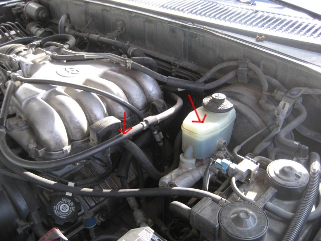

Ill take a picture of the brake booster line tomorrow and post it. But, if you look at the back right of the engine bay, at the brake master cylinder. See the black circular thing sitting behind the master cylinder? Follow the hose that runs from there to the right side of the engine. thats the brake booster vacuum intake. Ill post a picture tomorrow in the daylight to be a little more clear

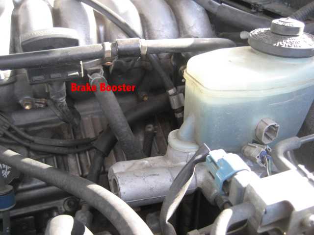

as promised.. here are some pictures of the brake booster vacuum line location. better late than never...

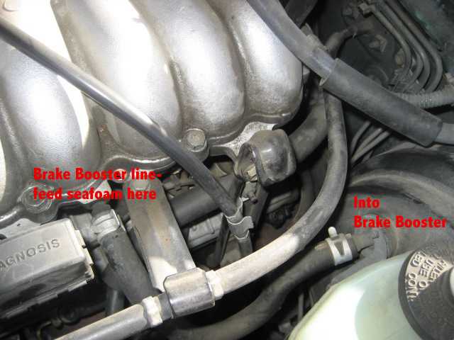

last one. feed the seafoam into the engine side of the hose (just to be reallllly clear, and not trying to insult anyone's intelligence)
