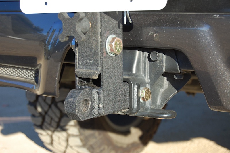

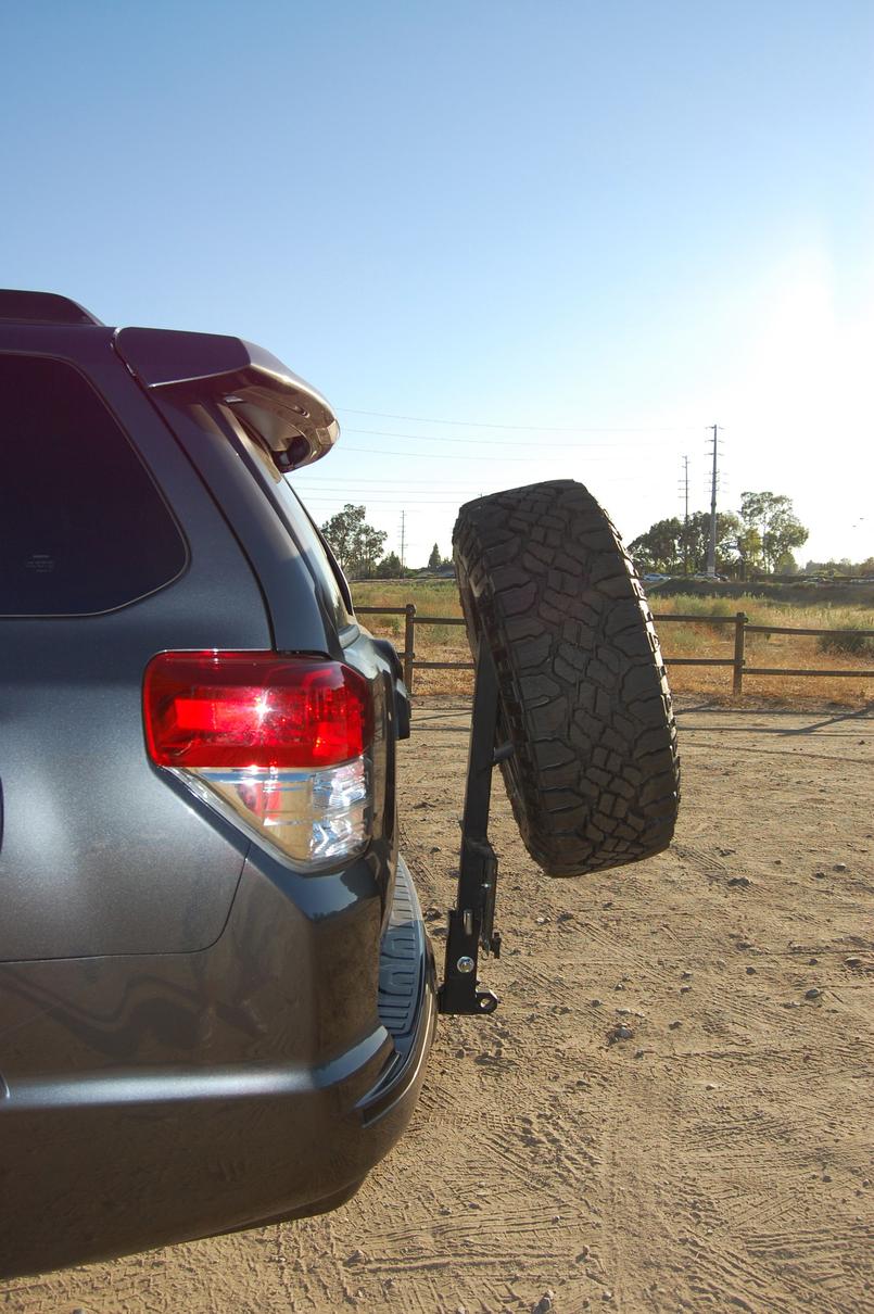

Rear tire carrier update....
After almost a couple months since receiving my tire carrier and taking it offroad a few times it has and will continue to serve me well for what I wanted. However, as Seattlemike eluded to, I also felt the tire was too far away from the body of the truck so CBI fabricated a new bottom piece to ensure I was satisfied with their product.
Basically, they shaved off 2-3" lengthwise of the bottom piece bringing the rear of the vertical arm closer to the truck by the same distance. It looks much better than before but will never be as close to the body of the truck as having a new rear bumper with integrated tire carrier. They also removed the pass-through receiver portion but I asked them to include a tab so I can attach my 3/4" clevis shackle for recovery purposes. The new piece did not affect the fold-down ability of the rear tire carrier.
I'm happy they continued to work with me to give me exactly what I wanted. Here's a couple pics of the new setup.

Looks great!!!
Good for you to take this on and have something made that fits your needs so well. I am sure that many people will be following in your footsteps. This is the most practical solution I have seen for a full size tire carrier without the need of an aftermarket bumper.

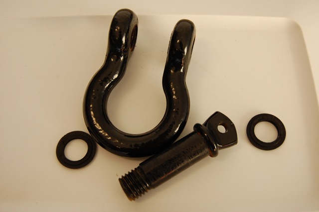

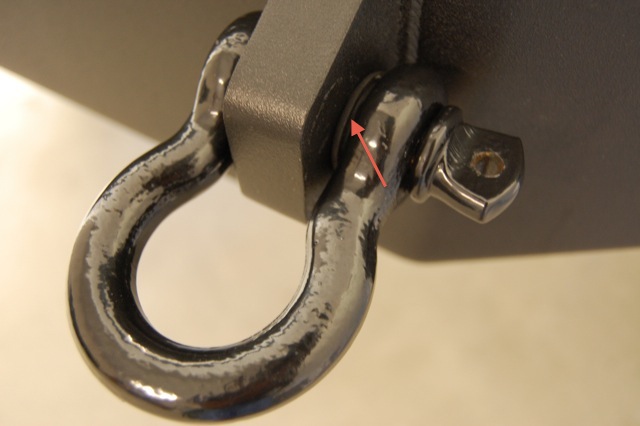

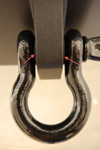

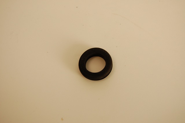

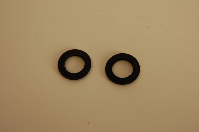

Shrockworks Front Bumper Mod
I made a minor modification to the 1" thick tabs for the D-ring shackles because they made clanking noises. Maybe the shackles offered by Shrockworks don't clank around but I got my shackles for much cheaper than they were selling them.
For this mod I purchased 3/4" neoprene grommets from Home Depot and sliced it in half. Place one half on each side of the 1" tab on the bumper and slide the D-ring over the grommet (this takes a little patience to line it up right). The arrows are pointing at the grommets. Once lined up, screw the pin in (will be a little tight) and voila.....zero clanking noise!
I did this mod back in Nov 2011 a couple a days after I installed the bumper and have been very happy with the clank free result. I wanted to post this up back then but have been extremely busy with work and life. After this minor mod, I made the biggest and best mod for my truck I will ever make......my wife and I purchased a brand new home!!! Now I have a garage to park my truck in and keep it safe (yes, it fits inside even with the snowboard racks on). Suffice to say, most of my modding now will be for my house but I'm glad I got my truck exactly how I want it.....for now :biggrin2:

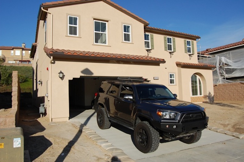

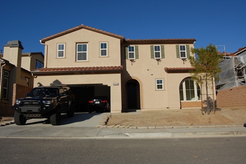

Congrats on home ownership! Your lucky to be able to fit into the garage with your snowboard rack on, I have to mount and dismount mine every time I wanna park my truck in my garage. Small price to pay for the truck to sleep inside. LOL!
