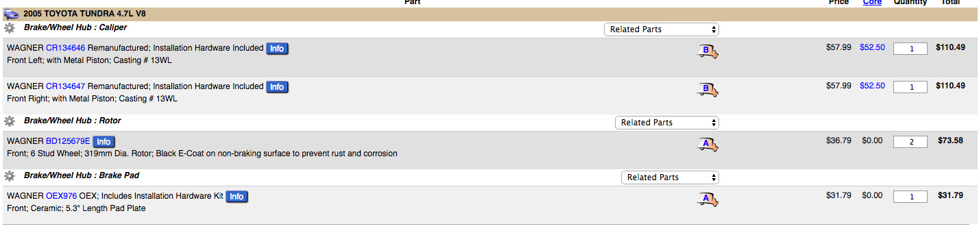

I really wanted to order a lift, but my brakes are already ever so slightly warped, and with me towing a uhaul trailer from Michigan to Arizona in 3 weeks, I figured I better fix the brakes and do it right the first time. Fun stuff can come later.
Got all of this pretty stuff in from Rock Auto today...one day after I ordered it. Good on ya' Rock Auto!
I'm not crazy on the pads, there's a lot of real estate on the backing plate that isn't being used by the pad material, but they're nice ceramic pads that I'll give a shot at.
Tundra brake upgrade and differential breather mod done today.
