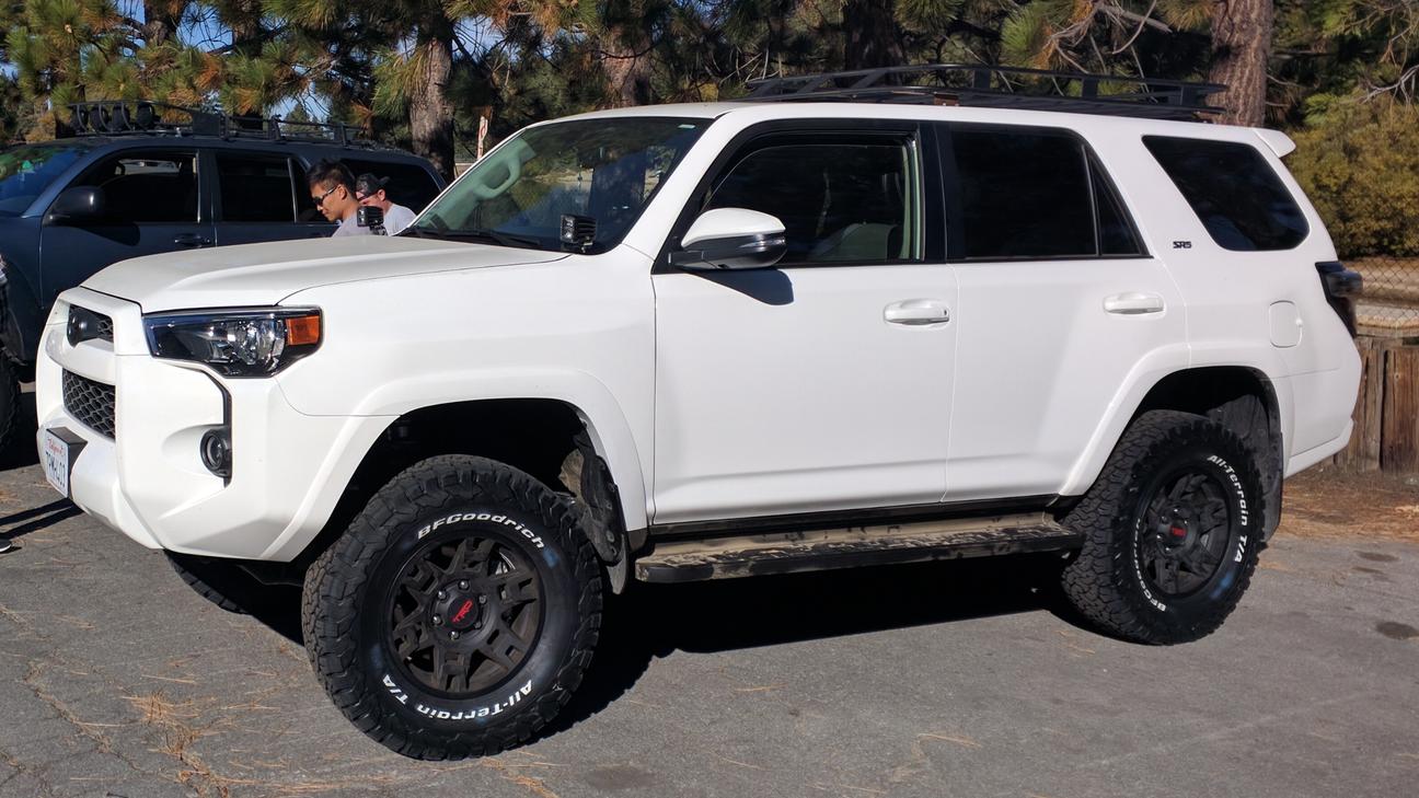

Why not switch out to a 3in rear spring? Its what I am probably going to do since I have a slight reverse rake with a full tank of gas.
Mainly because it's my Daily Driver, and I am getting fairly close to hitting the warning chains at the parking garage at work for the top level parking. Otherwise, would give that some serious consideration. There is no regular parking available unfortunately.
Since the suspension will be out, and in an effort to save time, does turning right raise the truck, and turning left lowers it. Also does adjusting of 1" of thread equal the same change in ride height?
I'd like to avoid adjusting and reinstalling and adjusting and reinstalling.
