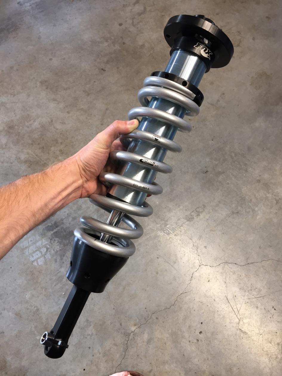

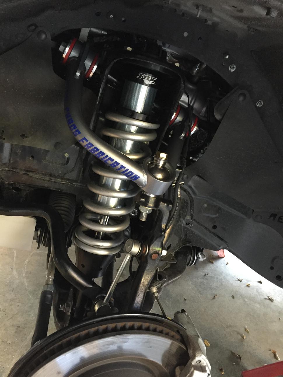

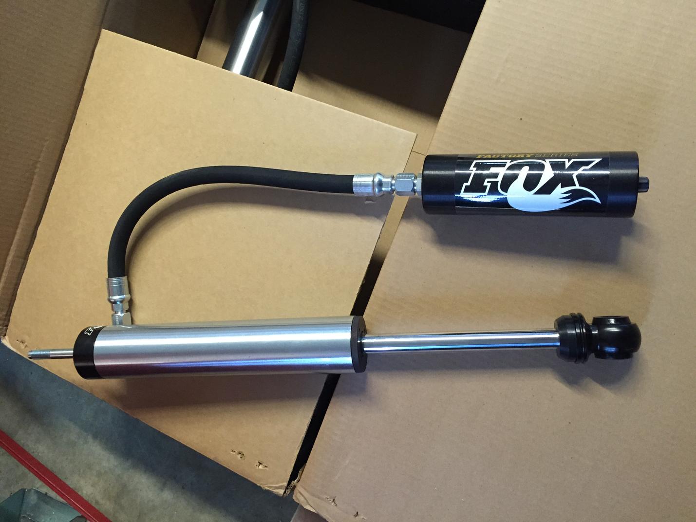

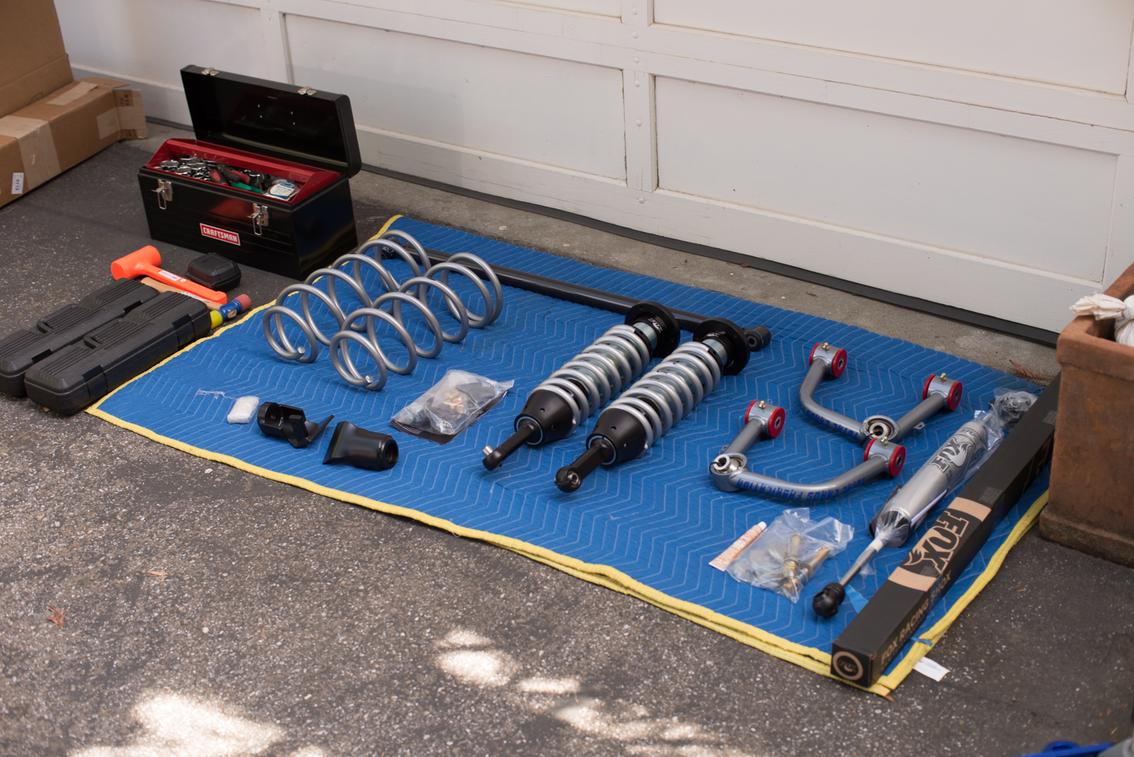

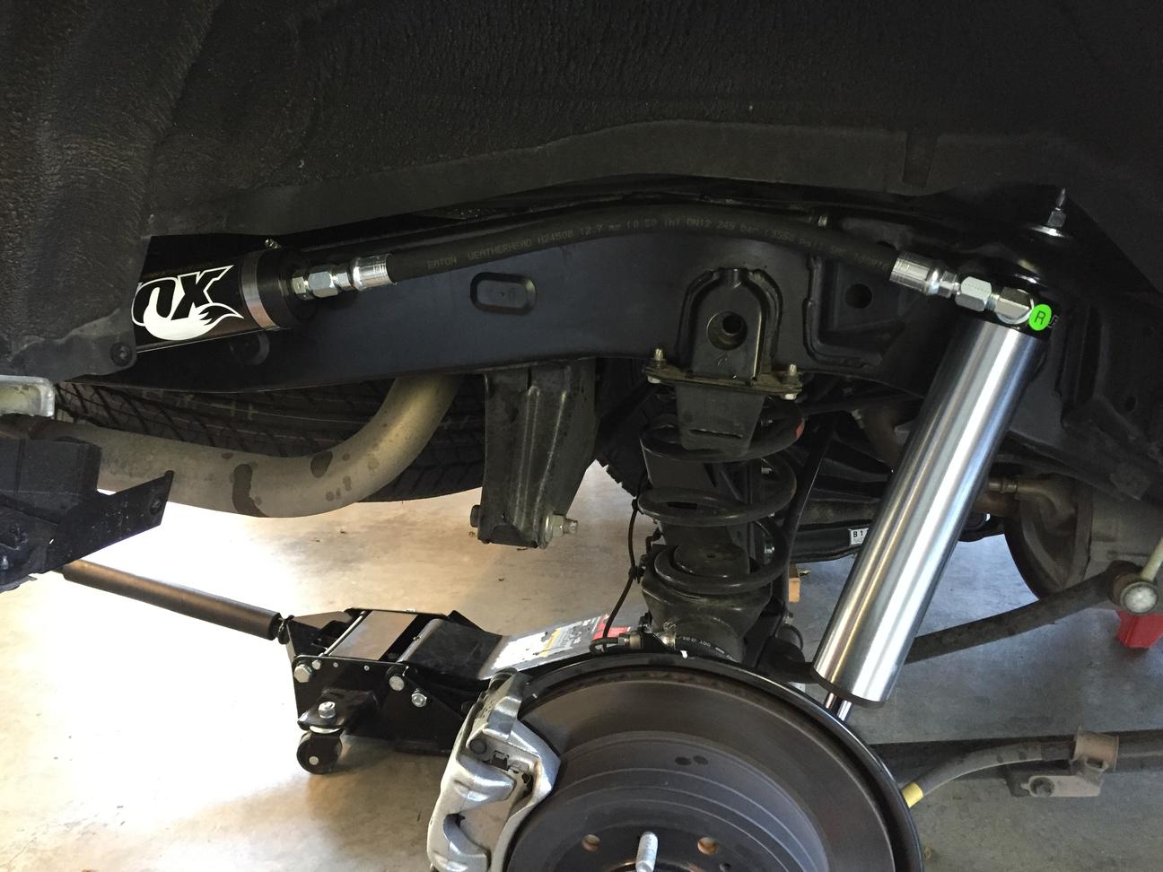

I'm installing my Fox setup later today. I'll report back on my findings.

Well.....? Update please!

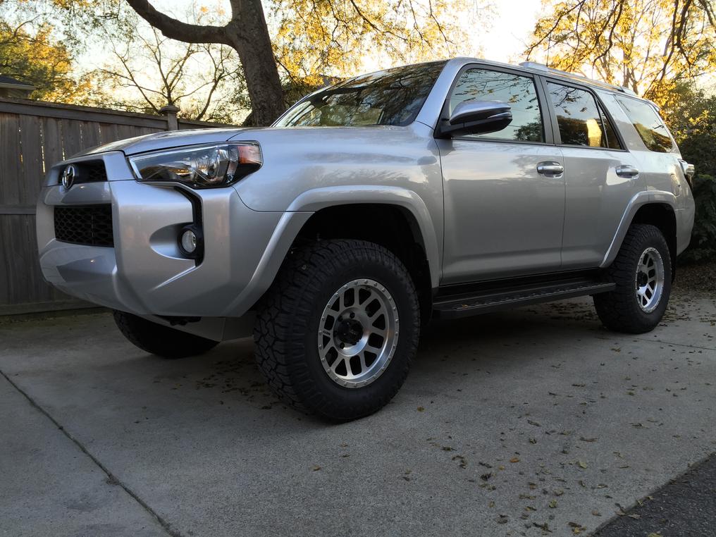

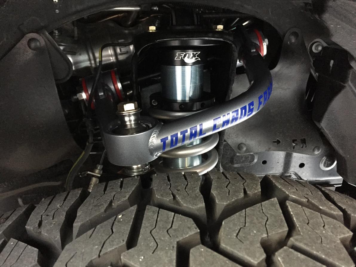

Installed. Install was straightforward. I'm level now, frame to ground.
I haven't had a ton of time to test drive it, but initial impressions from a quick trip are:
-firmer than stock, but not harsh.
-better damping than stock (obviously)
-steering feels improved with more caster
-spring rate is spot on (600#) for my needs

Further impressions:
-brake dive is significantly reduced
-squat (under acceleration, for example) is also reduced
-it feels sportier in every way - handling is improved
-the leveled stance is how they should come from the factory
-Fox's customer service is great, I spent a while on the phone before ordering to ask detailed questions

I stayed with the stock rear springs, and stock sized (265/70) tires. I have no intentions of taller tires, yet.
