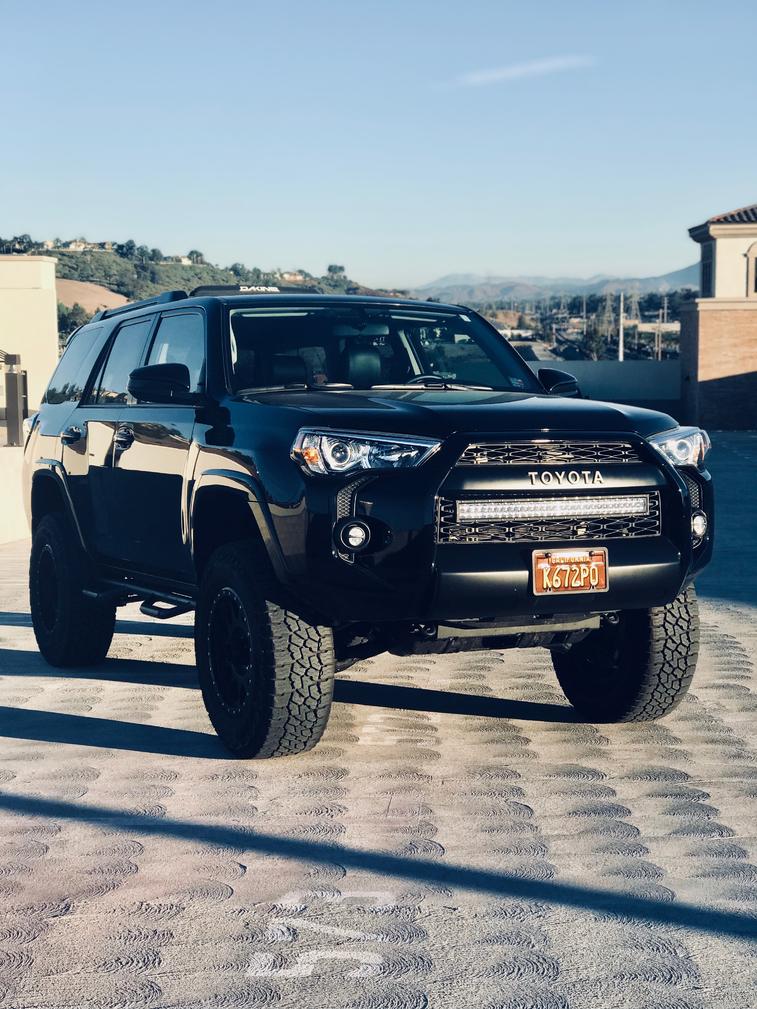

I run fox. Nothing but good things to say so far :dancin:
Beautiful truck! I'm SO tempted by Fox, but I keep hearing about occassional quality control problems, poor customer service, and perhaps a lack of commitment to the truck world (mostly bikes). I don't hear a LOT of that, but as I've been looking for more about Fox, those keep cropping up and it makes me nervous.
OTOH, the rest of what I'm hearing is raving happiness.
What (and how much) kind of off roading do you do?
I have Fox 2.5 resi's front rear with DSC adjusters... I absolutely love them. I've been riding them pretty hard on some desert trails as well as some technical mountain trails. The way my friend explained it to me was the leaders in the Baja are all running fox and kings... Really can't go wrong with either. I too have heard of horror stories with customer service, few QC problems (but I think this has been encountered with many other companies as well.)
