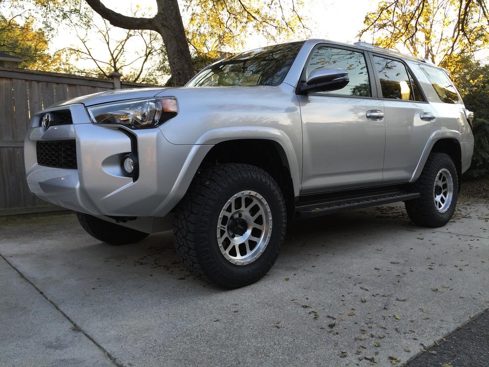

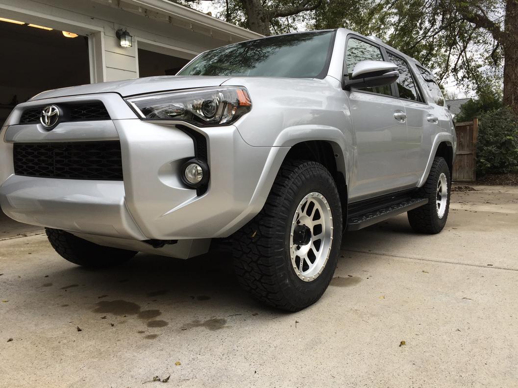

No problem. I installed:
Front: 883-02-025 2.5 Factory Series Coil-Over IFP (extended travel, requires UCAs - I went with Total Chaos)
Rear: 883-24-004 2.5 Factory Series Reservoir
I went by frame rail to ground and it is now level. Off the top of my head - 15 1/4" or so.
Before and after.
Before and after.
Looks great! looks significantly higher..

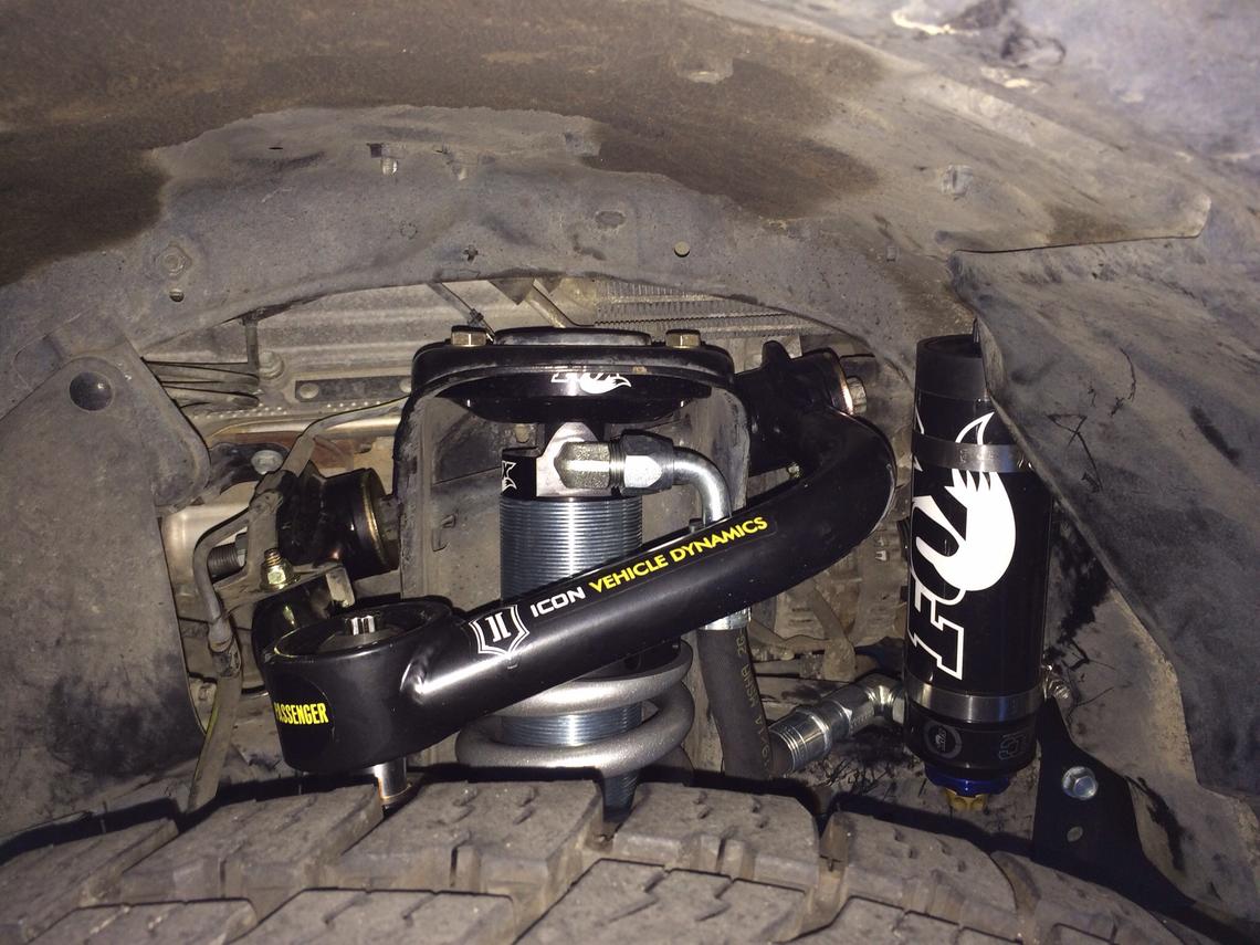

FYI I ordered front CO's only, money I wasn't quite ready to spend yet, so UCA's & rears are in holding pattern till I save some more dough.
Front: 883-06-111 - (1) Pair of 2.5 Factory Series Coil-over Reservoir - Dsc Adjustable (from Toytec)

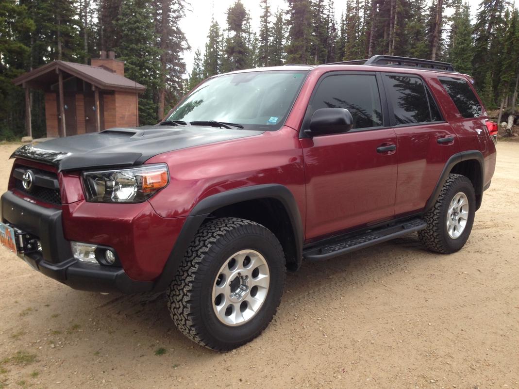

I failed to take a pic before hand, it was sagging though, hand height to the fender, very noticeable negative camber on my wheels :(
Not sure what mine were set to from the factory, when I spoke with Fox about the hose fitting clocking, he said 1", I have got at least another 2.5"+ of threads to go up, there is like 4.5" of threads on those tubes. I suppose i could measure. I Have roughly an extra 250+lbs on the front, winch, winch mount, 31m battery, compressor, sliders, lights.

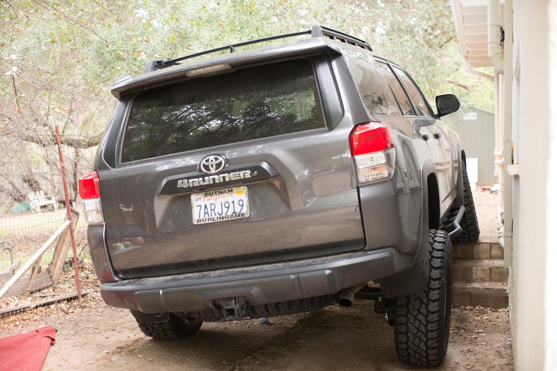

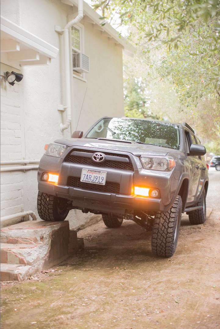

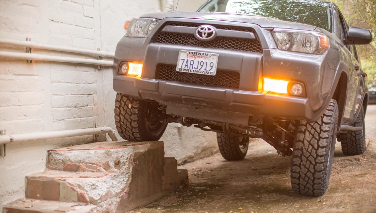

A few flex-shots today while sorting out some rubbing issues with the new tires. 2.5 in the front, 2.0 out back.

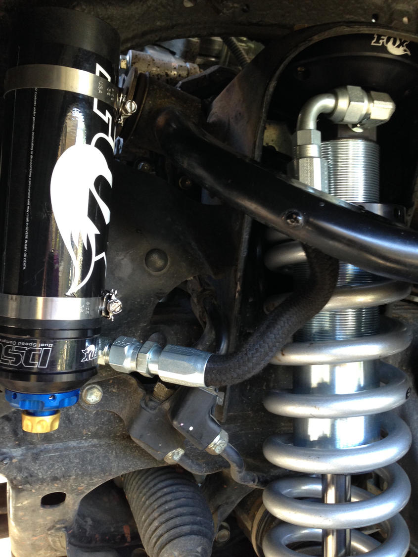

Foxy fronts installed!
I'll have to say, this has been a long time coming. Finally installed Fox 2.5 w/adjustable remote res. super pumped on the ease of install, for the most part. Had some small issues that came up (which just made it custom) I have many thanks to helpful people on this forum. Ladies and gents that had helpful advise for selection and trouble shooting through out my build. Hat off.
May this inspire you to do something fun in your T4R.
