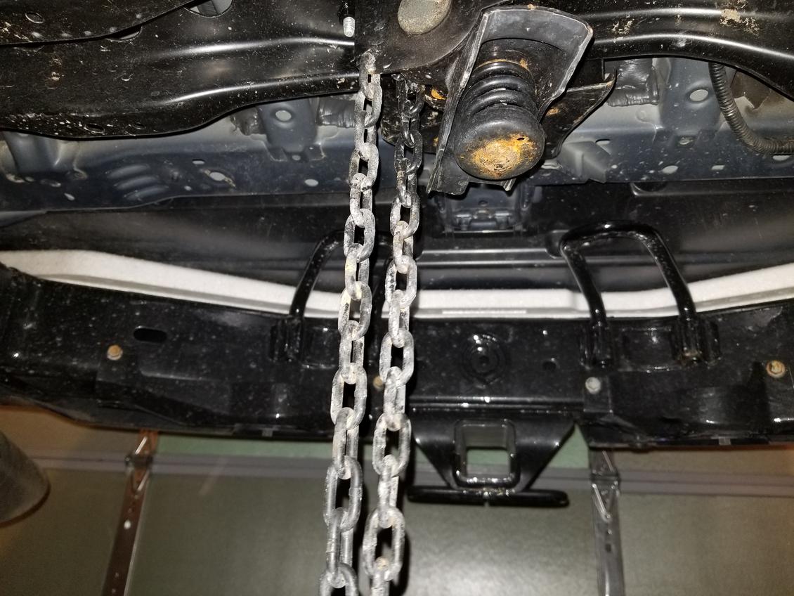

I picked up a 2016 4 weeks ago w/ 25k miles. Rear portion of the frame was already being eaten (I'm in PA). I took the rear bumper off and Por15'd the entire rear portion of the frame using black. I then used clear for touch up treatment along the entire underside. I've got an appointment with Krown in 2 weeks. I use Krown first because for $120 they get inside the body panels using a 360 wand. I then follow up with regular fluid film each year although this time I might just go back to krown.

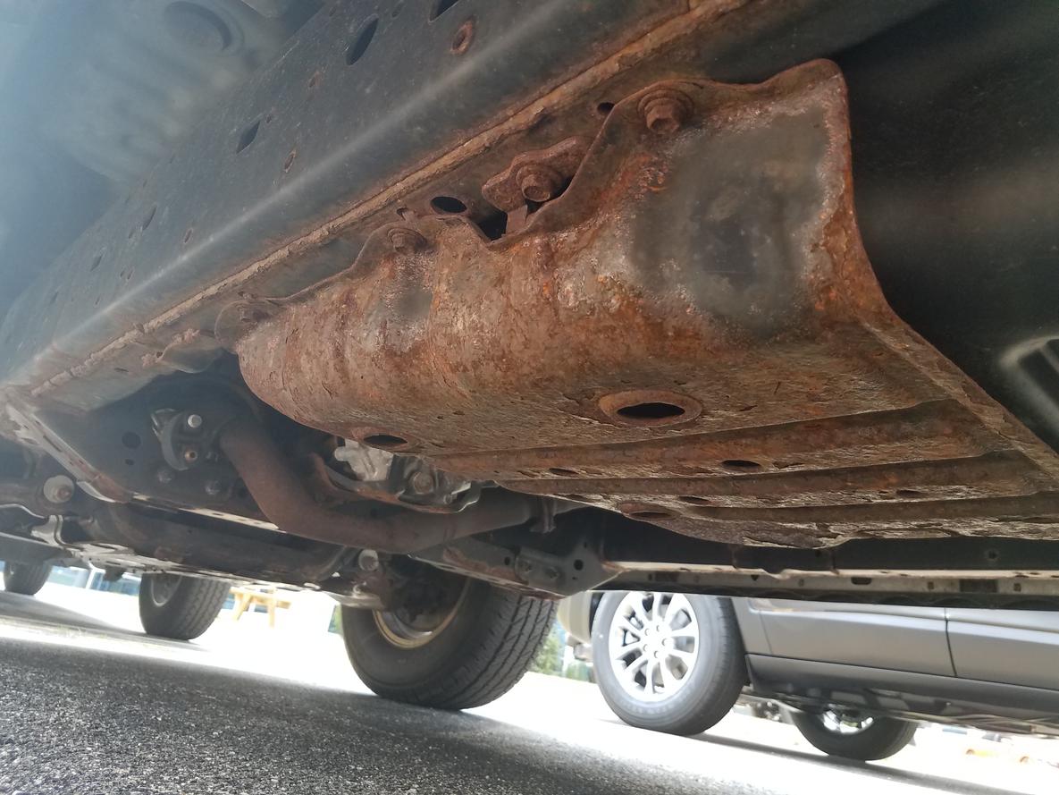

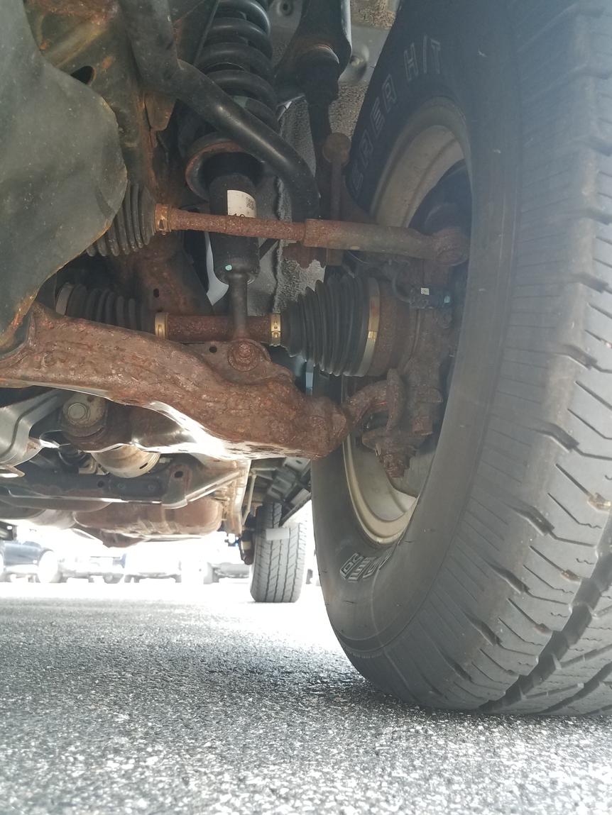

Hey All - We're looking at a used 2010 in WI. Our previous 2001 4runner gave out due to frame rust so we're a bit nervous about what we've seen on a 2010. Can anyone offer an opinion as to whether the rust in the images is typical or concerning to the frame elements of this 5th Gen? Thanks

Um no. Not good. There is clearly pitting on most suspension components and on the bottom edges of the frame. Previous owner must never have rinsed it off during the winter. I would steer clear.
well an 8yr old rust belt truck that is normal rust . probably has 110K miles on it and used in the winter when the snow is on...
before / if you buy it , check for frame rust at the welds that is common ..
the sheet metal covers can be replaced ..

Fly down south and buy a truck from the CA, AZ, NV or somewhere in the South.
