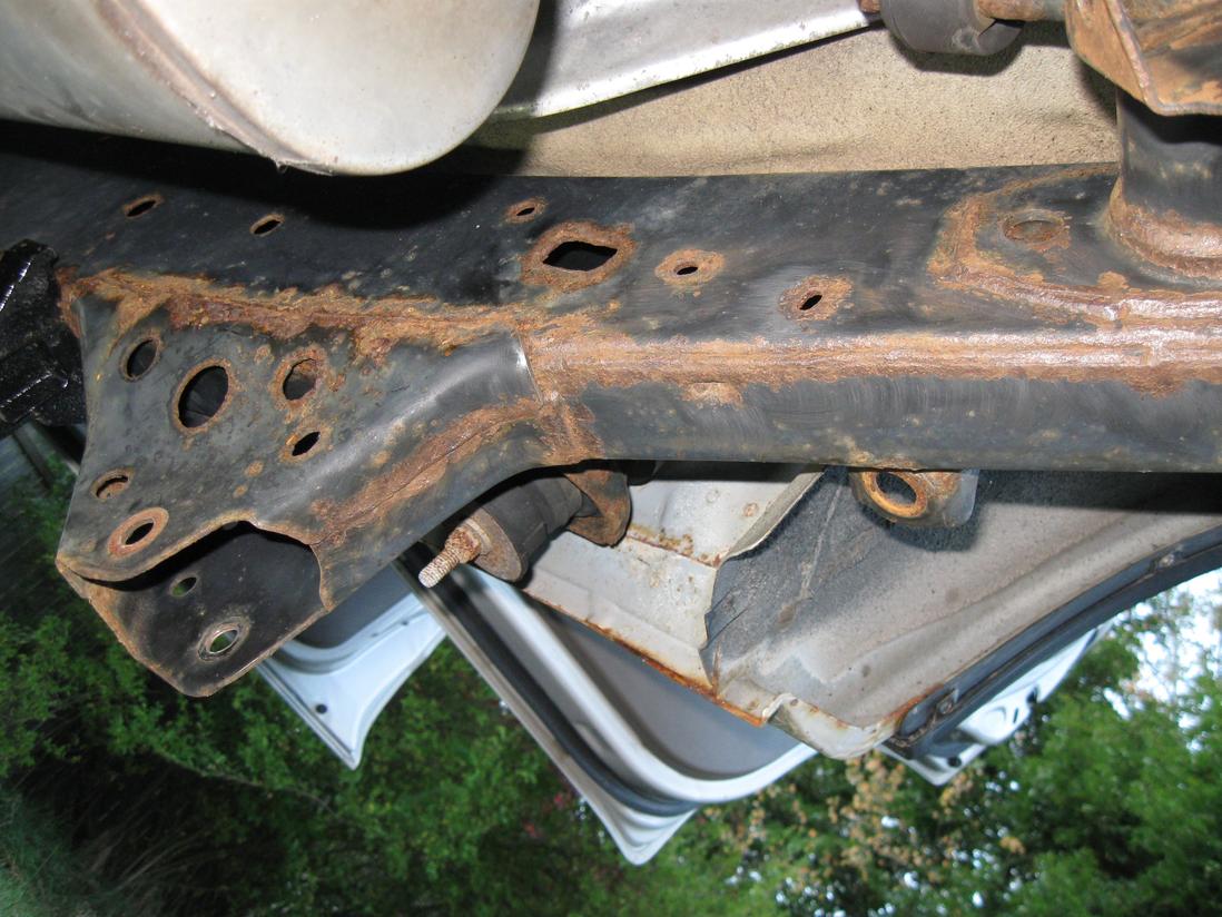

Ok so here are the pics of my "repair".
https://photos.app.goo.gl/OZzVfmBanIZjoIsG3
Just to clarify, I would grade these welds as POOR. The conditions were 20 degrees outside and windy, so the shielding gas was blowing around. I have a cheap borescope and looked in the frame to see all the rot on the inside which is what i cut out. The rest of the frame in that area is solid, but since it is no longer a full box its compromised for sure.
My goal was basically just to get the 1/8 steel welded into the inside then the steel covering so it would pass inspection.
There are signs of the same amount of rust on the there side, behind the gas tank, but you cant "see" any holes so the mechanic said he won't fail it. But i know that side is just as bad. Add in the fact that the rust gets worse when you go back to the spare and the trailer hitch and I think you might agree with my assessment that the frame is not really worth saving.
Again, the welds suck I know. If i were to save the frame i would grind off that outer steel i put on and put heavier steel that was one piece and get a 240v welder to do the job in the spring or summer.

I think the box part is probably ok. I'd be nervous driving around on that control arm bracket, though. If it is like mine, The floor of the box rusts away where you can't see until it pulls right off of there. That's what happened to me. My frame box was in better shape than yours. I don't think those welds of yours are going to hold that thing on for long, especially if you stress it off-road.
It's not fun when that sucker lets go. Ask me how I know. If it does, don't brake, don't accelerate and steer as little as you can. Just let it coast to a stop with light braking.

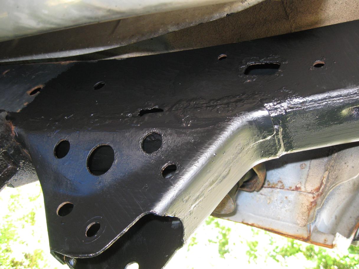

Damn! On both trucks. I'm not driving mine because of this little hole.
When I was wire wheeling it for Eastwoods rust converter, it pushed through. Frame is solid everywhere else including the same area by the gas tank.

Not bad. Now that you have another daily I wouldn't even be in a rush. A tiny hole like that isn't anything dangerous to drive on yet though. Start fluid filming those body crevices though, I see plenty of rust beginning on those areas. And definitely not as easy to repair nicely compared to a frame.

Yeah, your frame is pretty toasted. There isn't much "good" frame left so at this point if you want to keep the truck, I would swap a better frame into it. I am surprised it passed inspection honestly....
I like the idea of buying a decent beater for your long commute while you do the frame swap.
I remember when I first got my 97 and posted pictures on here of the frame. The amount of hysteria over the handful of surface rust areas was unreal. When I see pictures of frame rot like yours, it makes me sleep better at night because mine is no where near that bad. In fact, I don't have a single hole or weak spot anywhere, it just had a bunch of surface rust which is now gone. And yes, I inspected the inside of the frame and it's solid.
