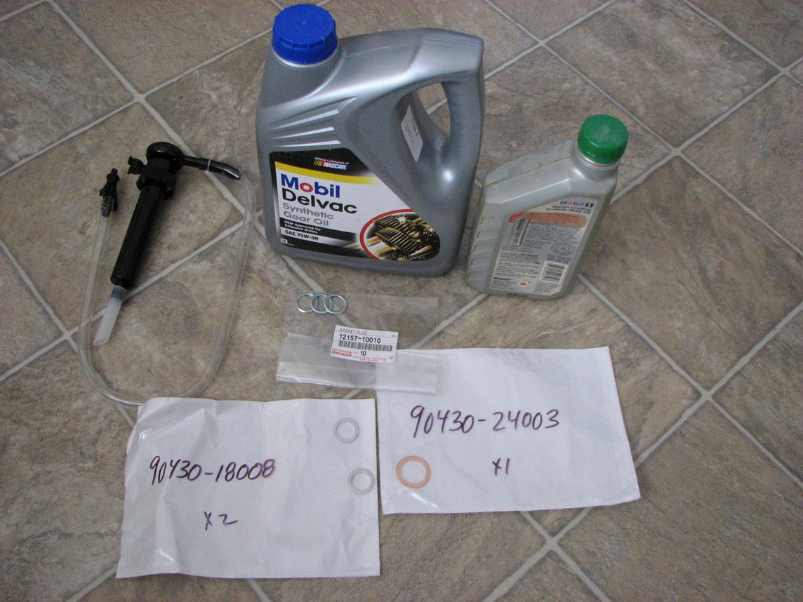

Bump to the front page. Doing my first rear diff fluid change today. Approx 39k miles. The gallon sized pump doesn't fit so I'm using an old M1 Qt sized oil container.

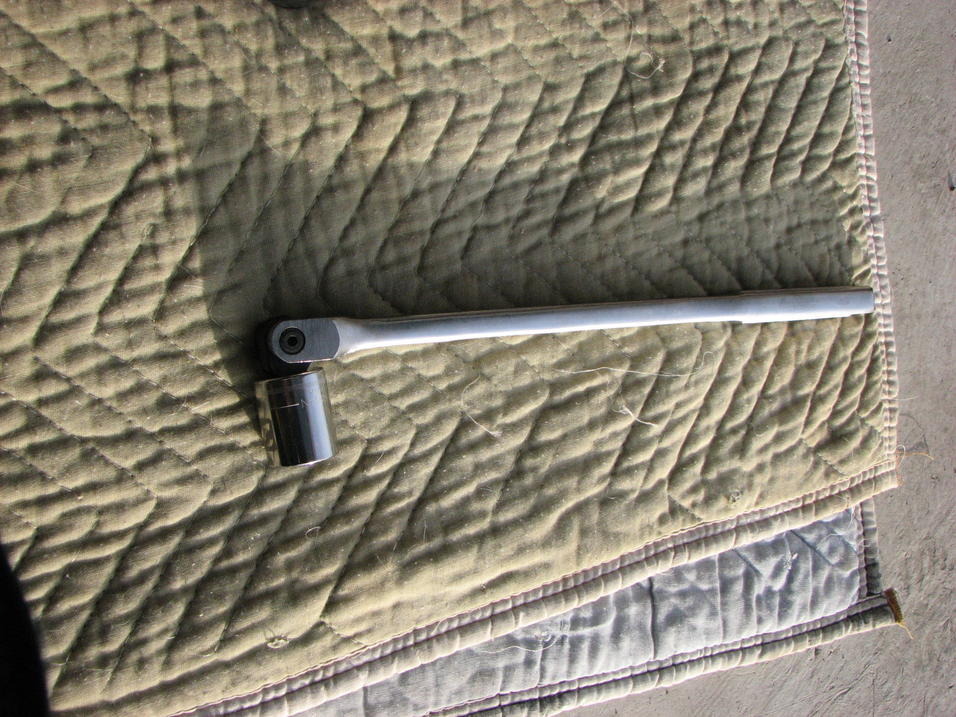

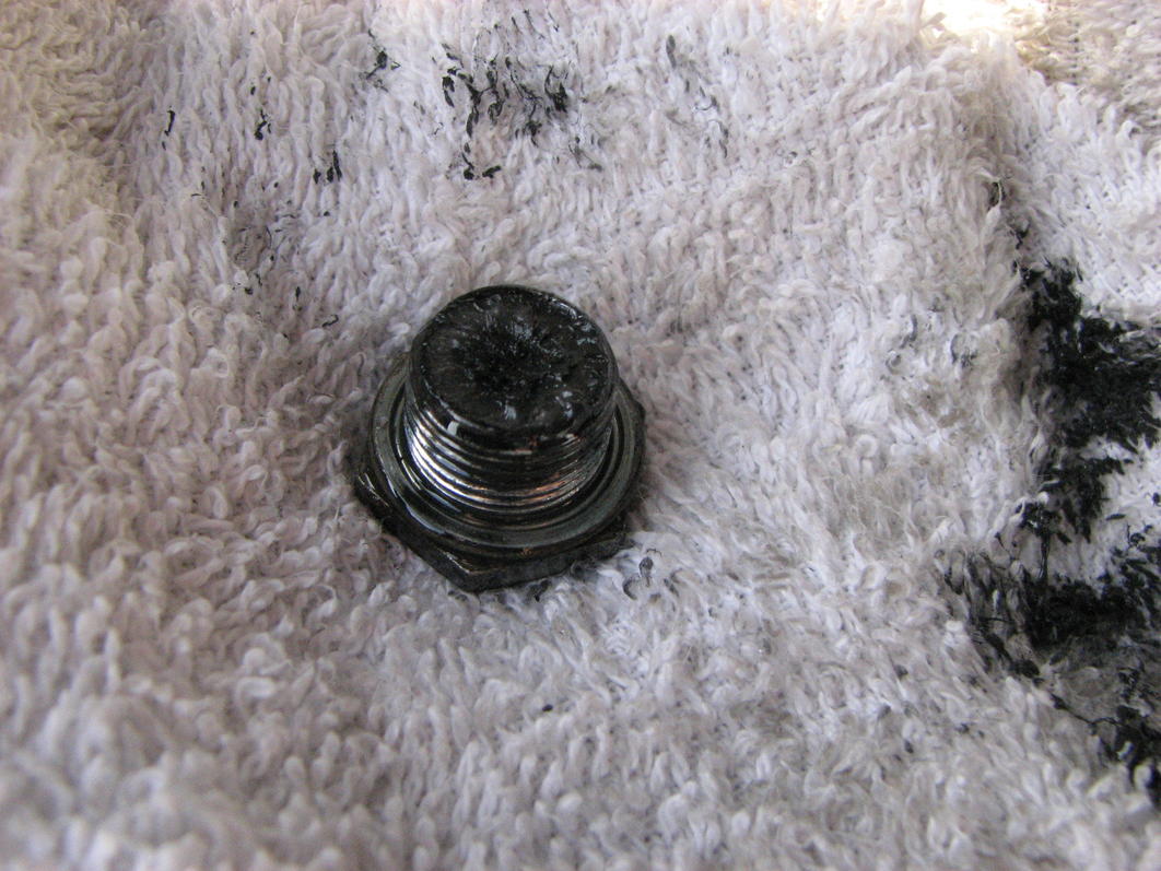

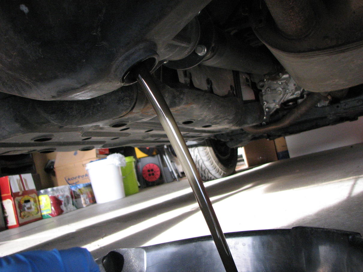

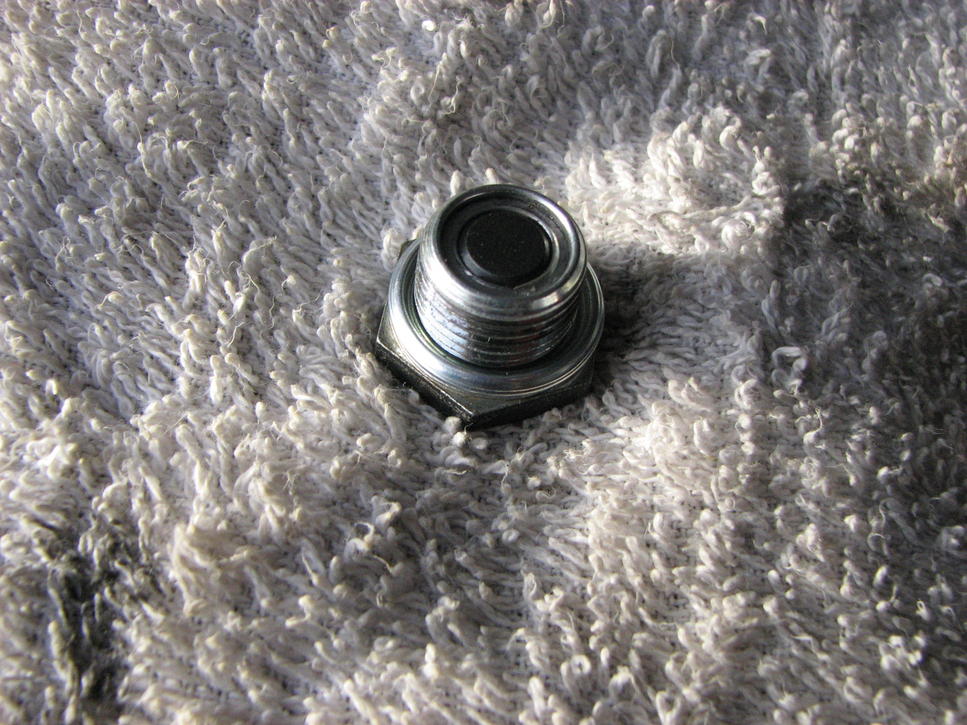

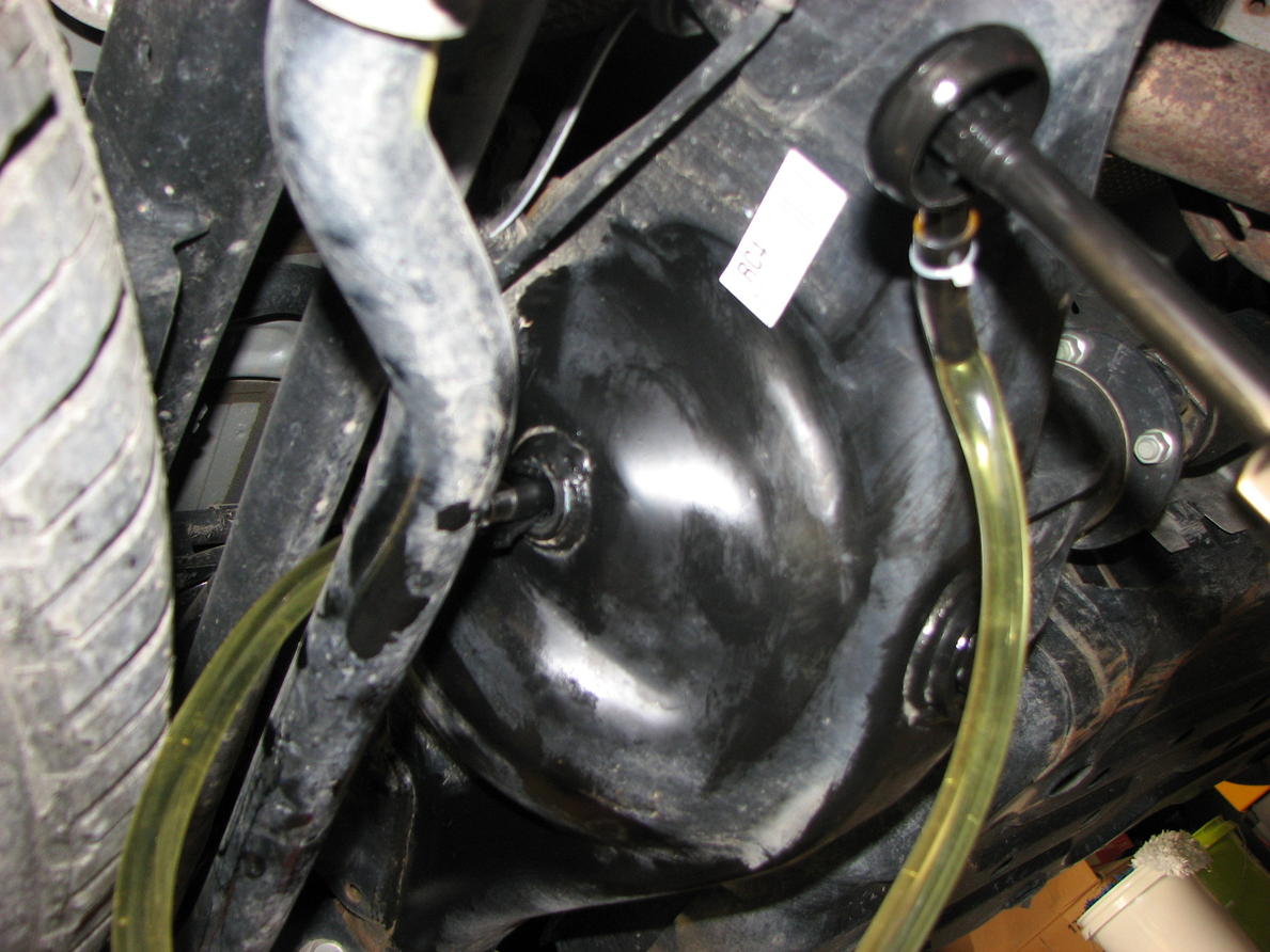

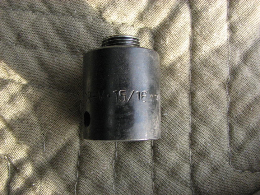

Changing the rear diff fluid is a piece of cake.
I've only got a few pointers...
Make sure you've got a big breaker bar and a 24mm socket. 24mm is not standard in most sets. Hint: a 15/16" socket will work perfectly.
That's exactly how my fluid/plug looked. Nice pics!
Thanks. Couple things I forgot to mention:
I warmed up the oil a little bit with a quick freeway drive.
When releasing the filler bolt there was a bit of air pressure which might be surprising.

Where can I find that hand pump you show in the pictures? That would sure make this job a little easier I think!
