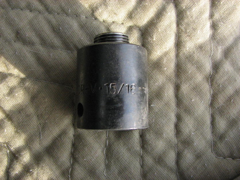

On the rear diff, use a 6 pt 24mm or 15/16 socket. A 12 pt socket will strip the plug.

Make sure you have a 10mm Allen wrench. I assumed I did because I have no less than 4 sets of allen wrenches lying around. BUT, (I'm sure I'm showing my naivety here) a 10mm wrench is bigger than what's included in any of those sets and I had to run to the hardware store after I dropped the front skid.
Also make sure you have a shallow 24mm socket. The one I got with my set (24mm was also larger than anything I had just laying around) was too tall/long to fit between the diff and the rear sway bar. Yep, I had to run to the store AGAIN. Haha.

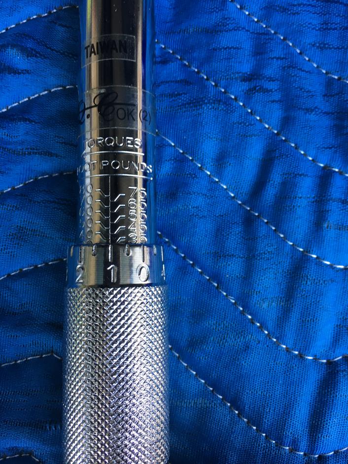

36ft·lb

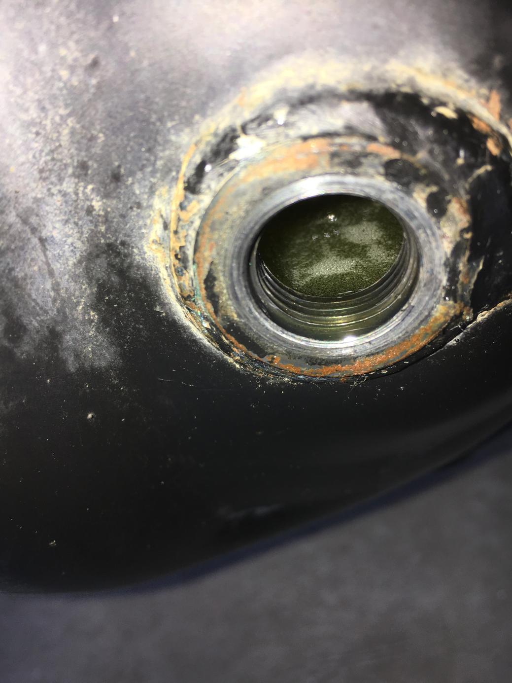

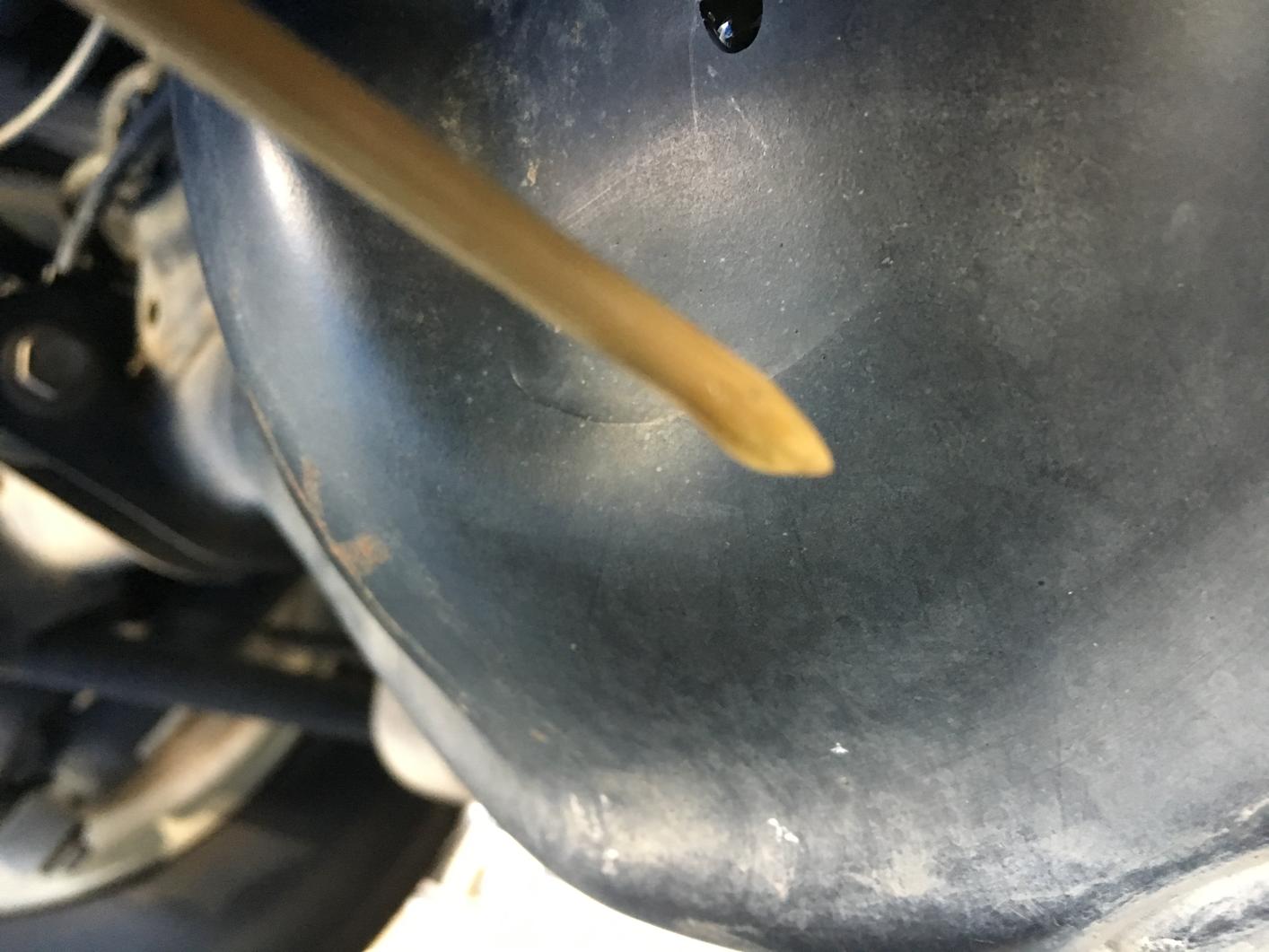

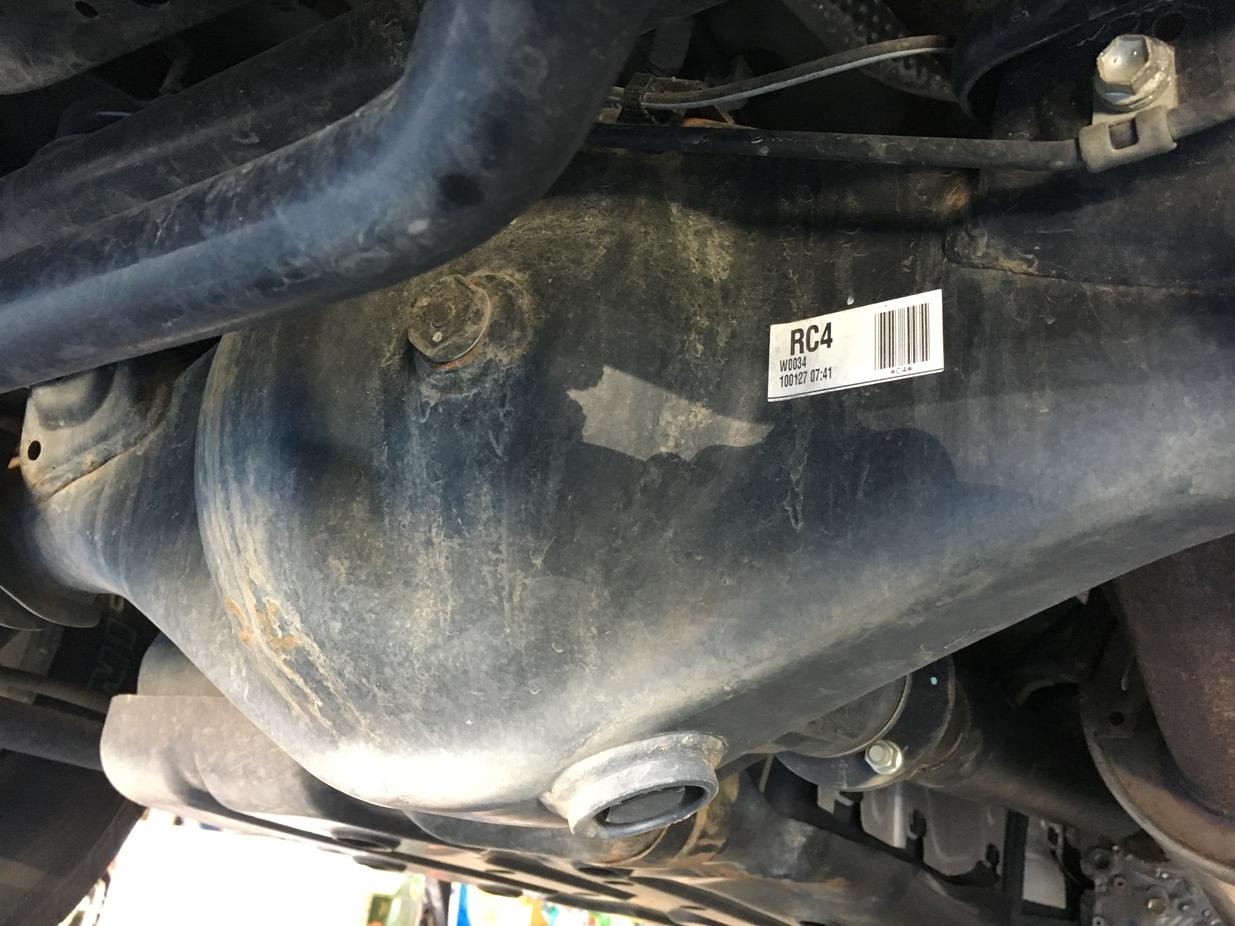

First checked for leaks then cleaned up around the bolts. Then pulled the filler bolt. It came undone easy with a tap of the palm on my big breaker bar. I forgot the dif gets pressurized so there's a hissing sound. I checked the level with a wood dowel and it's right where it should be. Fluid is very clean looking but I'm here so I might as well change it.

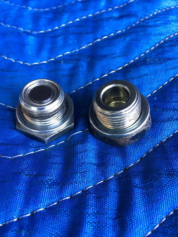

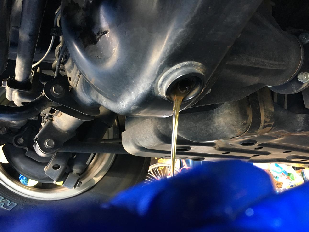

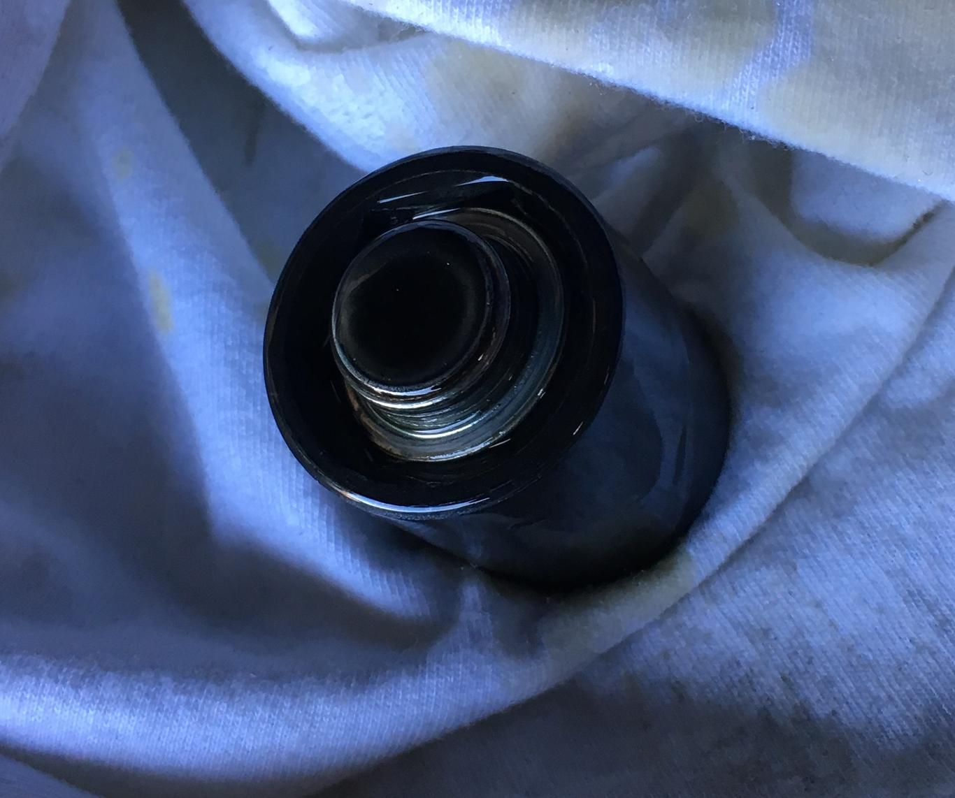

Drain bolt was easy to remove as well. Hardly any gunk on the magnet compared to the first change.
I cleaned up the bolts then replaced the washers. 15mins later and the fluid is still draining.

Fluid finally stopped dripping. Drain bolt was reinstalled and torqued to 36ft-lb.

I took a pic after three fillings and decided it was close enough to full. 0 to -5mm is the spec. Fill bolt reinstalled and torqued. Old oil will go to Walmart. Time for chorizo and eggs.

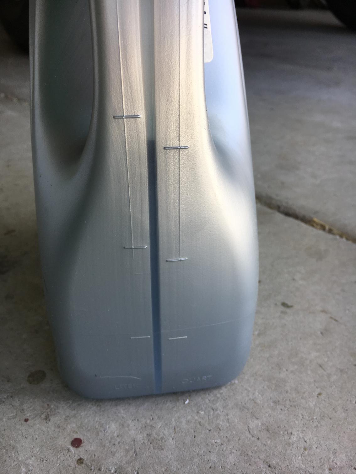

So, I thought I should inform everyone that Redline Oils is shortchanging their customers. 3 "quarts" of Redline 75w85 does not fill a rear diff on a 5th gen 4Runner. In fact, it took most of a 4th "quart" to do it, and after driving a few miles, it took 4 full Redline "quarts" to fill my rear diff.
I cannot remember the last time I was this upset about something, as it rendered my car inoperable for over a week while I made enough of a fuss to get the 4th quart overnighted to me for free.
I will never use a Redline product again, and will do everything I can to ruin their name. They are liars. Based on this experience, I am draining their fluid tomorrow and replacing it with something from someone who can at least be honest about the quantity of product sold.
