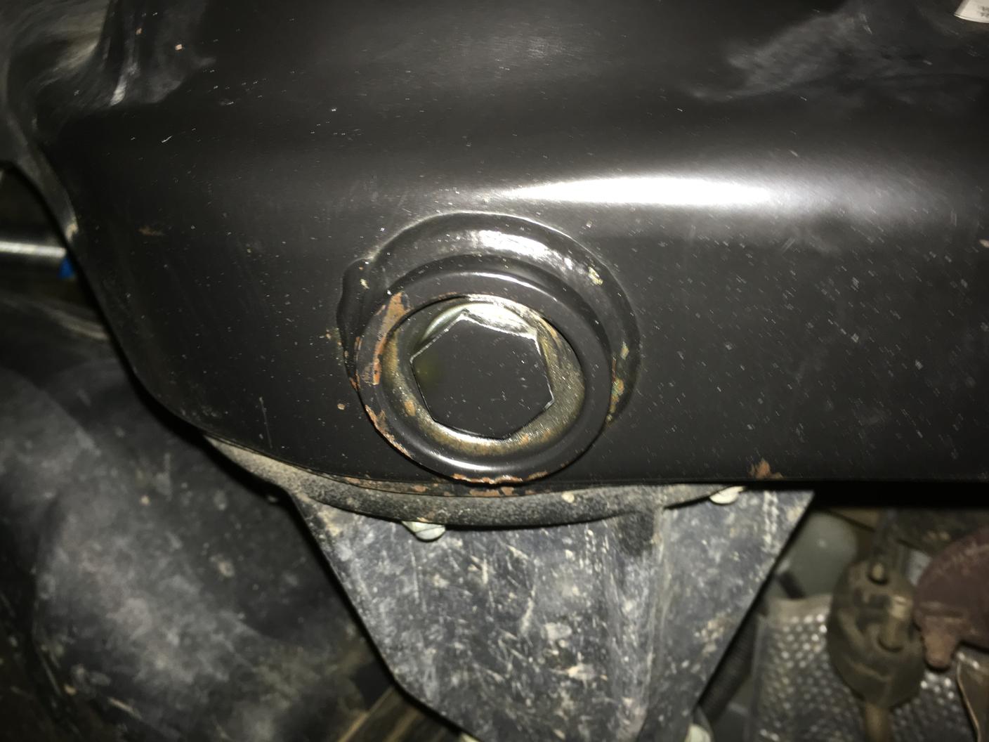

I've developed a leak around my drain plug that I've been watching on and off for several months. It looked like it was getting worse but I topped off with only about 8oz since my last change, about 10k miles ago. The good news is it's not coming from any other gasket or seal, I've got it isolated to the plug...hopefully. I added a few more ft-lbs when I re-torqued it a few days ago and haven't had any drips yet but they seem to appear after longer trips.
