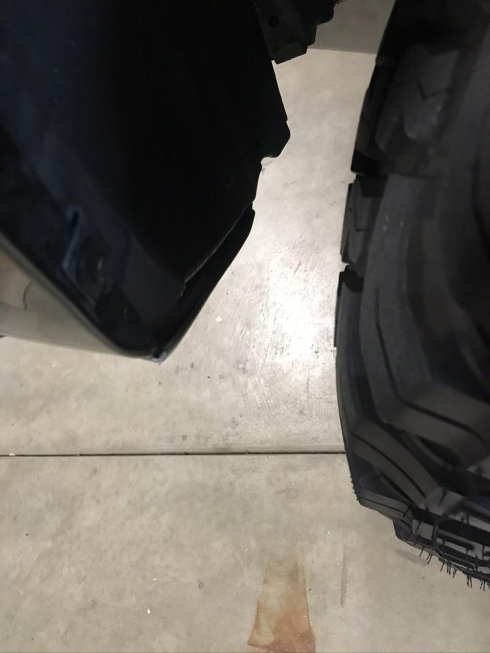

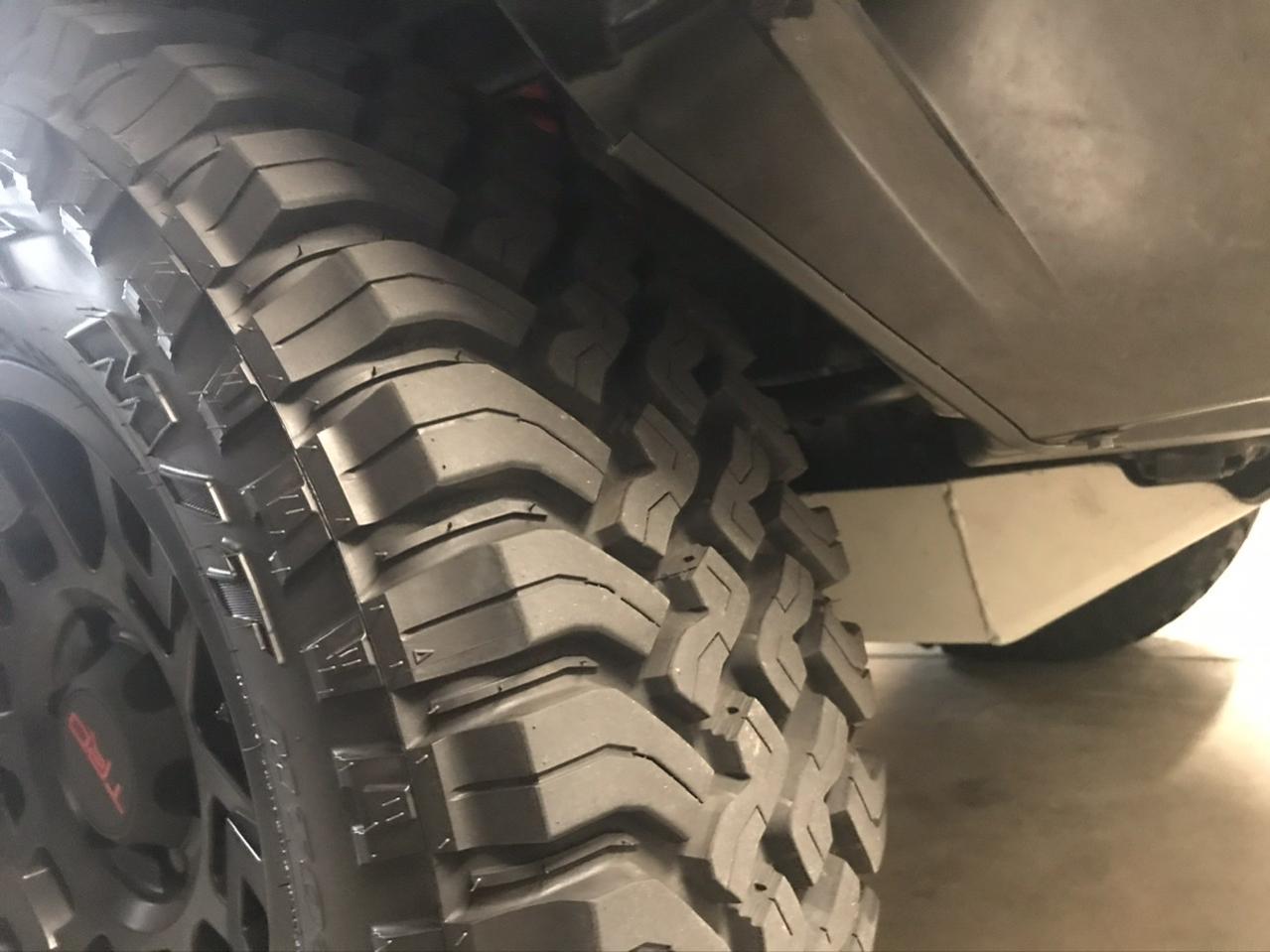

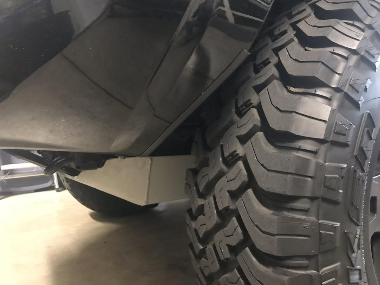

I’ve got 285/70/17 Falken Wildpeak M/T’s and trimmed the fender lip only and didn’t need to move the fender liner forward.
