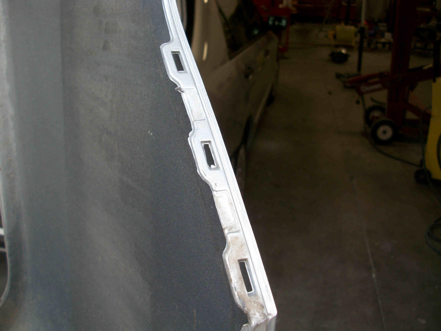

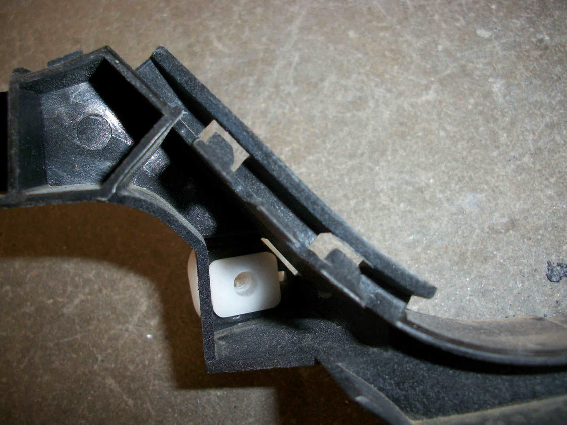

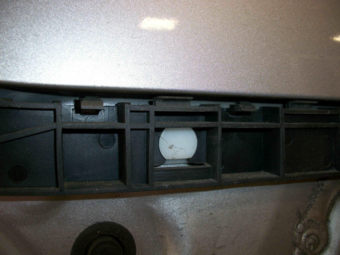

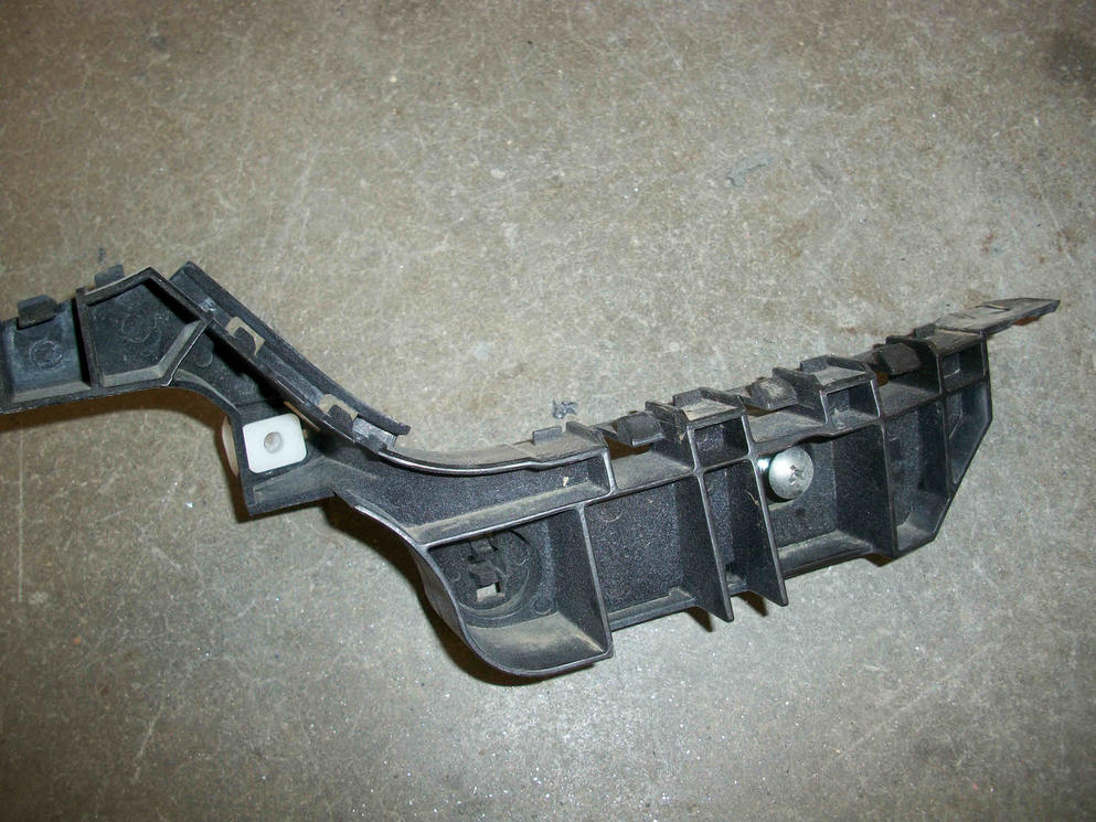

I went out & took some photos of this type of bracket & bumper cover mounting slots in order to show the details a little better. Please note, this is not photos of the 4Runner bracket but it is the same style so this should help in the understanding of how it works. You can see that there are the little fingers that fall into the slots of the bumper cover to hold it. Unfortunately because there are no bolts there is very limited you can do in order to adjust the bumper cover short of getting creative if you know what I mean. The first two photos are of the bracket itself off of the vehicle. The third is installed on the car and you can see that it basically sandwiches the plastic bumper cover to the lower edge of the fender. The last photo is of the bumper cover slots which are the ones you have to be careful not to tear. Hope this helps.
