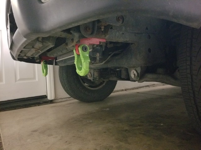

Reviving an old thread here. Has anyone ran into problems with the shackle hitting the front bumper mounting area before becoming parallel to the ground? I have a 2000 with a fat lip bumper.

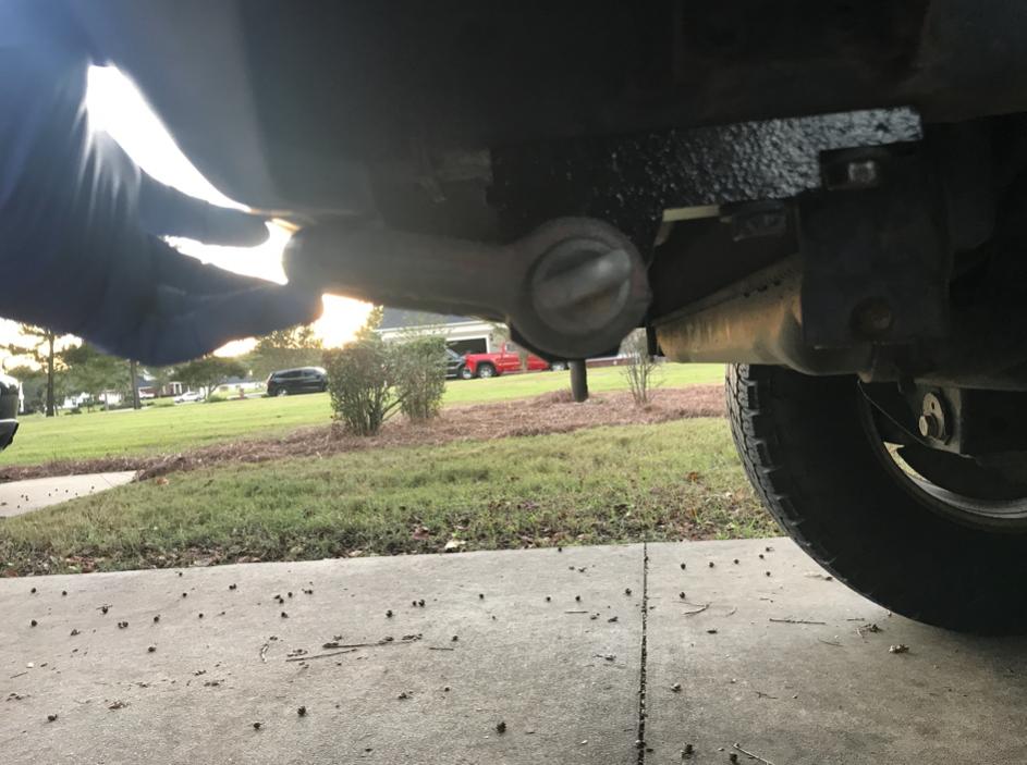

No, the mount itself fits fine. What I’m talking about is the shackle that goes through the hole. When at rest it hangs perpendicular to the ground, if you were going to use it however, when something pulls on the shackle it will want to be parallel to the ground but the front bumper mount is in the way of it going full parallel. I’ve emailed the shop owner but haven’t gotten a response yet.

I'm curious about this as well. I can see what he is talking about from the photo. I'm looking at getting a set of these for the front but I'm concerned about the issue shown here.

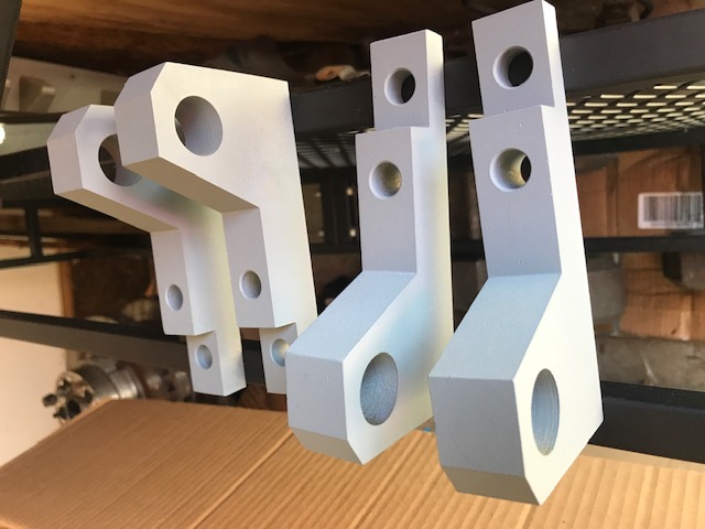

With this concern that you all have, I've made a new bracket that extends lower. This should clear perfectly. It mounts the same way as the original design, however just extends down another 1" and has a stronger backing (taper back to the mounting). This puts the mounting hole for the shackle lower adds strength with additional metal.

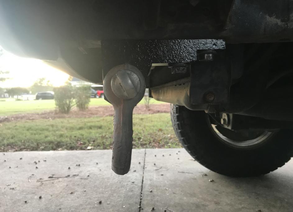

Here are some pictures of the new lower mounts. They clear fully and the shackle can be pulled up past horizontal. I've also taken a picture with the original design on the passenger side to show the difference. Pics below:

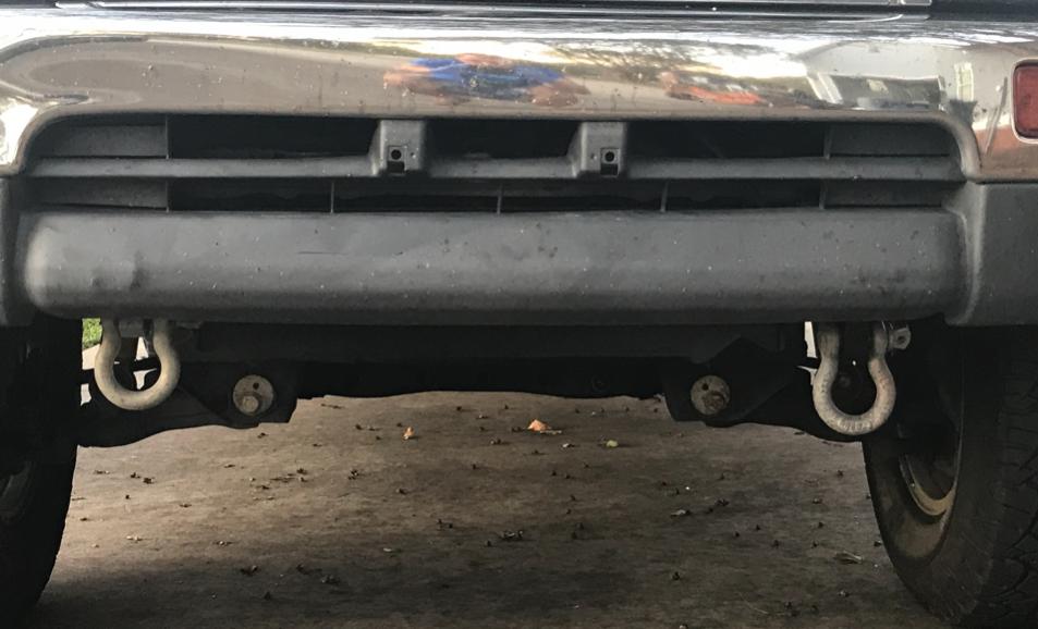

Nice update! It would be helpful to show that it clears with the 99-02 "fat lip" front bumper as well.

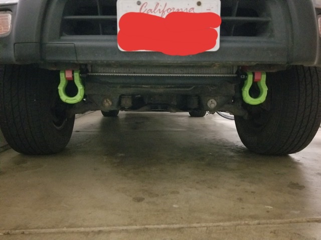

I’ve got some pictures from a 99+ front bumper. The new brackets hang lower and clear the front easily. I know a few wanted to see pictures of these.
