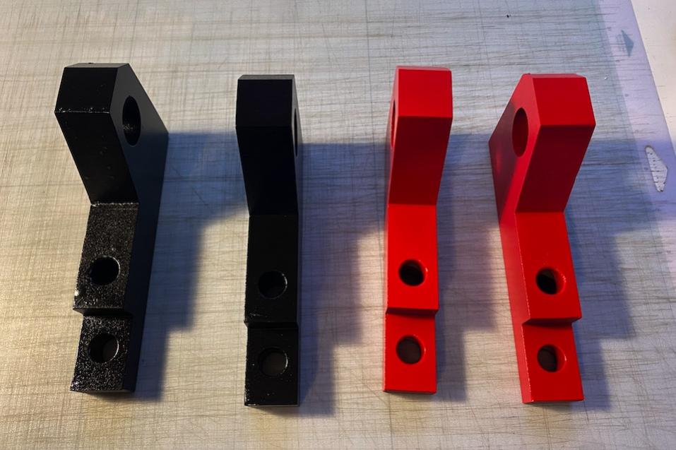

front D ring mounts
Sorry for not replying to these earlier. I've had several orders and have two sets fabricated earlier today to go out this week after paint.
The bolts are 12mm x 1.5
the short ones are 35mm the long ones are 65 mm.
[MENTION=24804]legokcen[/MENTION] I'd like to order a set of the "lower brackets" for my fat lip '00. Just checking to make sure you're still making these (and find out lead times) before I place an order at Trackdecal.com - Road Course Decals and Motorsports Graphics
Thanks!

I just had two orders, black and red, go out in time for Christmas. I won't be back home until after Christmas, but if anyone wants these for the New Year, they can definitely be made.
