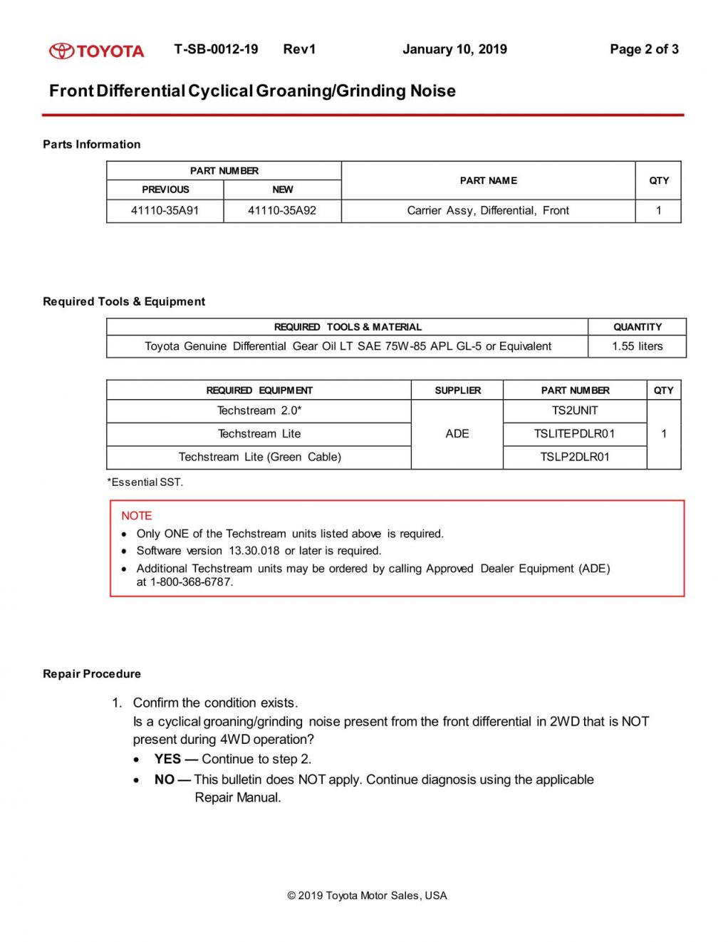

As I read it, a production change was made which could indicate the replacement diff is different
i would hope so ya know, not just throwing another faulty diff in. there is a new part number as you can which usually means there was an update or a change in that part

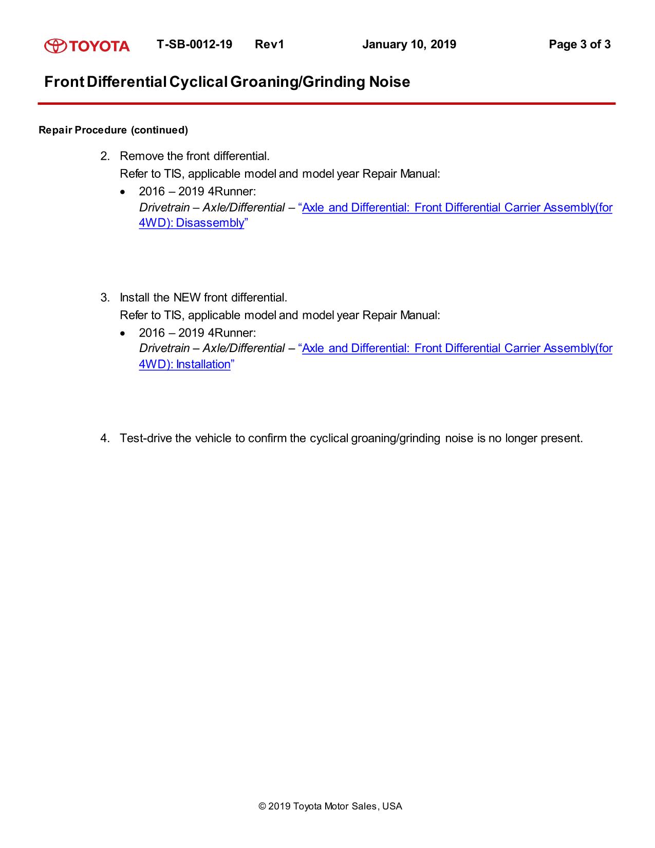

i got my front diff replaced and it feels so much smoother and quieter now
it also seems to have increased my fuel efficiency about 1mpg, I'm now back to about the same mpg as when it was still new. it had dropped from usually being around low 17.something when newish to about 15.7-16ish mpg before i replaced the diff at 59k miles. new tanks have been back in that 17.something range.

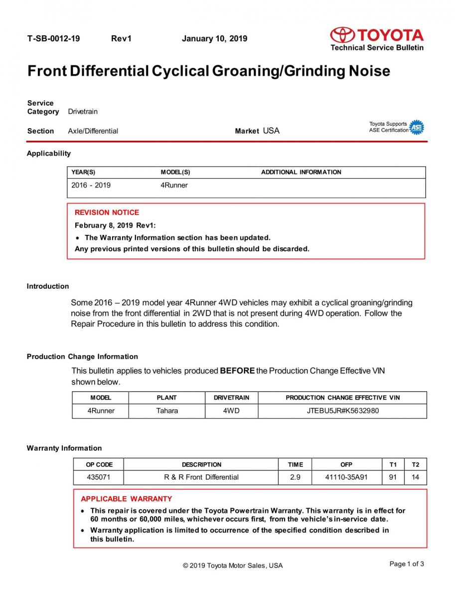

Here is a summary of the TSB that covers this off The NHTSA site
June 8, 2018 MANUFACTURER COMMUNICATION NUMBER: T-SB-0026-15_REV
Components: POWER TRAIN
NHTSA ID Number: 10142876
Manufacturer Communication Number: T-SB-0026-15_Rev
Summary
TSB: REVISION NOTICE June 8, 2018 Rev2: ? Applicability has been updated to exclude 2016 ? 2017 model year Tacoma vehicles.
? The Repair Procedure section has been updated. May 15, 2017 Rev1: ? Applicability has been updated to include 2016 ? 2017 model year Tacoma and 4Runner vehicles. ? The Introduction section has been updated. Any previous printed versions of this bulletin should be discarded. Some 2004 ? 2017 model year 4Runner vehicles, 2007 ? 2014 model year FJ Cruiser vehicles, and
2005 ? 2015 model year Tacoma vehicles equipped with part-time 4WD may exhibit a cyclical groaning or grinding noise coming from the front differential in 2WD that goes away when operated in 4WD. This noise can be addressed by replacing the needle bearing on the left side of the front differential. Refer to the Repair Procedure for needle bearing roller replacement instructions.
I see my year listed in the bulletin and it says this only pertains to 2WD mode. Could this be the same issue on a 2013 Limited w/ AWD?
The symptoms are almost identical to what I am hearing and my mechanic cannot hear what I am describing. He blamed the brake pads that he replaced a year before with higher quality pads for free but the noise still occurs.
Here is an update to the TSB that now replaces the Diff.
