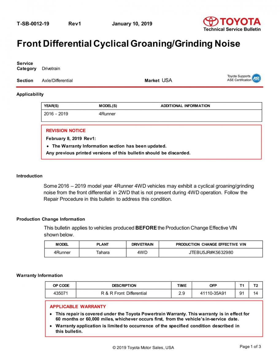

Thanks for posting this string - using the information I brought mine in referencing TSB 0026-15. Dealership ended up pointing me to a TSB #0012-19 and replaced the front differential. Hope this might be helpful.
I could not find the actual T-SB but saw info that indicates it is Rev 1 dated 7 Feb 2019
Date might be date posted on dealer site I saw it on. Can’t pull it up as I don’t have login access.
I just saw that TSB few minutes ago. The front diff is to be replaced, but it's on back order and might not get here until March.
Question remains, is the replacement diff any different/better.
Obviously the fix approach is different in that the diff is being replaced, not just the needle bearing

here ya go
