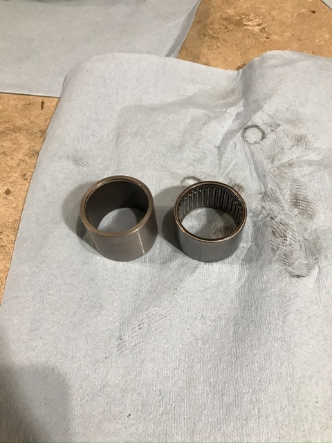

ECGS and never look back! I had the same problems you all did with vibration/grinding occurring in 2wd and went away in 4WD. My Toyota rep stated it was the needle bearing and they would replace it with another needle bearing. I elected not to have them replace the defective needle bearing with another needle bearing that would most likely fail in the future. Install took about 4-5 hours.
