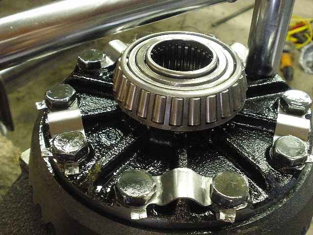

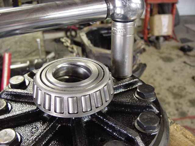

FWIW on the earlier IFS models, the ones with manual hubs had a machined carrier assembly that didn't even have a bushing. Just some oiling grooves in the machined carrier. So the bearing has existed (and been an issue) since literally the first IFS toyota built and they've never re-designed it.
Same year with the ADD is where the needle bearing came in:
