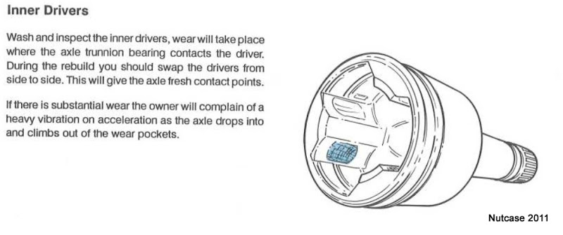

To share an experience, I too had the same play in my driver's inboard joint about a year and a half ago, and an occasional clunk. In addition, I had a vibration/grinding at low speeds...about 15-25 MPH that went away when I activated the 4 wheel drive. THAT was the tell-tale sign the needle bearing was worn. I went ahead and ordered/installed the sleeve and the install went as advertised (ECGS's YouTube videos are spot on). About a year and a half later, I still have some play in that inboard joint. It's not as bad as your video shows, but there's a bit. I also still have an occasional clunk. However, that may be from another emerging issue, worn inner drivers on the axle.
You didn't mention rebooting your inner joints, but if you do, take a look inside the driver and make sure the bearings aren't grinding a 'pit' into the metal, allowing them to bounce in/out of as you accelerate/decelerate. THAT would create a clunk (and possibly a vibration if they're bad enough). There's also TONS of threads out here discussing driveline clunk, so I won't discount that either; however, with 161K on the clock, those joints could be showing some signs of age.
