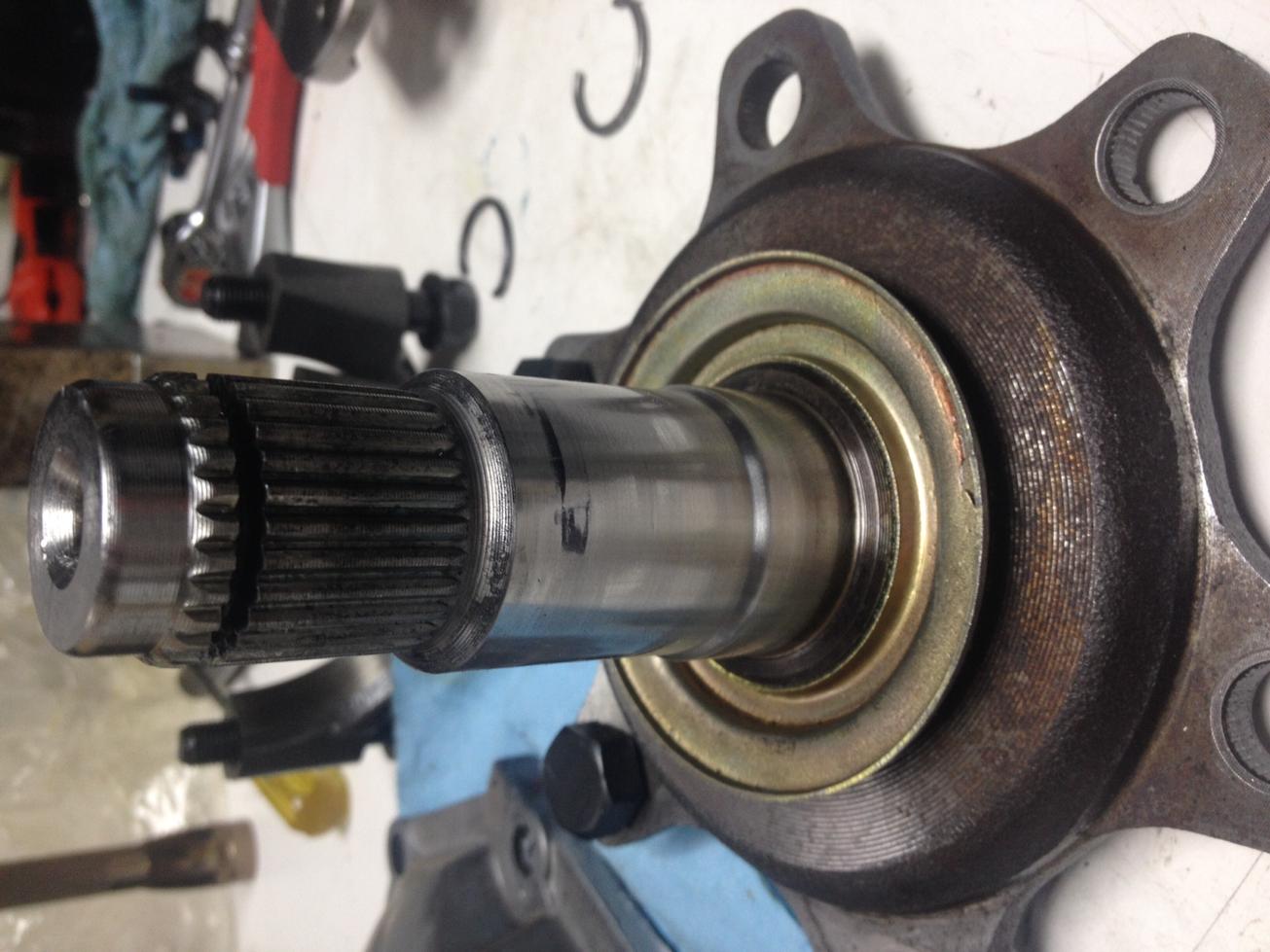

The stub shaft, or the CV shaft? They come apart, you know :). The CV is the one that's the b!tch to get out, and you get around that by pounding the studs out of the half shaft flange.
You can't get the stub shaft out without pulling the CV shaft first - if you pulled them both at the same time, you did it the hard way.
nonsense oh Vermicious One ! With the front ifs differential already out, the HALF SHAFT (what do you mean stub shaft ... half of the half shaft ?) is a one-clip piece of cake. There was interference with the lower A frame but 4 bolts drops the ball joint off the knuckle to get the A dropped just enough out of the way to pull the whole shaft inward. Oh I had to loosen the top of the shock too .
If in fact I had to do it with the diff installed, I would probably pull the knuckle off completely and take the shaft off outward, rather than dismantle the shaft in situ. But thats just me hating to roll around in a lube storm (cos the wife wont join me there ...)
show me your stub Ill show you mine
well I'm already basically done, , going to wait for seals and lower ball joints, I still dont know what zacly you mean stub shaft, but then I couldnt find an all purpose 19mm closed end 6pt ball peen hammer either,

Is this a hub or a sub?
Stub, and the picture is the passenger side on a non add

Thanks
Now I'm less confused by the slang. I have IFS / ADD, I think my vehicle does not have a stumpy shaft, so I left it alone!
