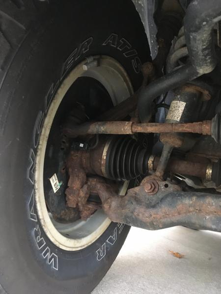

Hey all, got a huge scare (appropriate it happened on Halloween) when I was under the front swapping out driving light bulbs. I found this unbelievably rusted front skid plate. Truck is a 2013, with not even 40k miles yet. I live in the salt belt, so this isn't going to get any better.
My question is: is this component JUST a skid plate, or does it serve some other structural purpose? I'm also highly concerned with the amount of rust on the other front suspension components. Nothing on this appears to be future servicable due to the heavy rust. On a side note, my frame rails seem to be just fine.

To answer your question: At least on my 4th gen, it’s just a skid plate. It serves no structural purpose.
Years ago, mine was in very bad shape, and a mechanic just yanked it off by hand. One or two of the mounts were so rusty that the skid plate was just barely hanging on.

I just got this truck last year. Didn't realize the rust underneath, as the body was pristine to match the then 29k miles on it. I later found out the truck was in Canada until last year. It gets washed (incl. undercarriage) about 3-4 times a week. I've got an unlimited pass (complete with express lane) for a really good car wash.
I know the skid/cover plate can (and should) be replaced, that's a no-brainer. But I'm more concerned with the heavy rust to the other front-end components. Wondering if I should spend the $$ to basically rebuild the front suspension, it almost feels as though it would benefit from that. It's clear that nothing on the front end is going to come apart for eventual service, when the rust will be even worse.
... Wondering if I should spend the $$ to basically rebuild the front suspension, it almost feels as though it would benefit from that.
Other than visible rust, what are the suspension or steering symptoms you are experiencing? If none, than I wouldn't change the suspension parts. Mechanics in your area are familiar with rust and they can fix any rusty suspension part when it finally wears out. If fluid film is properly applied, it should penetrate existing rust and keep it from spreading.
