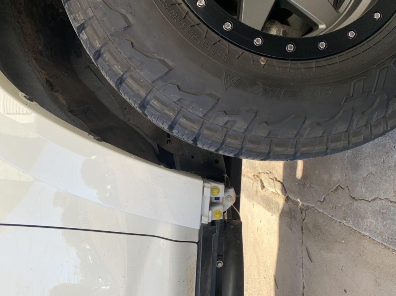

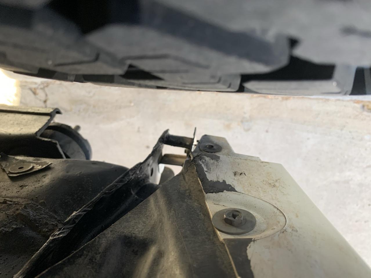

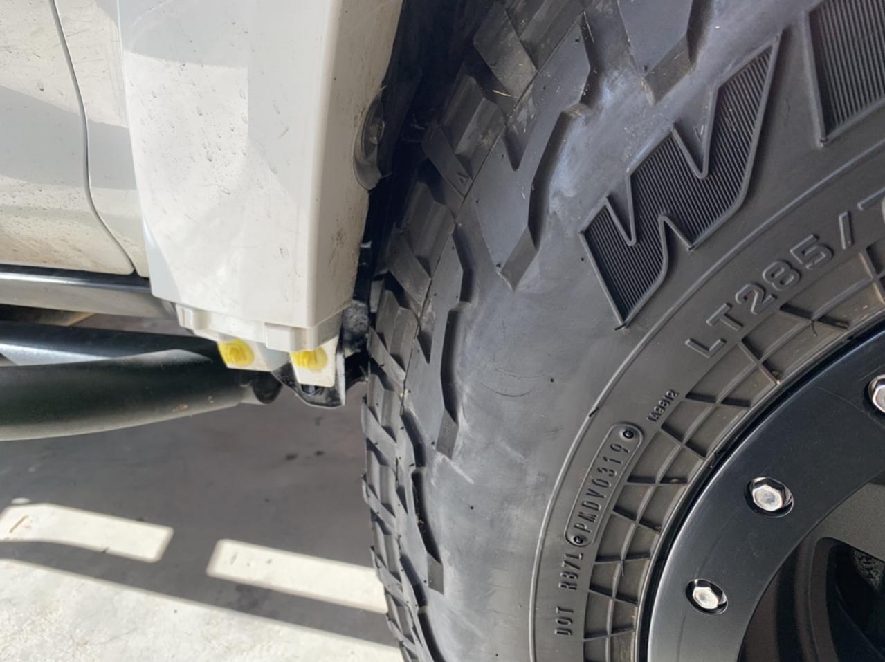

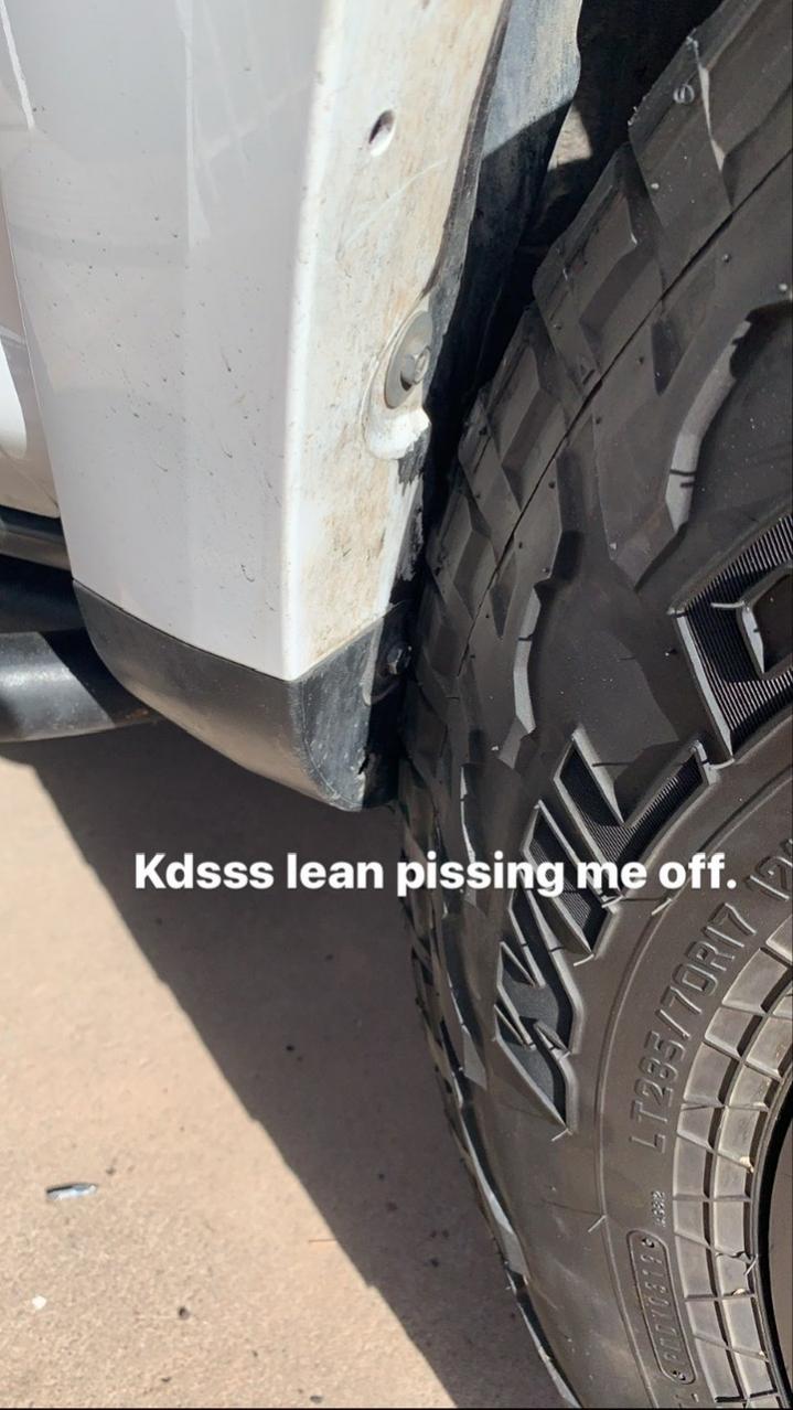

I have 33ish/34ish tires with an aggressive offset. Chopped out a lot of material today trying to get everything happy.
Seems like because of my kdss lean more material has had to come of the passenger side.
I’m potentially going to take out my fender mount under flex. I’ve had to remove the plastic corner cap because the tire makes contact with the only bolt securing it. At one point (prob a while back when I had wheel spacers for a few weeks) I hit that mount pretty good under flex and shook things loose in that corner.
I think people with big wheel setups chop this section? It “could” square off nicely. Just a matter of securing the bottom of the fender.
I figure I’m never going smaller then this tire and may go bigger so might as well get it done?

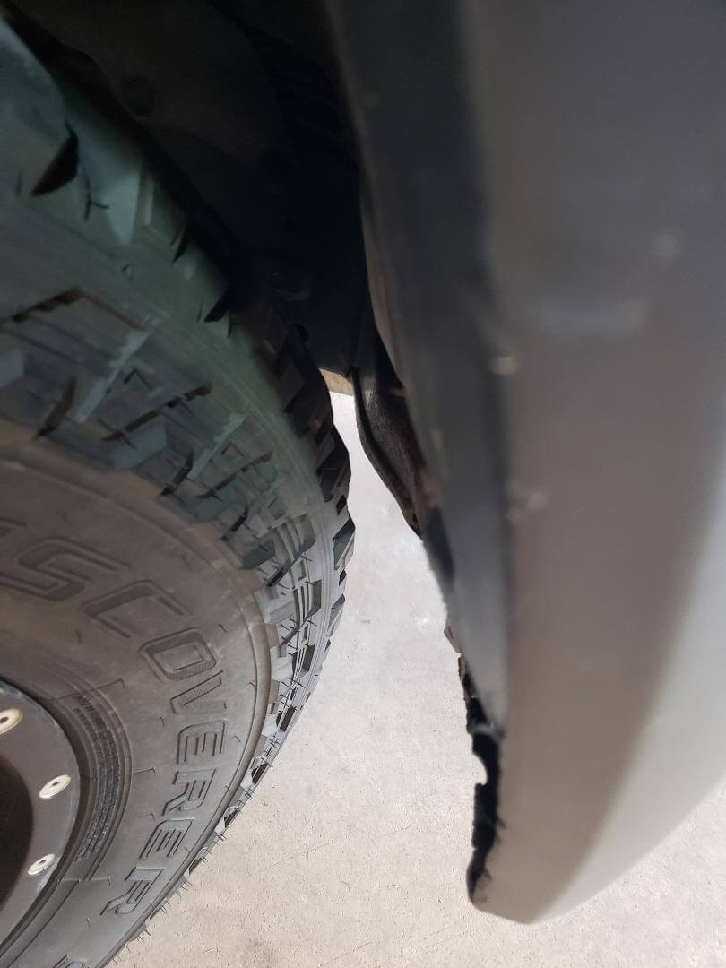

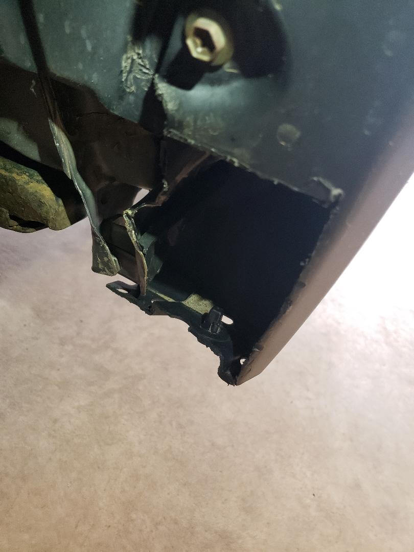

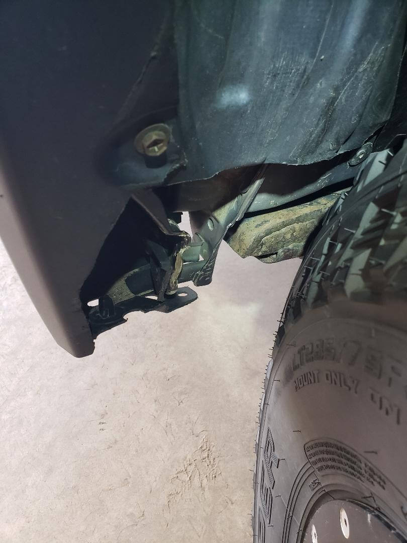

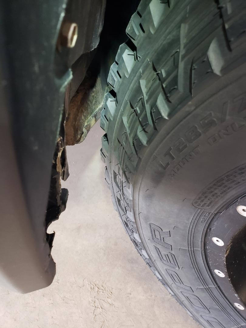

Yeah that looks pretty similar to mine. Although My tires don't that close to the outside part of the well. Probably our offsets are different maybe you have less caster? I run right around 5. I do have a zip tie on the passenger side cause the inside attachment point got chewed up
I attached a couple pics although none are while compressed.
Okay looks like I gotta trim a bit more. Thanks for sharing that.
Maybe not the whole mount. Wonder if anyone other then bushwhacker has some half decent overfenders.

I currently have SCS -10 offset wheels + 1.25'' Spidertrax spacers, which is very similar to the -38 offset you have. I'm also running 285-75-17 Toyo MT's, about 34.1''.
I LOVE the look/stance, but to this day, I am still removing my spacers before I hit the trails for the summer/fall seasons primarily, and at other random times if needed. Without the spacers, I clear off-road with the 34'' tires, no problem...Which is the reason I went with the -10 offset, so that I could remove the spacers, If I hadn't fixed the clearance issues, and still hit the trail.
With the spacers, I am still rubbing when the suspension is compressed, while turning, right there where you are.....the lower fender end-cap/plastic outer wheel well area. I've already cut & hammered some of the metal/lower pinch weld area, but I think I'm about to get a little more aggressive with it so that I can hopefully keep the spacers on full time...It also feels more stable to me with the wider stance, especially off-roading with the roof top tent.
If you hit that area hard enough, and enough times, you'll eventually knock your fenders out of alignment with the doors ect.
Aside from making sure you have max caster, that's about your only other option (more cutting)....aside from new fiberglass fenders ect.
I wouldn't worry so much about the KDSS lean, because it would rub in that same area, off-road with the suspension compressed, anyway. The trick is to clear with the full range of suspension travel, full lock to full lock.

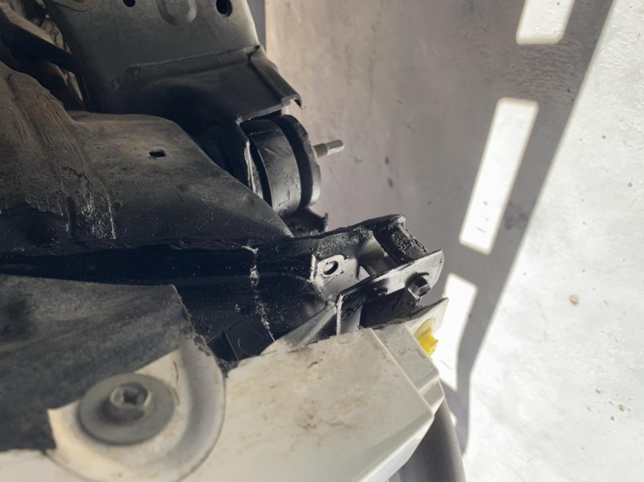

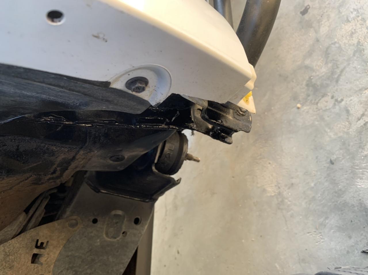

Working on it rn. Still made some awful sounds on the way to and from Ace to pickup cut off wheels for the Dremel.
Hopping this will work...

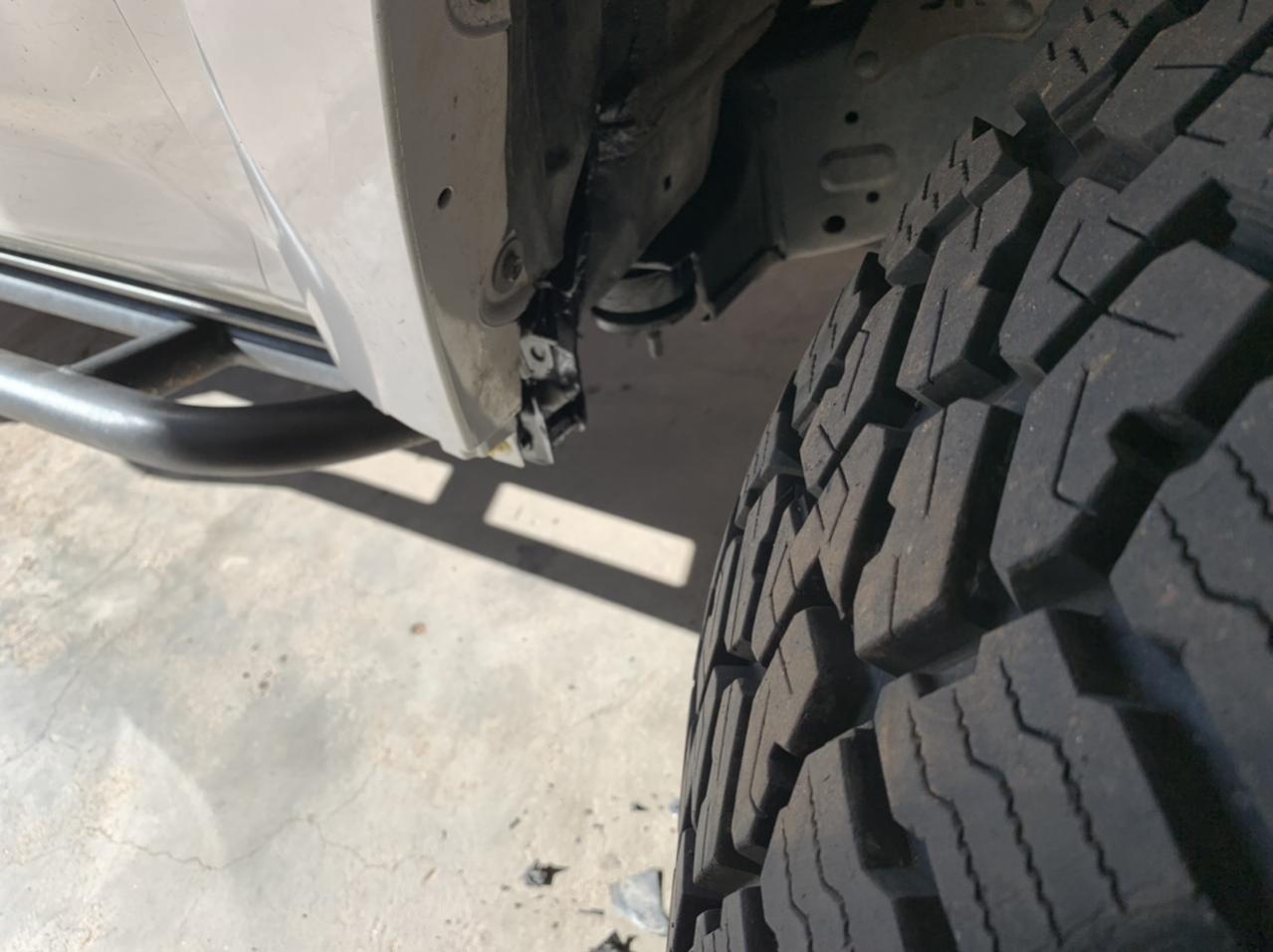

Drivers side I didn’t go as crazy on. We will see how it goes. Slowly but surely.
That’s it for working on it today.

Good luck, this can be a very frustrating process. I wasn't able to resolve my rubbing with 285/75's and 305/70's till I got the caster to 5*.
So your saying it's rubbing now even going over curbs?
It shouldn’t now I hope lol. Cut everything out with rub marks.
Truck could prob use an alignment anyways so will see about getting 5 degrees.
