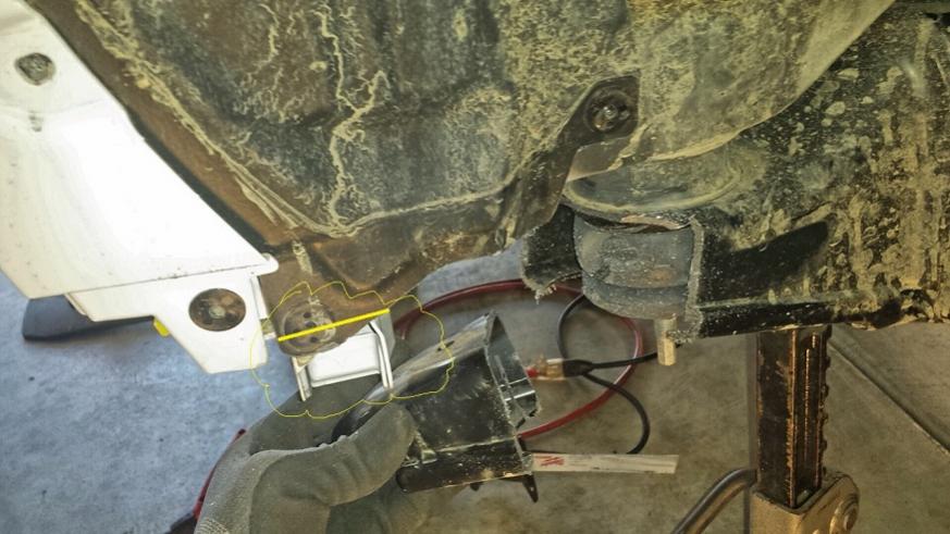

Front fender mount chop?
Cut it out. I did that a long time ago with the bottom of the fender flare as well. Had to use a self tapping screw to secure the bottom of the fender to the body afterwards, which was in a very nondescript location.

See that was my next thought too.
Just cut out the bs. Bend the fender tab and secure it.
I sure would like to see a pic of that.

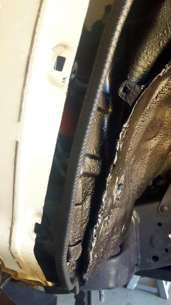

The first picture shows about where i cut it. The second, shows how it looked when I took an inch out of the fenders for the 315/75's

Nice man thanks for the input. I figure with these cuts I'm halfway to 35's.
Wow you cut out a ton. I'm definitely considering this.
Just for informations sake. The way it’s cut now I’m no longer rubbing on normal road conditions.
I’m still betting on rubbing under flex.
Planning on testing on it this weekend. Debating cutting more before going.
Still debating cutting the mounts off and securing the fender to the body. Need to take a better look back there, get my hands on the body/fender again, and think on it.
