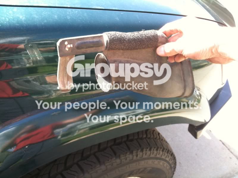

What is that pipe looking thing on the right side of this photo? I had my fender off this afternoon, and I do not have one of those.
My 2000 had that stupid choke tube on it. The inlet is small and I'm sure it restricts the performance.
