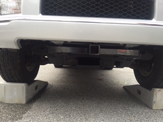

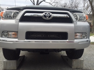

Hi folks.
I installed the Curt hitch for the 5th gen trail on my ’11 SR5. I didn’t want the one for the SR5 because it hurt my ground clearance. The one for the trail is high & tight! It’s a bit receeded which is fine for me as I’ll only use it for a front surf rod/cooler rack that has an extension & as a recovery point. I did need to remove the bottom front black plastic air dam & a couple other pieces of black plastic from underneath. It only required 4 bolts / attatchement points. It did take a bit of work to remove all of the screws and fasteners for the plastic that needed to be removed.
Here are pics.
