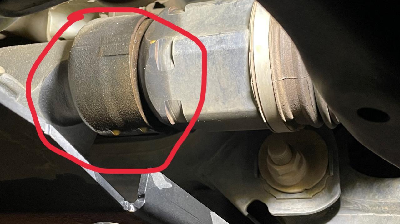

Hi all,
I was just doing some maintenance while looking under the truck when I noticed a dark are on the front skid and after closed inspection I believe I found the source of the leak, see attachment.
This is happening on the front passenger, the driver side looks fine. Can anyone help me identify what could cause this and which is the part leaking?
Thanks!

Make sure the front differential vent is venting. Otherwise as the gear oil heats up, pressure builds, and seals leak. It could also be the seal is leaking, even with the vent not plugged. It's a relatively easy seal to replace for a mechanic or skilled DIYer.
Should be this one. It'll be your front diff fluid leaking past the seal.
Had the same dripping experience a month or so later after I swapped my driver axle a year ago. Guess I damaged the seal putting the new one in. Had a shop change both seals for me since I needed other work at the time. No more leaking since.
Yours may just be wear and tear. All part of the maintenance.

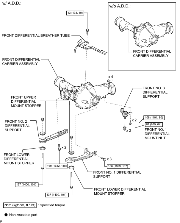

Thank you! Can you point out where I can find the front diff vent?
Vent tube bolts to the top of the front differential carrier assembly. The tube terminates with a vent as shown in this image. Go to YouTube and search "clean check differential breather Toyota". Front differential breather check or clean is similar to servicing a rear differential breather.
