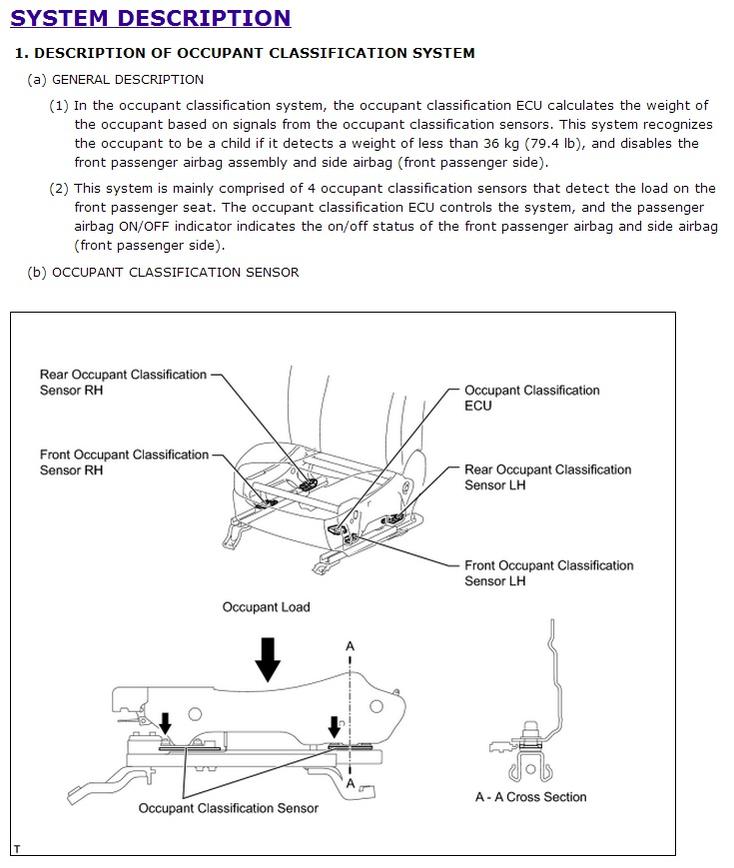

Hey Gary, are you sure the 66 lbs is the activation threshold and not just the weight where the sensors are suppose to zero themselves to? I was referring to this part of the FSM below, but your guess is as good as mine especially considering I am no where near 80 lbs to test this theory, lol.
You could be right as I never read that in the manual before .Just going by what techstream had with the 66 +/- 7 lbs to calibrate it and figured that was the threshold. Maybe I'll check it with some actual weights when I get a chance.
