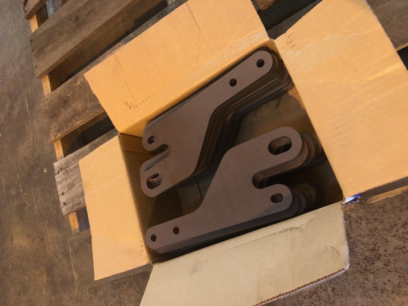

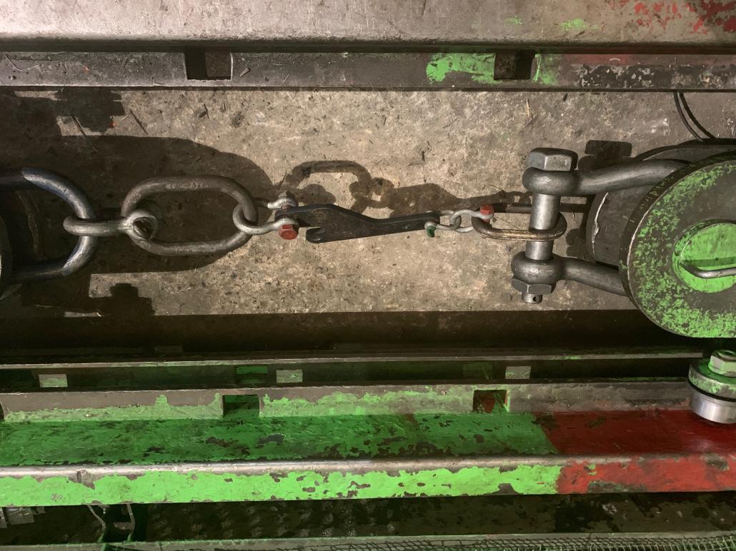

whew, almost 2 years later we're almost there. sorry for the lack of updates, this was put on the back burner..... again.
Final load testing on the production revision resulted in a shackle failure at 21000 lbs. We're listing these with a 10k WLL with a 2:1 safety factor.
They will sell as a pair in raw A572-50 steel, with class 10.9 hardware, and include shipping at $150.
I have the first 10 sets cut, i'm prepping hardware and will open up orders in the coming week.
