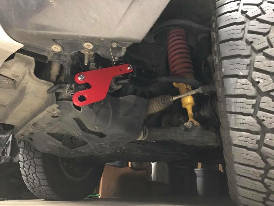

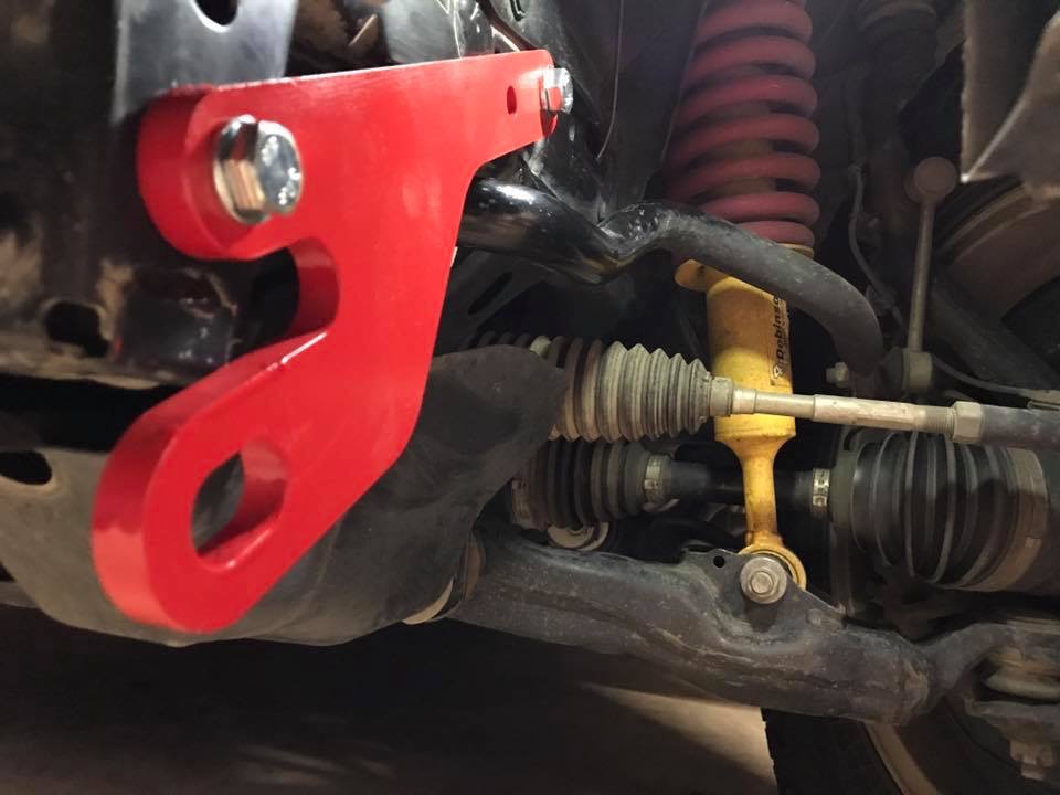

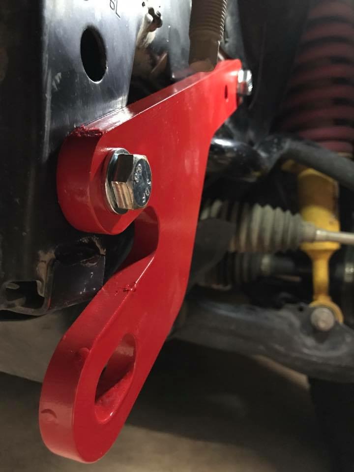

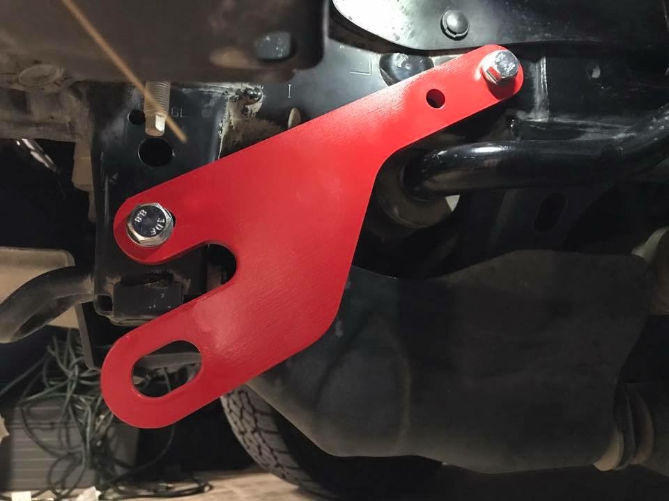

Thanks to Mark, we've got fitment confirmed on non-kdss 150 series trucks. I'm going to load test these guys one last time and i'll get pricing finalized.
